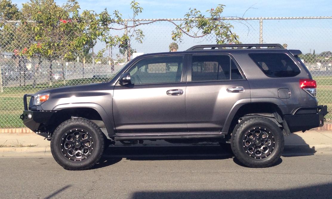

Here's mine with the Icon multi-rate springs installed, along with CBI rear bumper, full ARB drawers, fridge, etc. So far I'm a fan!
Looks sweet dude... how does the rear flex off road? Even though I have the Icon springs in hand, I'm wondering if they will give me that same amount of ridiculous flex in the rear that the MetalTech ET's give.
My rear flexes pretty great, but doesn't have as much droop as you do with the MT kit. Your shocks are longer to allow that droop. You need to talk to MT and see if the Icon springs are long enough to work in your setup, otherwise, the coil could fall out of the perch (but i doubt that would happen if you were running a rear sway bar...)
