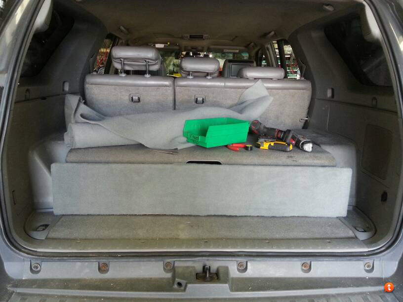

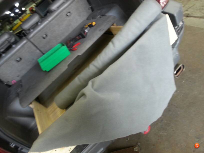

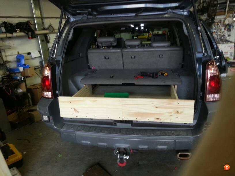

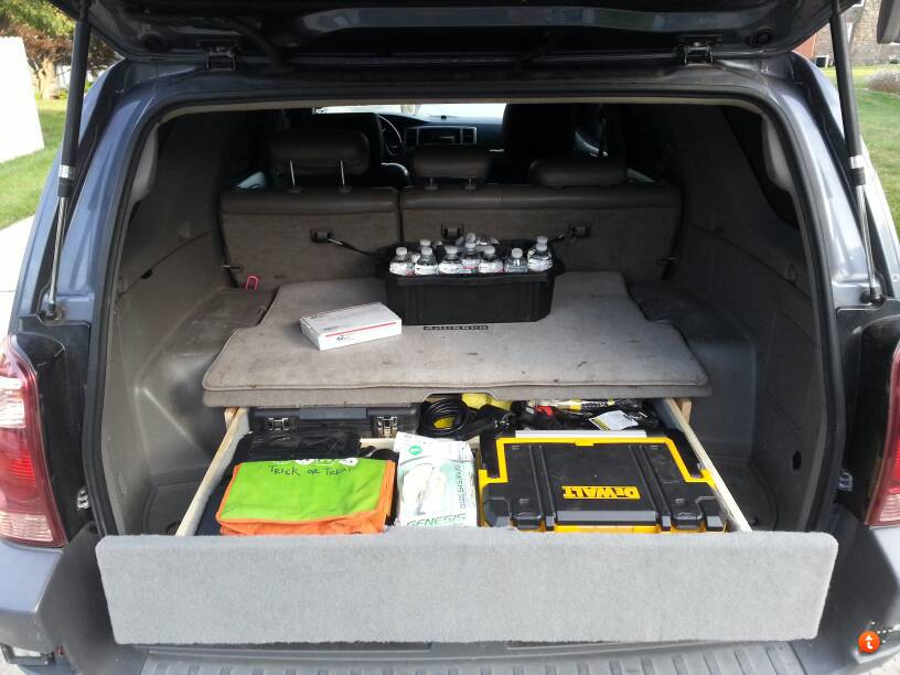

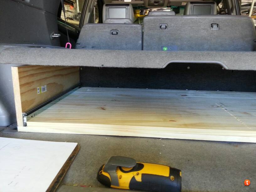

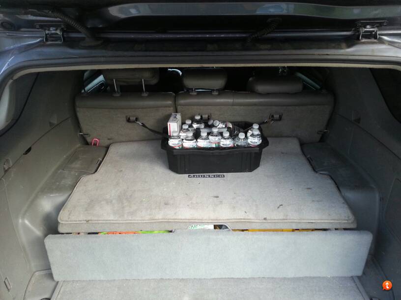

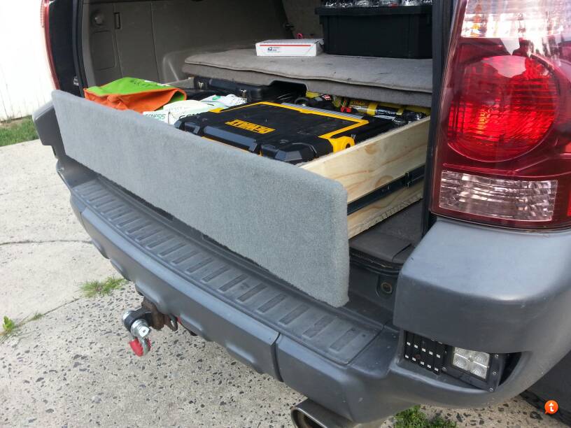

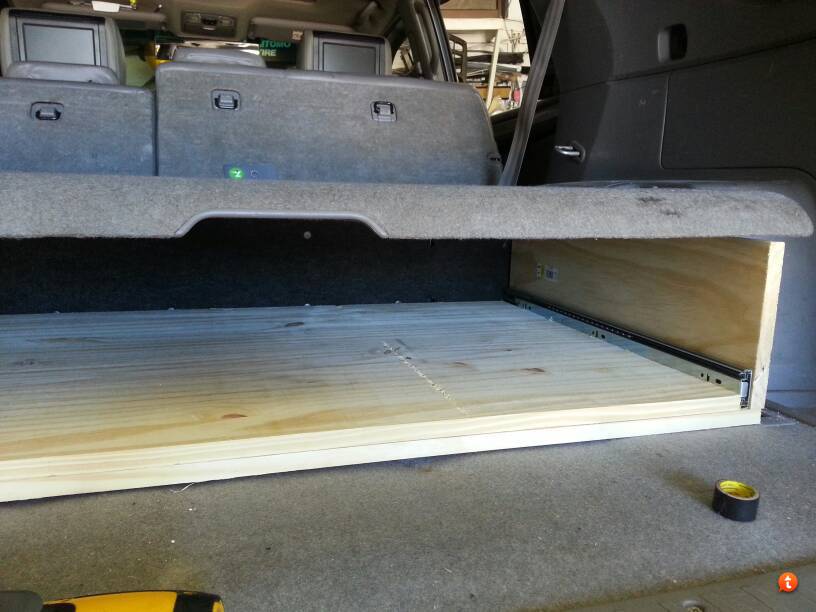

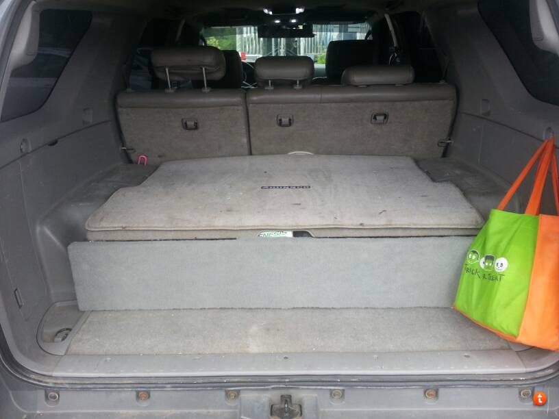

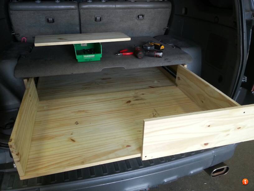

Thanks. Here is some more inspiration. ... woke up this past Saturday morning with nothing on the books, nothing planned, no honey do's, no birthday parties nothing. I said to myself at 645am I want to make my cargo box. 30 minutes later I'm at home Depot planning and buying wood and sliders. $155 and 3 hours later I was at my shop doing this.
Took 15 minutes of thinking and planning.
Saw some carpet on the shelf from another job I did

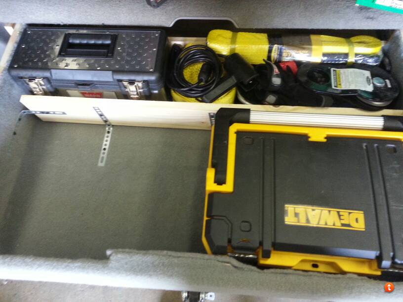

Is a match. Added sane carpet to the inside of the box. Made a divider out of some left over wood. Grabbed some radio back straps to make my brackets (I own a stereo shop so that's the materials I had on hand lol)

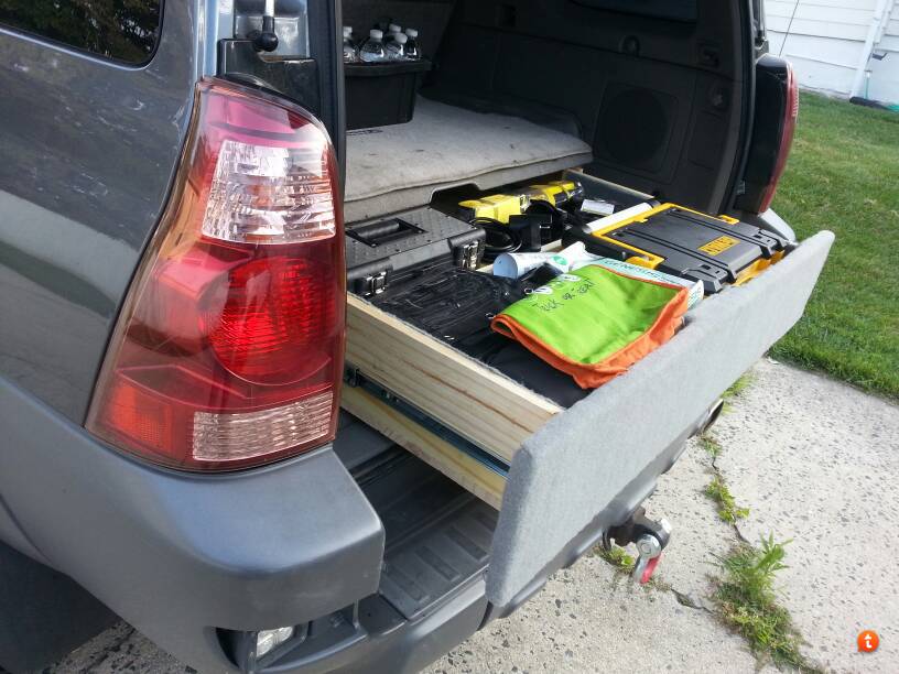

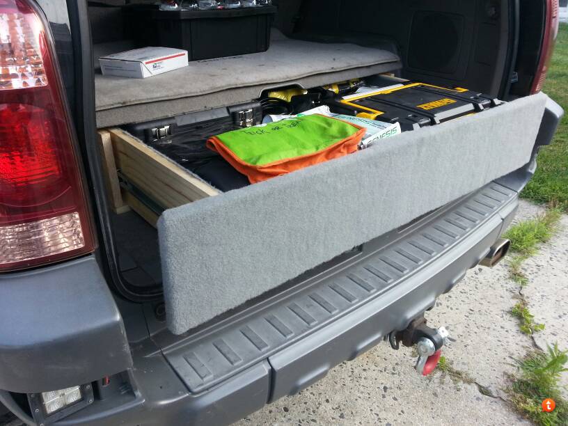

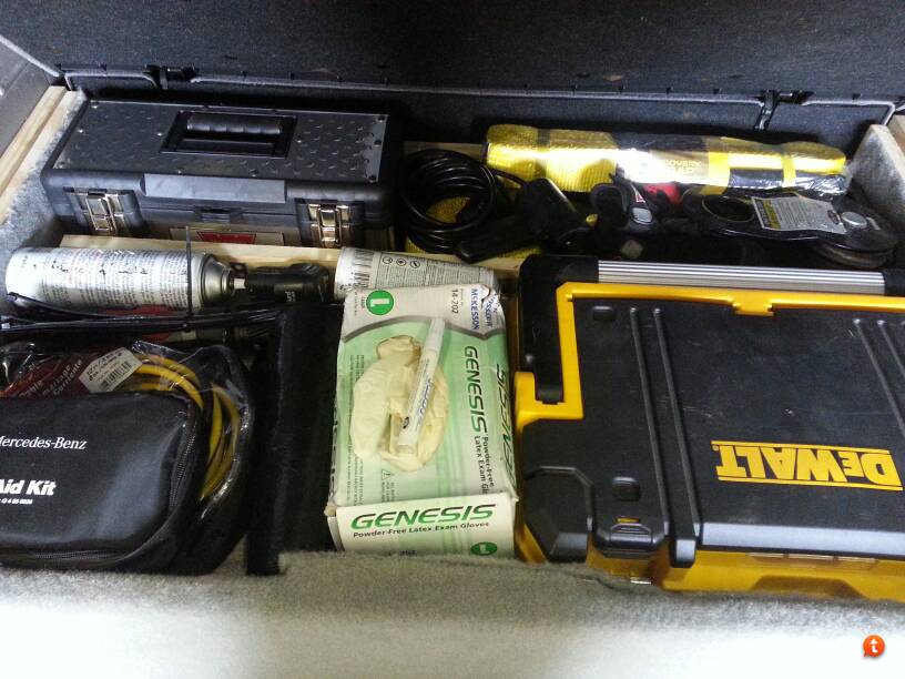

Recovery gear on the right rear, emergency first aid and basic survival box on the left rear. Most unused gear towards the back. Most used towards the front of the box. Tool box, towels, tarp, trash bags, rubber gloves, etc.

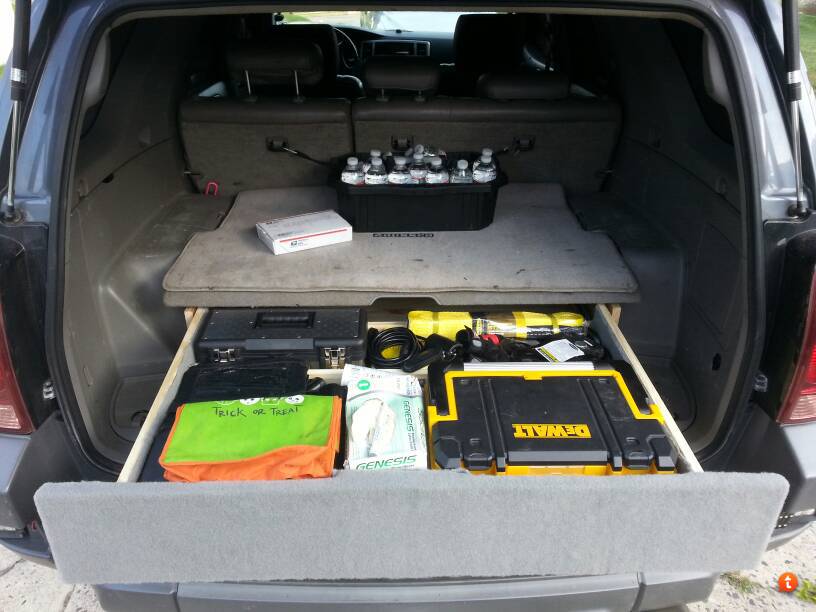

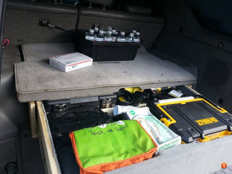

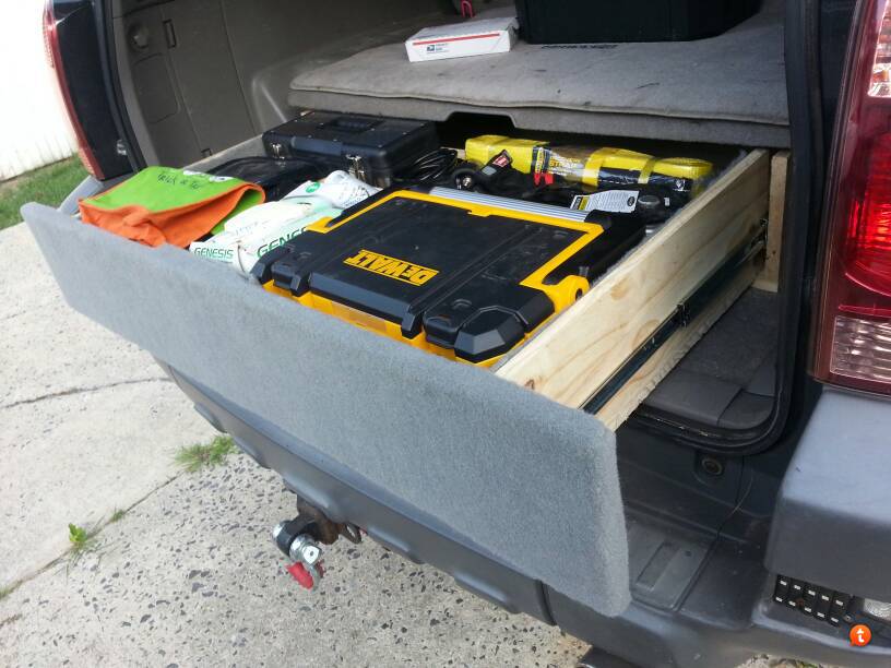

More shots of it opened and side shots.
Closed
2/3rd open
Fully opened
Closed back up.
3 hours later, mostly because I had no plan just a vision on what I wanted.
Total cost after returning $45 of extra wood and adding cost of spray glue and carpet, total spent on this project $125.
