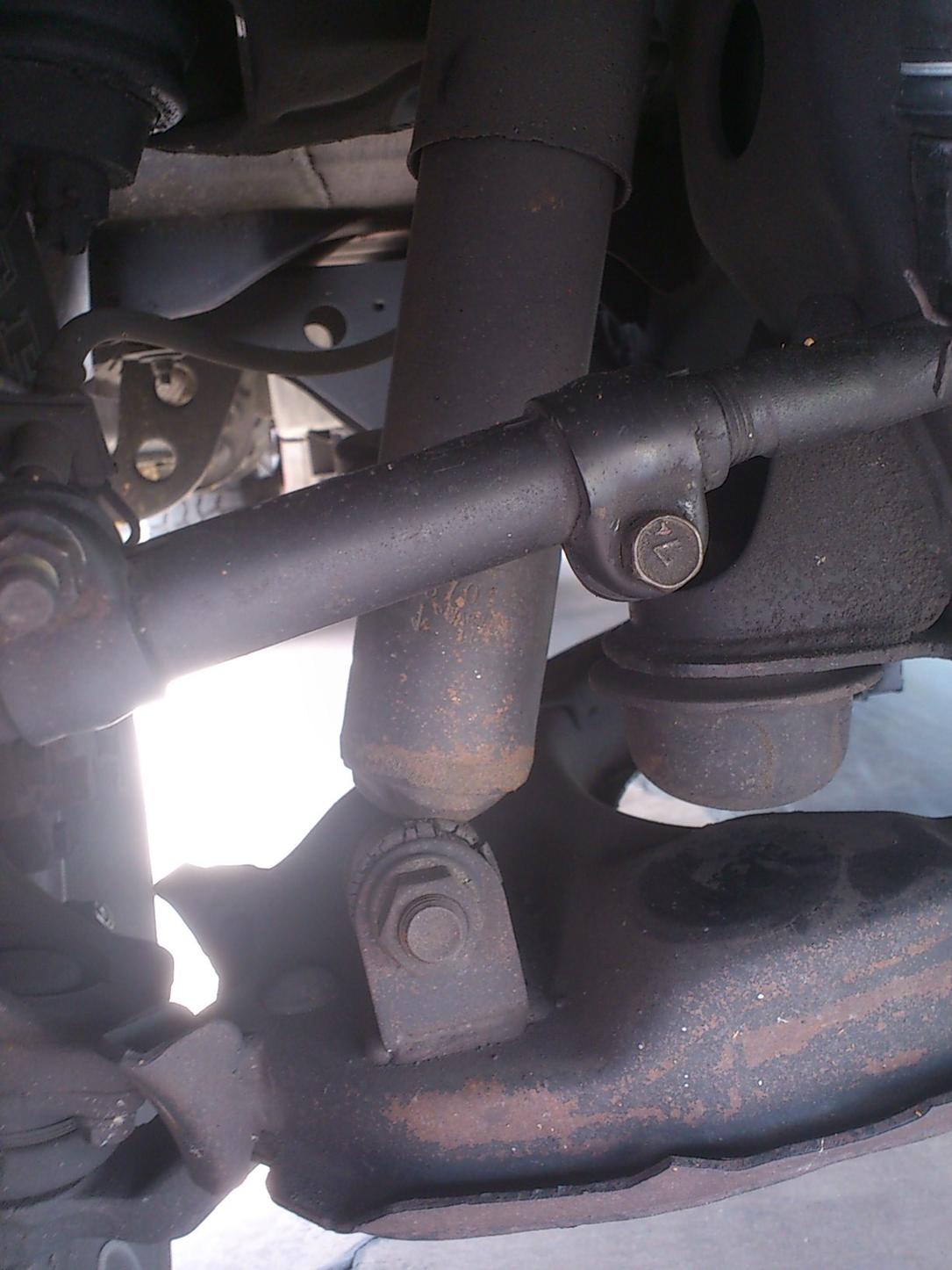

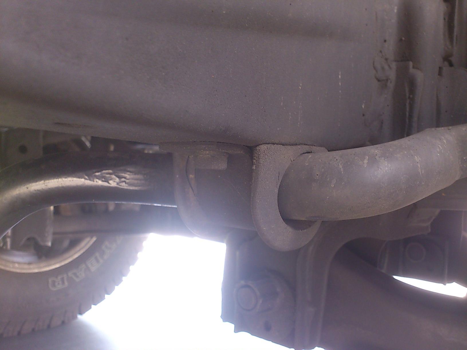

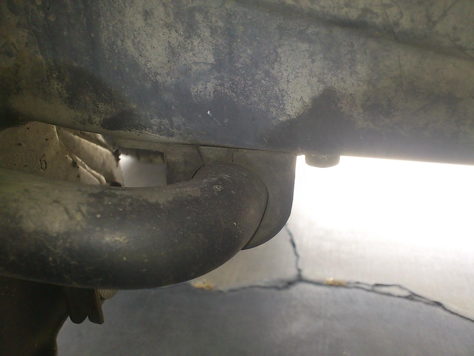

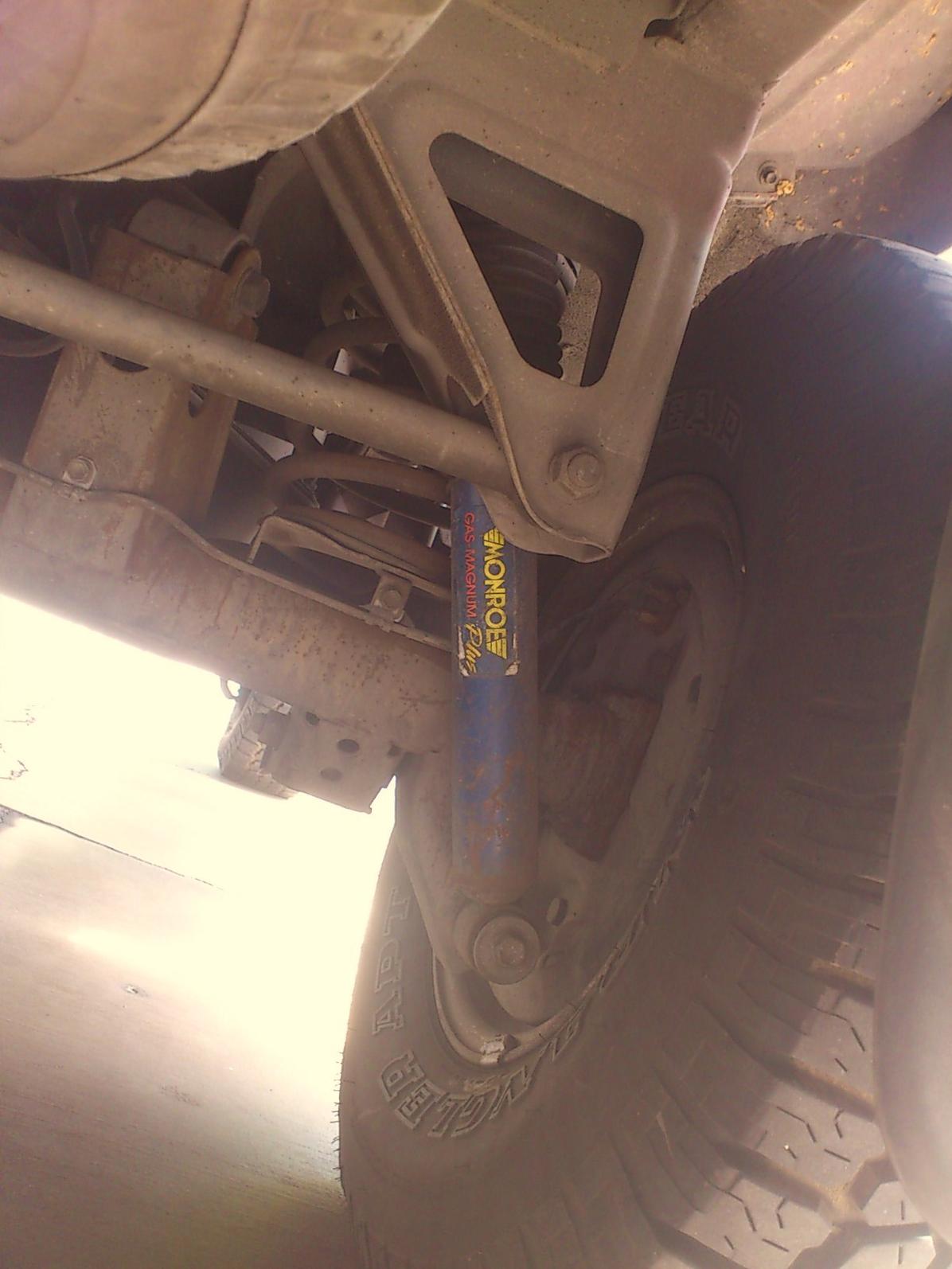

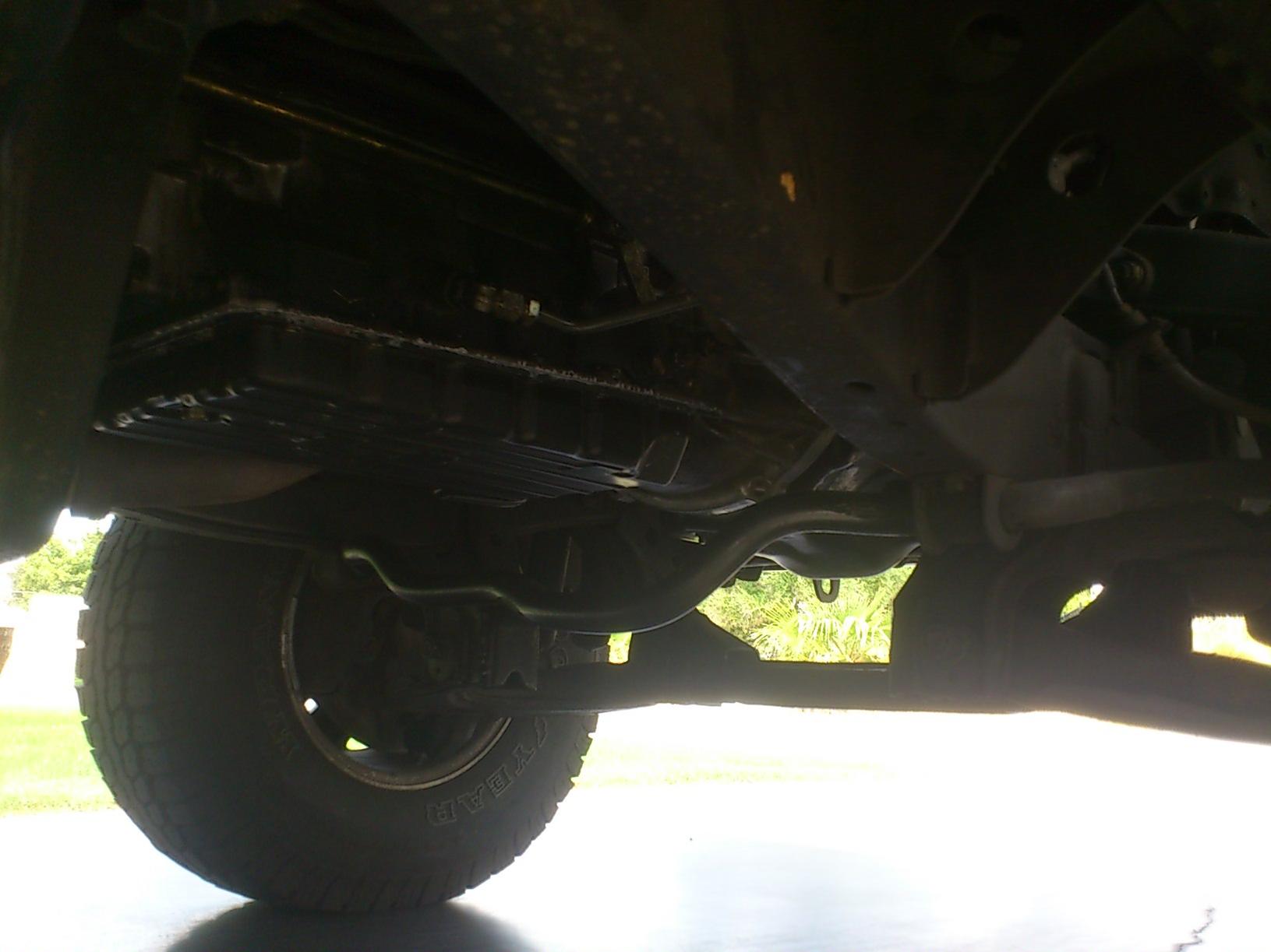

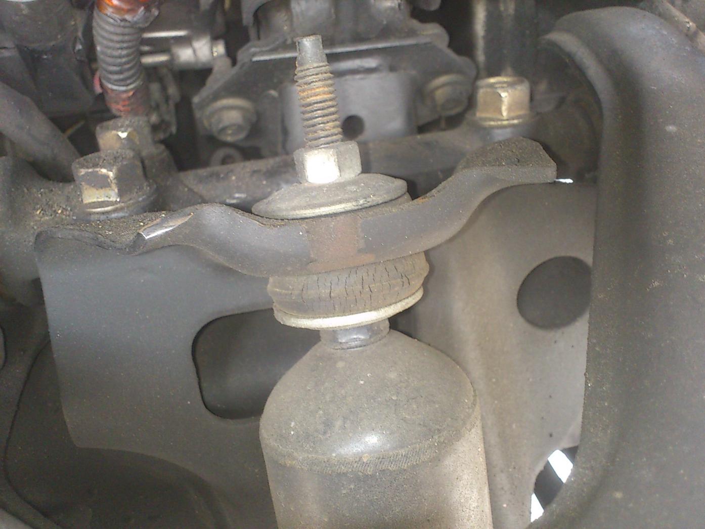

Some pictures... what do you guys think??
Thanks... even the interior is real clean as it was always kept garaged. Did you mean to take the running boards off for better off-roading??
To anyone else... any comments on if the timing belt removal is a straightforward process? Do my sway bar bushes and front shocks need to be replaced, and if so, any recommendations for shocks, and is it okay to buy bushes from Autozone, Pepboys, or Napa?
Yea. Looks factory... good condition. I have to believe those bushings are original. Change them and while down there you might see if there is another culprit. The play may just be that.. play caused by old components.
Looks great though! I love the Red, what mine was......

DC runner, yeah I will change those sway bar bushings. Should I pay extra and get the ones from Toyota, or ones from Napa are good?

From the pictures I know that the front shock bushings look like they need to be changed... how do I know if the front shocks need to be changed??
