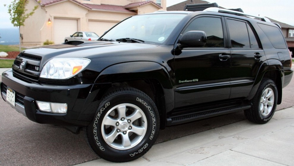

DAMN, I was not slamming the tire, I SAID I was a DD!!!!!!
Before Nitto's I got between 320-340 tank, mix of hwy/city driving after, 275, at least 2-3mpg less! As I said before it was not worth it to me being that My T4R was a DD . That being said, I thought the Nitto's were a very aggressive, sharp tire, just didn't fit my profile at the time. I went with a pair of goodyears w/ OWL.

Summit , the tires look good.

I could see this happening. Especially if you did not factor in the size difference. Nitto TG AT come in P and LT ratings. I'm sure the LT (if that's what was installed) is a few lbs heavier which would impact fuel economy. LT rated tires also require higher inflation pressures than similar sized P rated tires. Running an LT tire at the factory recommended psi for vehicles orig. equipped with P-rated tires will lead to poor fuel economy and potential overheating of the tire.
The GY SR-A's look like a good fit for your truck and usage. It will give you good mileage and ride and a little traction should you venture off the pavement every once in a while.
