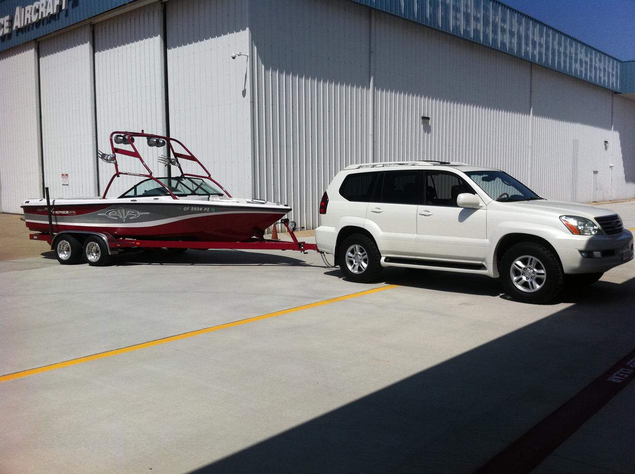

3. Has anyone towed anything major with a 5th gen? I have an Air Nautique that my GX pulls just fine but I have a 6500 rated distributing hitch and a V8. How is the 4R with towing?

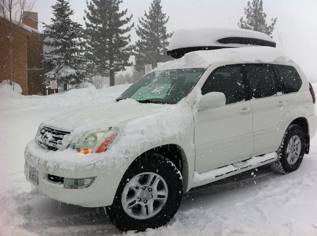

Here's Some photos of the GX having fun:

3: I doubt a 4runner will pull that boat very well. The towing capacity for a 2012 4Runner is 5,000 lbs. An Air Nautique 230 weighs 4,400lbs DRY without the trailer.

2 V-8s to choose from, larger wheelbase, 6 speed, adjustable suspension, 7,000# towing, etc. You could maybe tow that boat with a 4R, but you wouldn't be happy and neither would the 4R.
EDIT: Is this accurate? "An Air Nautique 230 weighs 4,400lbs DRY without the trailer". If so, with gear and people, you're outta the 4Rs league.
Of course you can pull that with your 4runner.
If this guy can pull his boat with an s2000 than I'm sure you can pull that boat with a 4runner. I bet it won't pull it as well as your GX does but it will get the job done.
My boat is 3500 lbs dry. So with gear, gas, and trailer, its right at the 5000 mark. i towed it with a 2002 3.4L tacoma a few times, and it was pretty sketchy, so I figured with the 4.0L I'm gaining almost 100HP it couldn't be too bad. Fortunately I don't tow it too far, only about 10 miles or so.
