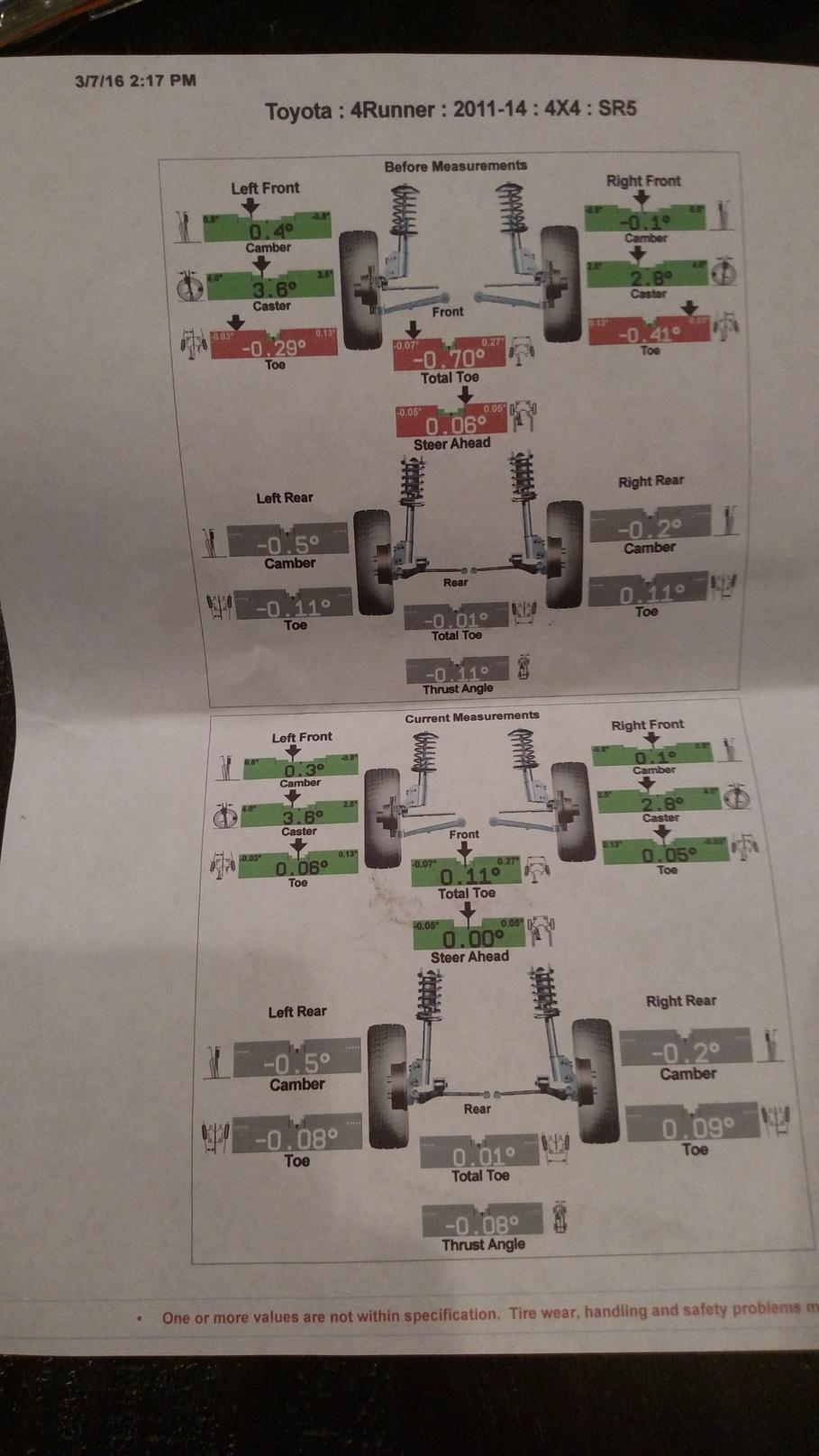

Hahaha! I found my Rokmen directions. They were with my alignment results. I'm not an alignment expert, but from what I read online about what the range is on the factory specs, I believe the shop I took it to got it within the factory specs. Here are some photos:
Anybody care to verify if my alignment results are correct?

Which spacer config did you go with? Should get mine installed in the next two weeks (been sitting in my garage for over a month now :-()
They're still on the standard position. I'm taking it back to the shop to see if they can adjust it some more. My 4runner feels unstable.
I would start in the +1 position for sure on a typical rig.
Do they tell you where to set the heim joints to start with. I'm curious how much those can be adjusted to gain negative camber bias without causing interference.
Typically, when You try to add caster via the LCA cam bolt adjustments, the camber starts going positive. By shortening the heims, you should be able to offset that a bit and get the wheels more forward and maintain good camber. (this will also add caster). I'm just not sure how much adjustment is in there.. Plus you might run into interference issues clearing the coil over at full droop if you pulled them in too much. It is a surprisingly complicated equation...

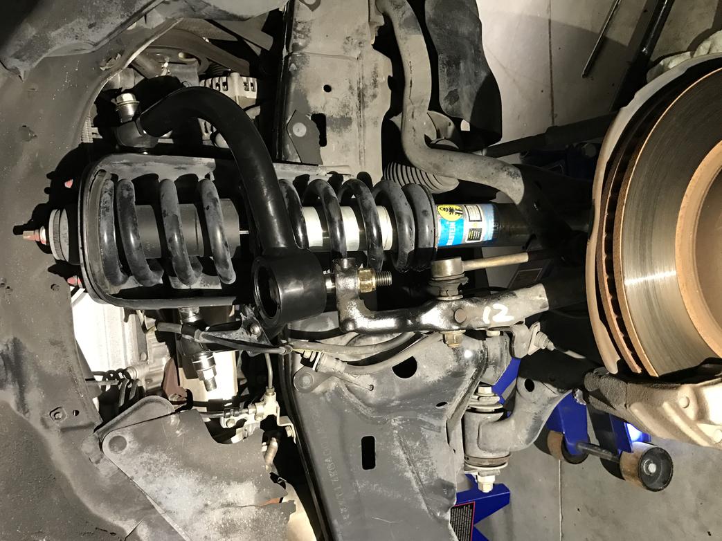

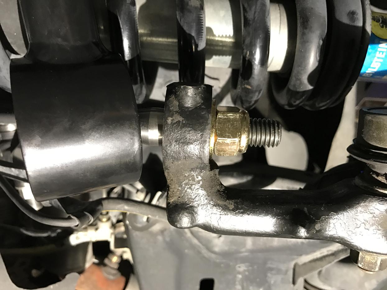

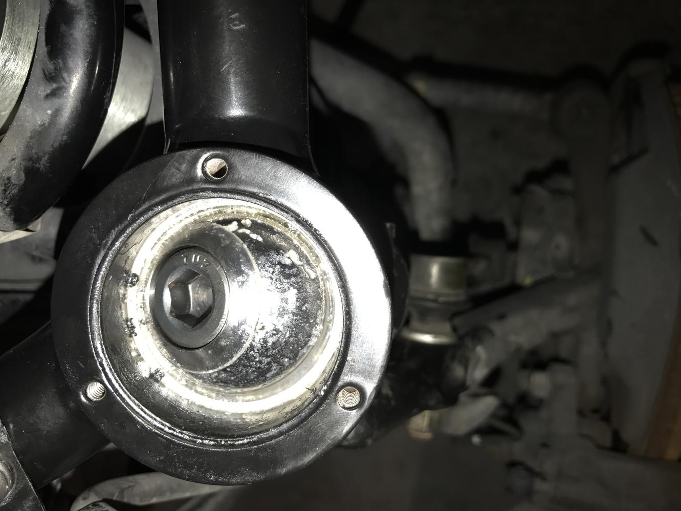

I finally got to install the Rokmen UCA. Well the right side any how.
Not sure how this is going to turn out with the standard set up.
Dark Lord does this look right to you?
