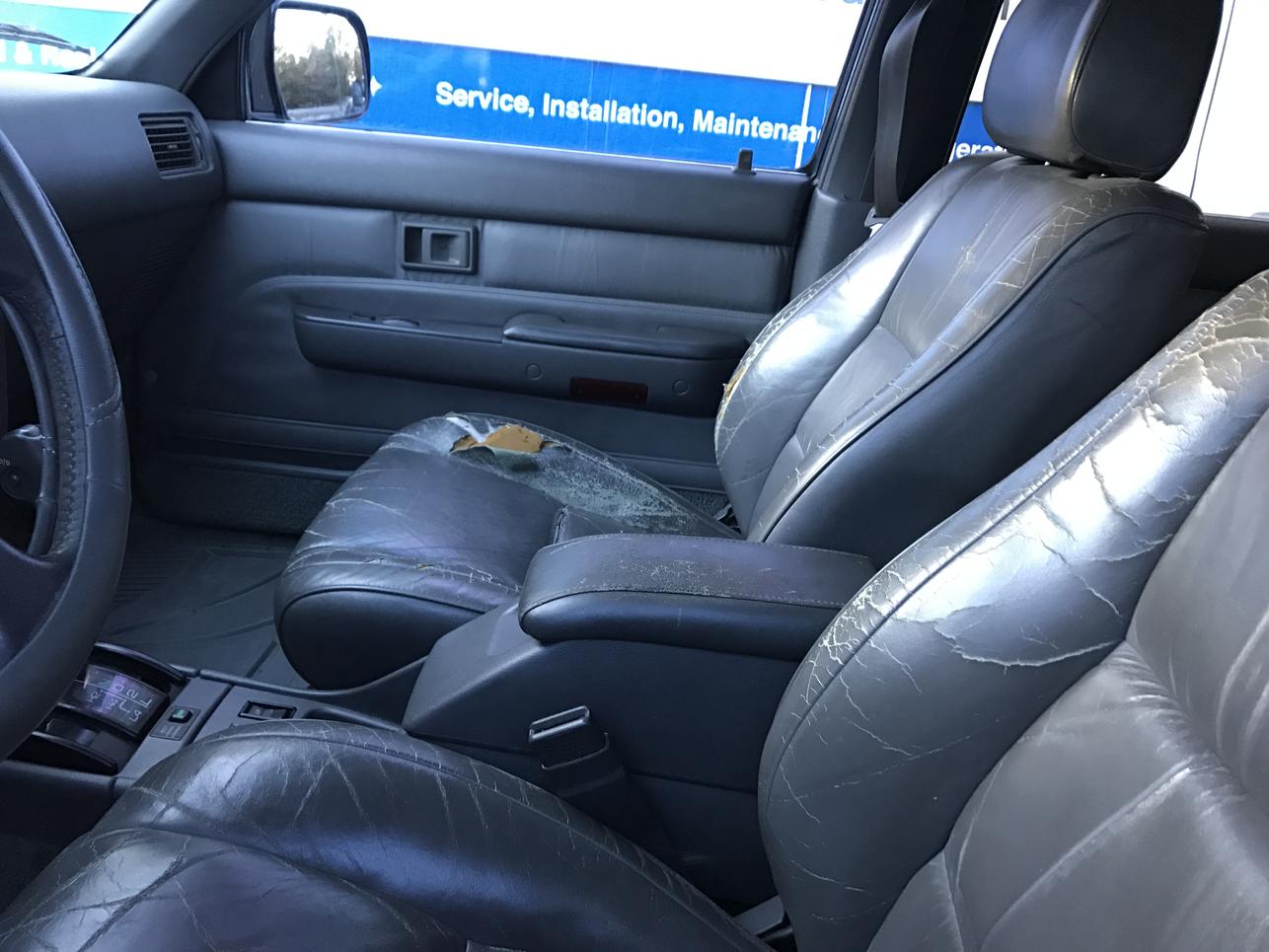

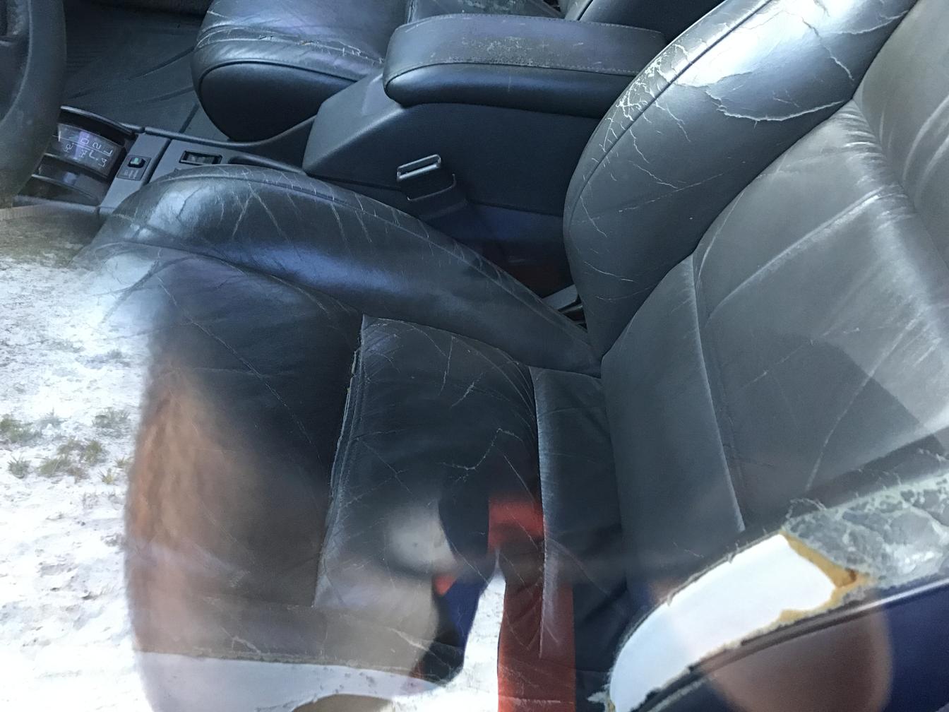

I have a 93 with leather seats. Honestly they're trashed. The foam is ok but the leather is all cracked(Florida car). I have called upholstery shops and they're asking in the thousands just for the front two seats. For that price I could drop aftermarket. Does anyone know if 3rd gen or 4th gen seats will bolt in? I have all Manual seats so I don't care about losing heated seats etc..they're are plenty of 3rd gens at the local junkyard which I can still the front seats out of if possible. I'm not really looking to do any crazy fab work. All advice is appreciated. Thanks!
90'ish prelude and acura integra seats mount up front very easily

... Does anyone know if 3rd gen or 4th gen seats will bolt in? I have all Manual seats so I don't care about losing heated seats etc..they're are plenty of 3rd gens at the local junkyard... QUOTE]
I'm pretty sure I've seen innumerable builds where the owner has put 3rd gen seats in a 1st or 2nd gen 4Runner. You might end up putting a piece of angle on one bolt as DropZone did above. We are all built differently but 3rd gen seats are more comfortable for me than 4th gen and my '16 Tacoma. Mine are cloth and in excellent shape.

Dropzone- thank you so much for the idea! As well as the pictures as to give me a general idea. I like the look of those seats and they're all kinds of old acuras being parted out on Facebook. So definitely will check those out.
Nervo19- I figured there were plenty of seat swaps out there. Especially with how similar these cars are. But like you said, google just wasn't finding the threads. I'm checking out the link you posted as well as looking for an indepth on the 3rd gen seat conversion. They're my favorite seats by far and the most readily available (in Tampa there's tons of junkyards carrying them).
