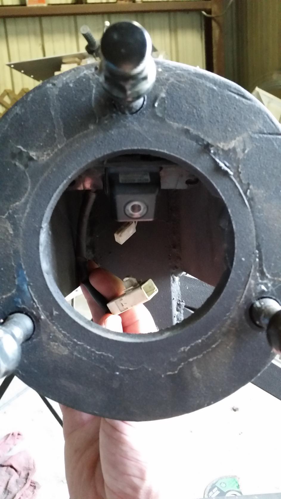

8.) Rear view camera can be moved to the inside of the tire mount.
I'd be interested to know how this is being done. So I'll wait till I see how it's executed before postulating.

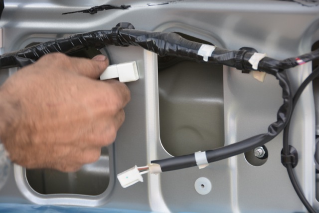

It'll mount very similarly as we do our rear GX relocation kit. With a supplied 6 wire lengthened harness you'll simply splice it into the 4 wires needed for the camera, 1 wire for reverse lights, and 1 wire for license plate lights. This new harness would exit the oem grommet, down the door, and run through the swing arm to its new location in the tire carrier mount.
