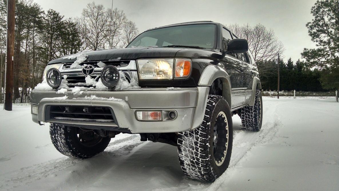

Picked up the 4runner today. Drove up through Charlotte then came down the scenic route. got to teach my wife how to drive in the snow a little bit which was pretty exciting since she is from SC and had never attempted it.

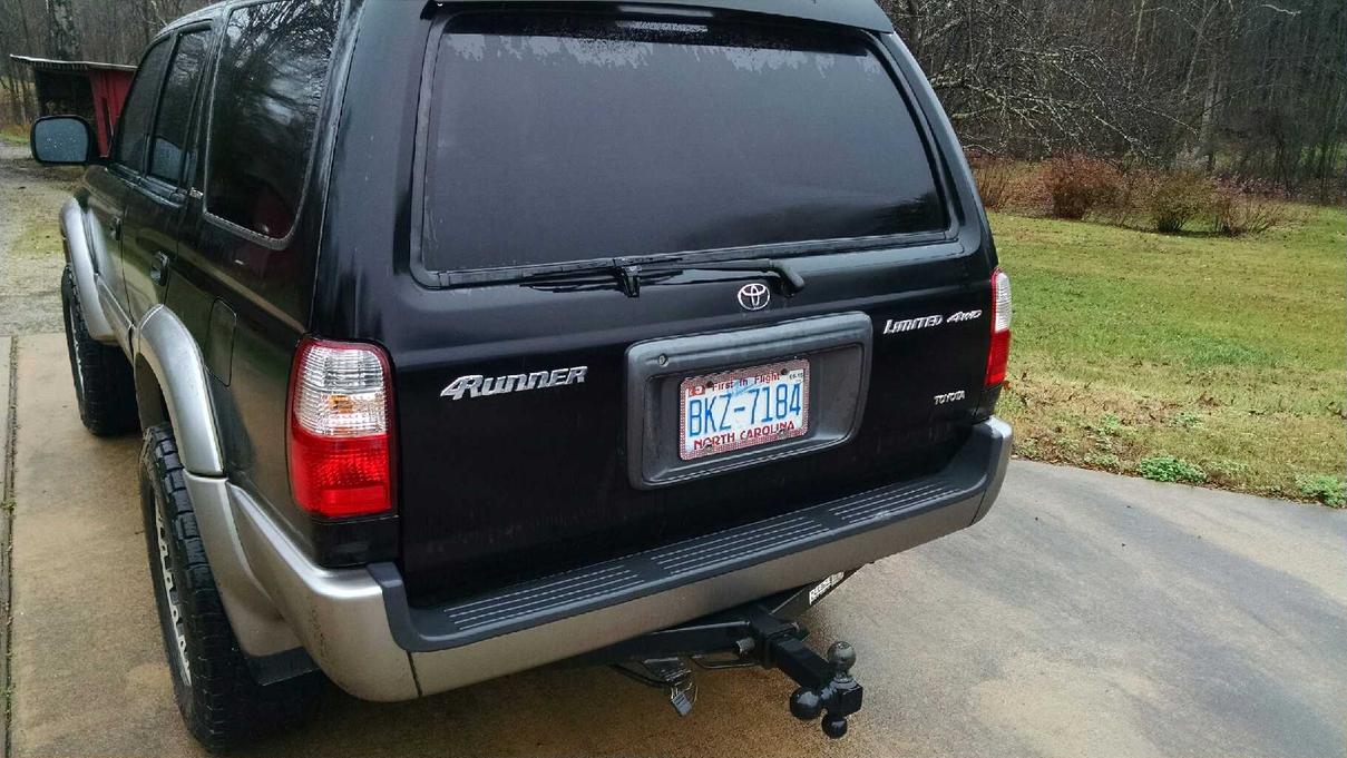

I don't have a ton of pics right now but here are a few shots...

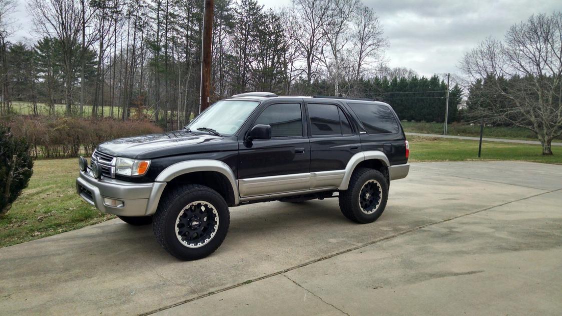

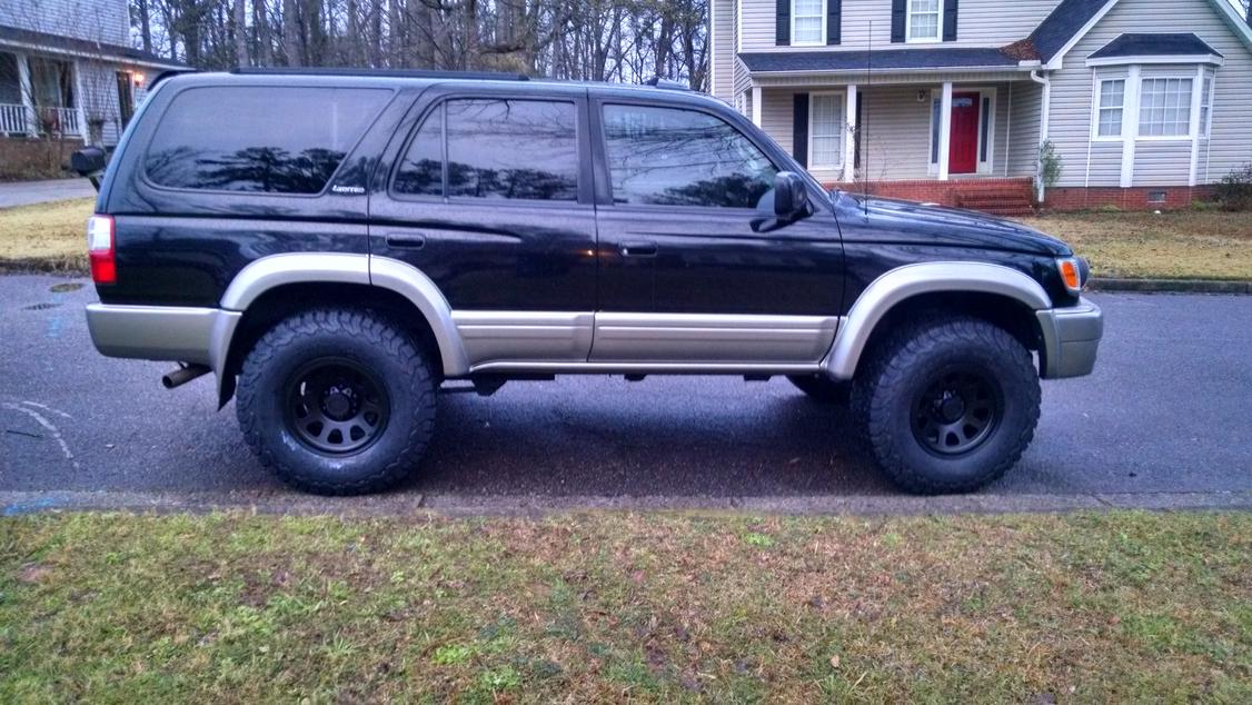

Been driving the new runner a few days now and getting a feel for it. Everything is working good. I had to do the timing belt, and water pump on it but now now I'm good on that for another 90k. I decided go ahead with rims and tires. The tires on it were older and since I have a long road trip coming up I would like to have peace of mind, and It was on the list anyway.
I got some KO2s and some MBM wheels. The wheels had fake bead lock studs which were immediately removed.

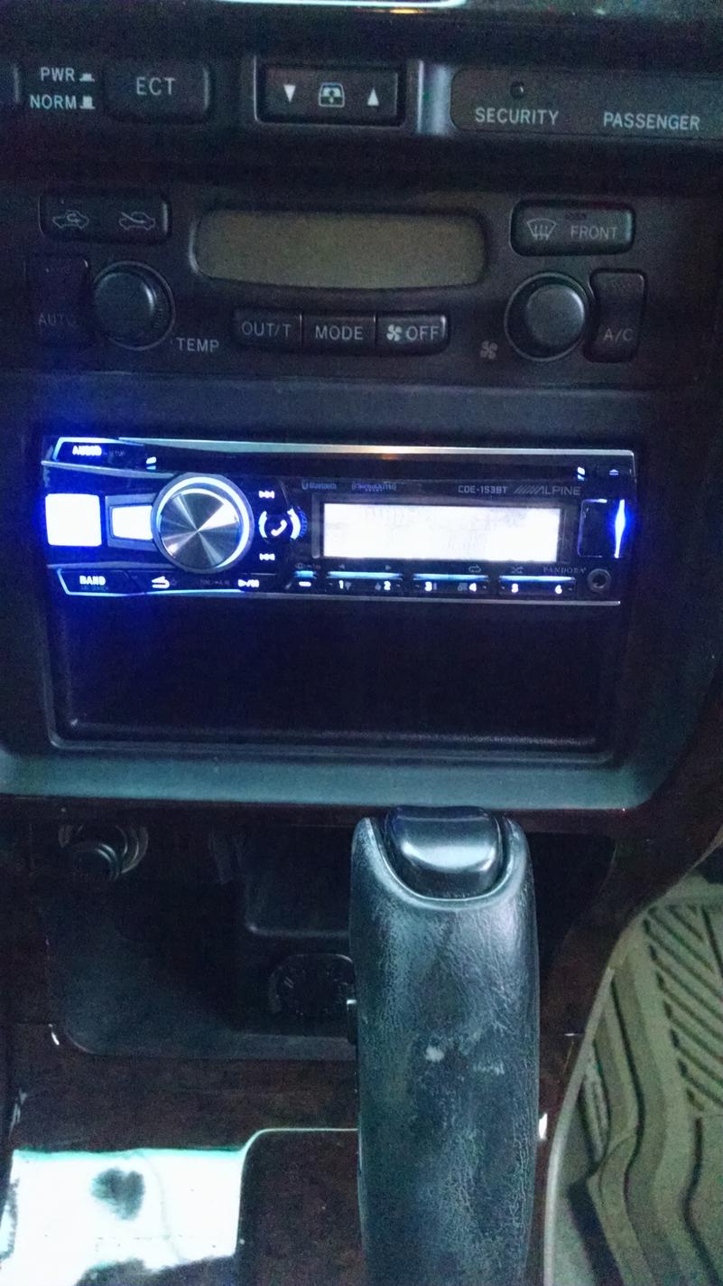

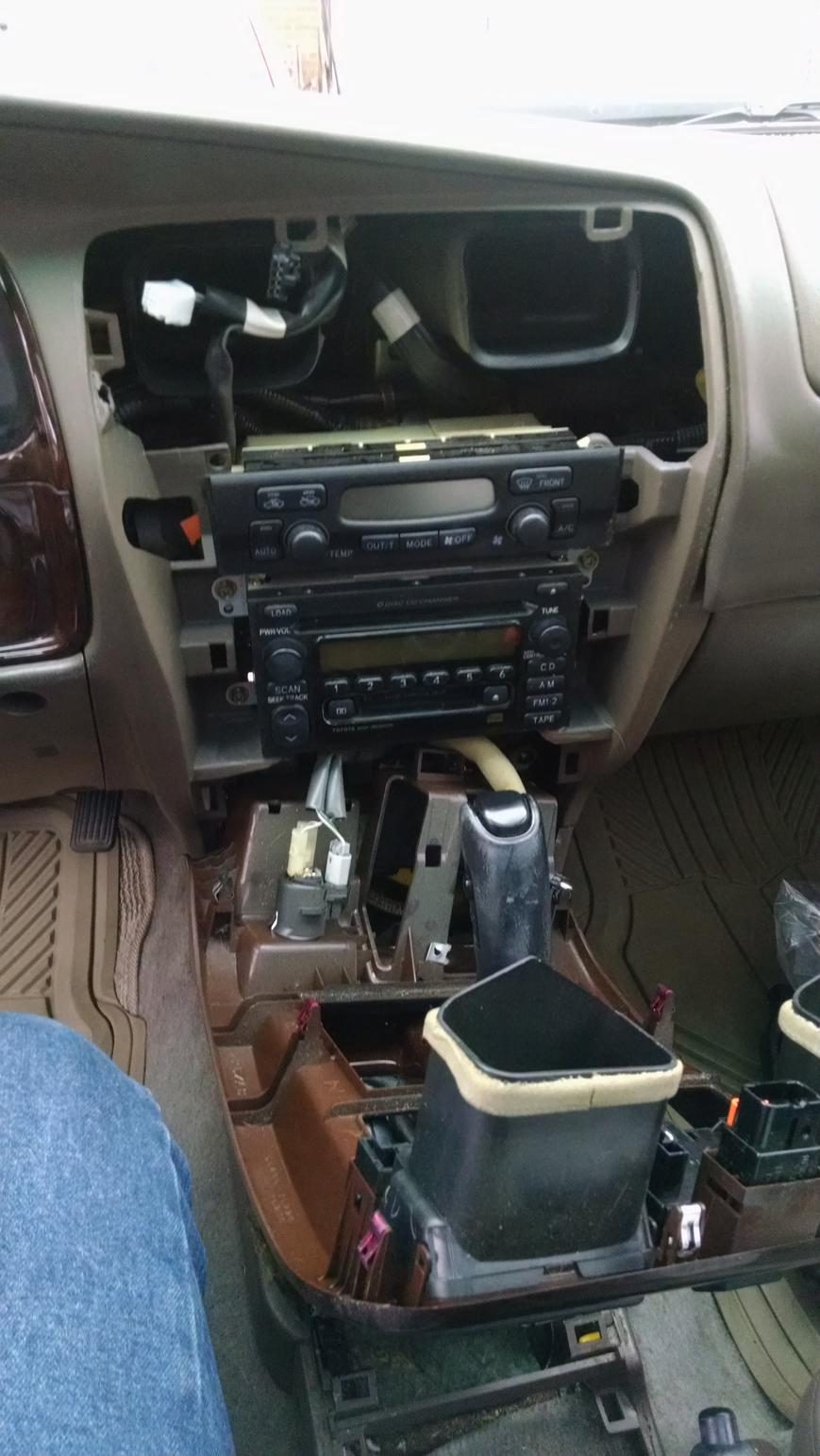

I also got a new alpine head unit so I could use Bluetooth and listen to my own music while driving. It was a fun first head unit install/ first project for me and went down without any major issues.

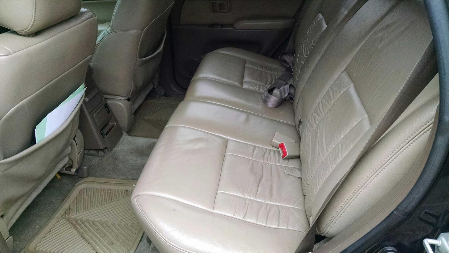

Here are some pictures.
