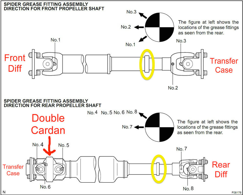

I greased my drive shafts today and I noticed something that looked odd. When I was pumping grease into points 2 and 7, I noticed the drive shafts expanding at the joints circled in yellow--is this normal?
Also, I heard the normal popping noise as the grease came through the joints in all of the other grease points, but when I pumped it into points 2 and 7, i didnt notice any come out anywhere--how do you know when there is enough grease in it?

If your pushing the drive shaft apart, that means the cavity in there is full. When you put more grease in it, its acting like a hydraulic cylinder, grease going in is pushing the "cylinder" out.
You can pull the zerk fitting off to release some pressure. You can pull the drive shaft too, and separate it, and service it that way. I usually just put a few pumps in it to keep it lubed up every oil change, keeping an eye on it to make sure it doesn't start pushing apart.

I pointed out this before. So 3-4 pumps from a SMALL grease gun is max for me. Bump the truck few times by hand and remove the 8 mm grease zerk to eject excess grease before you drive your truck.

When I greased it, it moved about 2 mm before I stopped pumping. Is that a significant amount? or should I pull the zerk fitting to be safe?

sliders (2&7) are 3 pumps max, think you put much more than that in? But it sounds more than full, so yeah need to bleed some out most likely. :cowboy:
just took a look at the front slider--it appears that the grease oozed out and looks back to normal.
the rear drive shaft is not oozing at all and it looks like a hydrolic piston ;)--are there special tools to remove the grease fittings? it looks like a really small hex. not sure if I have a socket that small
I think it's an 8mm. Hit it with a shot or wd or similar. Use a 1/4 drive, go slow, don't strip or round. When out grease should ooze out. Extra if you feel, you can collapse the drive shafts a tad. Reinstall gingerly and snug. 2 pumps at next oil change.

Alternatively, you can also take a small screwdriver or allen wrench and press in the ball bearing in the zerk itself without removing it. Watch out, it might spray if under considerable pressure.
I had to do this since my slip joints were COMPLETELY dry when I got it. I had to pump a ton of grease in there, drive it around the block and release the pressure by pressing in the zerk. I did this a few times until the driveshaft was completely lubricated again without having too much grease in it.
