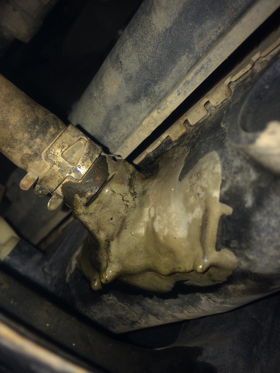

I have a small leak at the bottom of my radiator where one of the tubes connects (bottom passenger side). Looks like the PO tried to patch but it looks sketchy and is the original radiator (205k miles) so I'm looking to replace the whole thing.

What did the PO do? It looks like there was a leak and they put some kind of glue over it? Or it's a coolant stalactite. Ha.
I got a spectra radiator to replace this one. Anyone have experience with spectra?
JB weld? Get that thing out of there. Replace radiator with oem or oem quality and do the cooler bypass.
