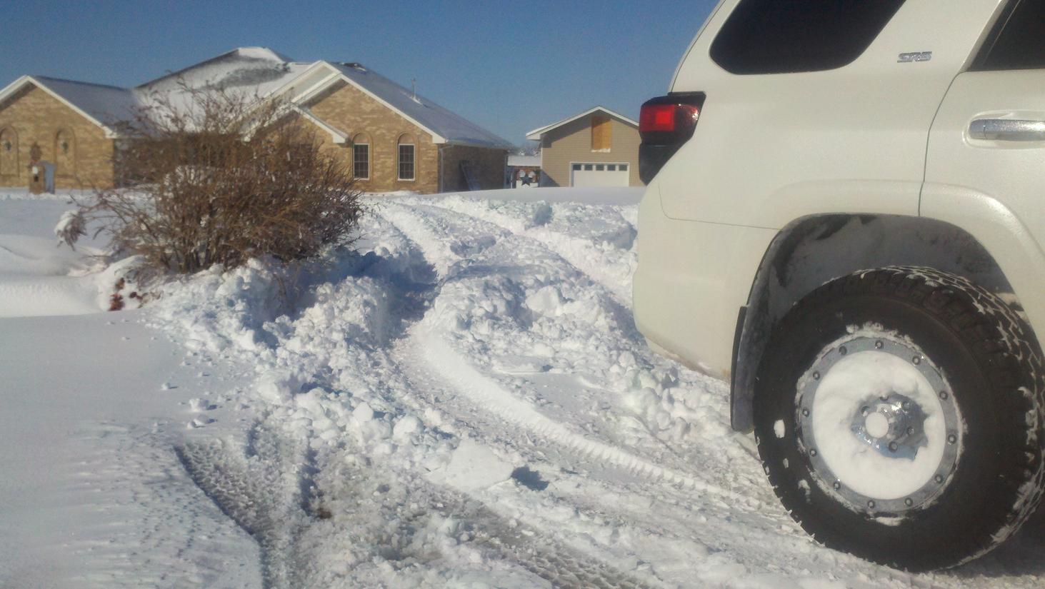

I used the Nightshades tint on my taillights and had to sand and buff the high parts off so they could be seen at night. I think they look a lot better than stock now.
