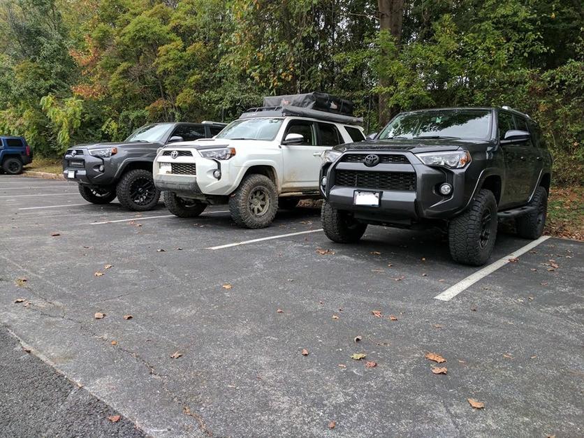

The Nitto tires run big, at least the RG do. The RG is advertised as the same height but just a little wider than the KO2 however side by side it was a bit taller and a lot wider. I can say though with my 3" lift they fit perfectly with only front bumper trimming after moving the line forward.

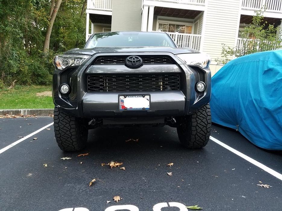

Ok, last question(s) and I'll leave you alone about it...those are TRD Pro rims, correct? I have the TE rims...is the backspacing the same? I don't mind doing a BMC if I have to, or any other trimming really. Just want to know what I'll be facing. How do those look from the front?

They are FN Wheels FX Pro which are 17x8 with 4.5" BS and 0 offset. These tires on stock wheels will rub the ball joint area of the stock upper control arms as soon as you mount them on the truck. Basically can't be done unless you run a wheel spacer, at least in my experience.

Another view

Love these tires, but they are just soon heavy.
Each tire and wheel package weighs about 90 pounds. Wasn't a concern for me though. They look good, perform nicely, that's all I care about. Truck still has plenty of power and does just fine going down the road even at higher speeds.
I'm running the ICON stage 2 kit with SPC UCA's so hopefully rubbing there won't be an issue. Not a fan of spacers!

You'll very likely need aftermarket wheels but post up and let us know how it goes. You're welcome, let me know if you need anything else.
