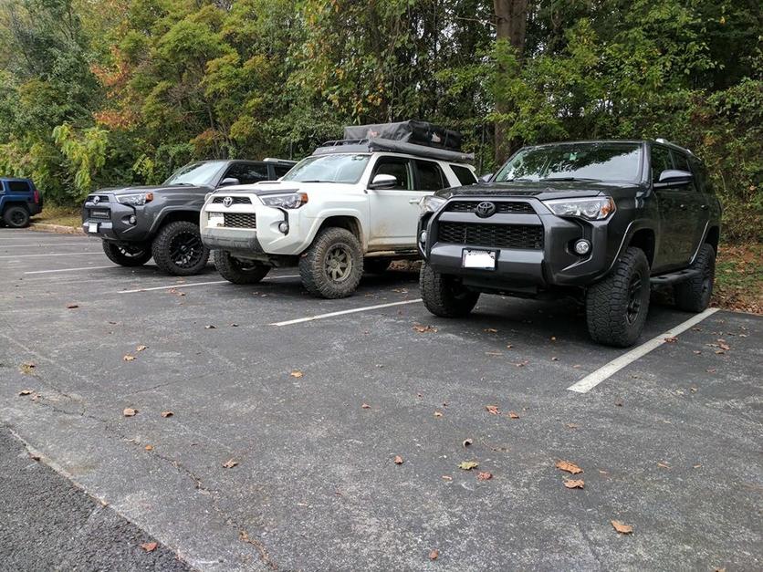

Significant improvement over the 285 BFG KO2 I was running. Here's mine along with a couple friends. White truck has the same tires in a 285 so really can't get a better side by side comparison.

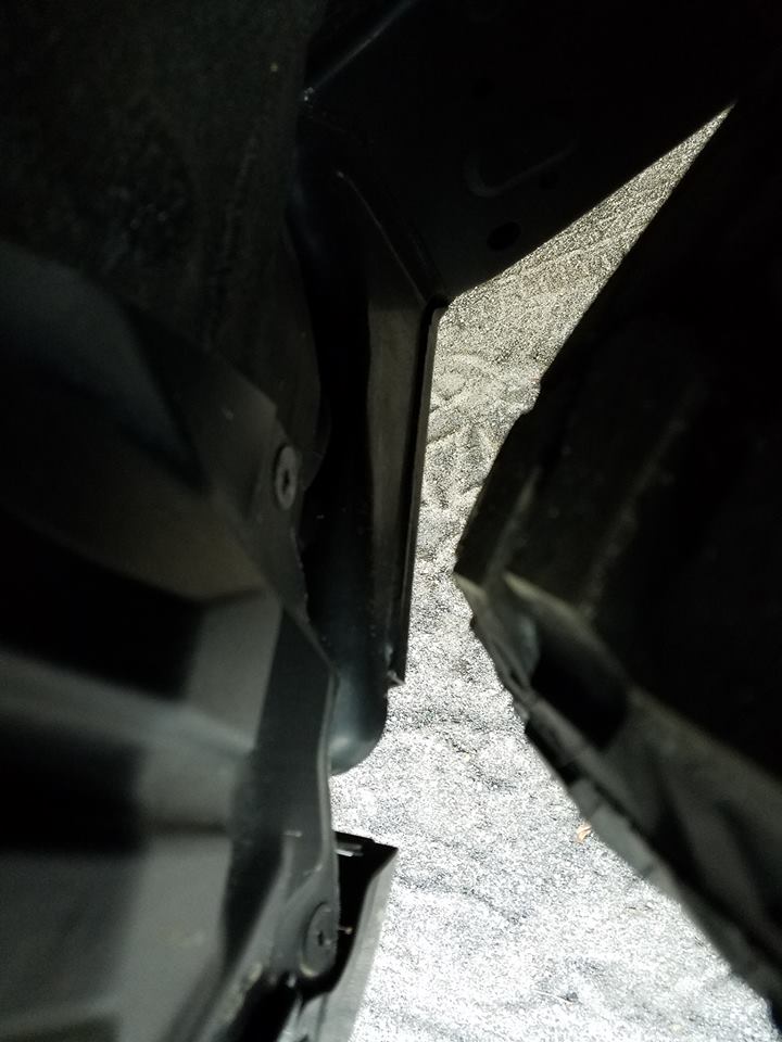

Not sure how you 295 guys aren’t rubbing the body mount at full flex. Mounted 285s yesterday and this is the amount of clearance at full lock.
I did BMC and a lot of trimming. I'm also running 17x9 -38 F5's. I could fit 305s with the standard 17x8.5 0 to -12 offset wheels. But I like my stance too much.
