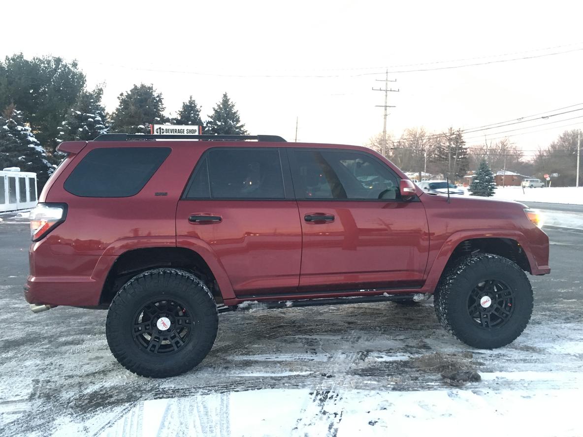

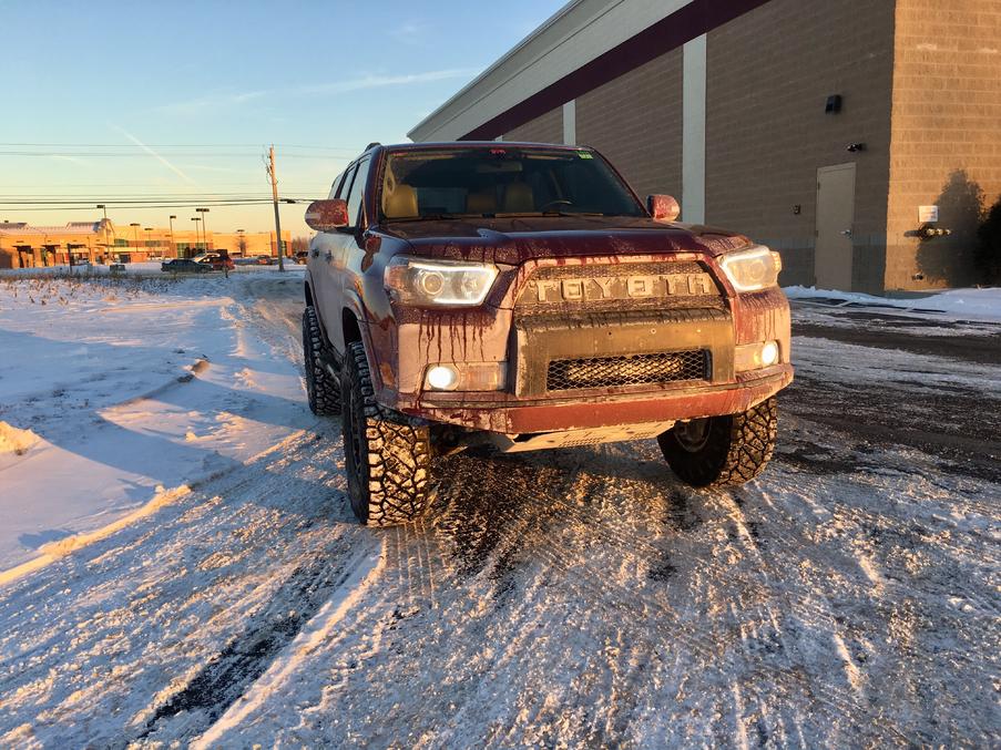

Here are a few I took as soon as I got the keys and was still in the Discount Tire parking lot. Then after a quick laser wash to get all of the salt off. This thing looks and feels so frickin awesome now. I love it. It does rub very badly though. Both on the front fender well and near the body mount. So I’m planning on a weekend of cutting coming up.
The weight and changed gear ratio due to their size is definitely noticeable, but it’s not as horrible as I had imagined it to be. It’s definitely slower, but still has plenty of power when I jam on the gas. I am dreaming about regearing and getting a locker, but that’s gonna have to wait a while.
These are super quiet compared to my KO2’s. I didn’t realize how loud those were. The ride feels great on these. I just roll right over potholes and bumps Now and barely feel a thing.

Looks great! How much caster are you running in your alignment? More caster will not only improve your ride quality but will also shift your tires forward. This may solve your BM rub or at least help it. I'm running the same tire in a 295 and have no rubbing and plenty of room on the BM. Only had to trim the lower inner lip of the plastic bumper and I was good to go. I think next time around I will be going with the 305. I also plan to gear down to a 4.56 between now and then.
