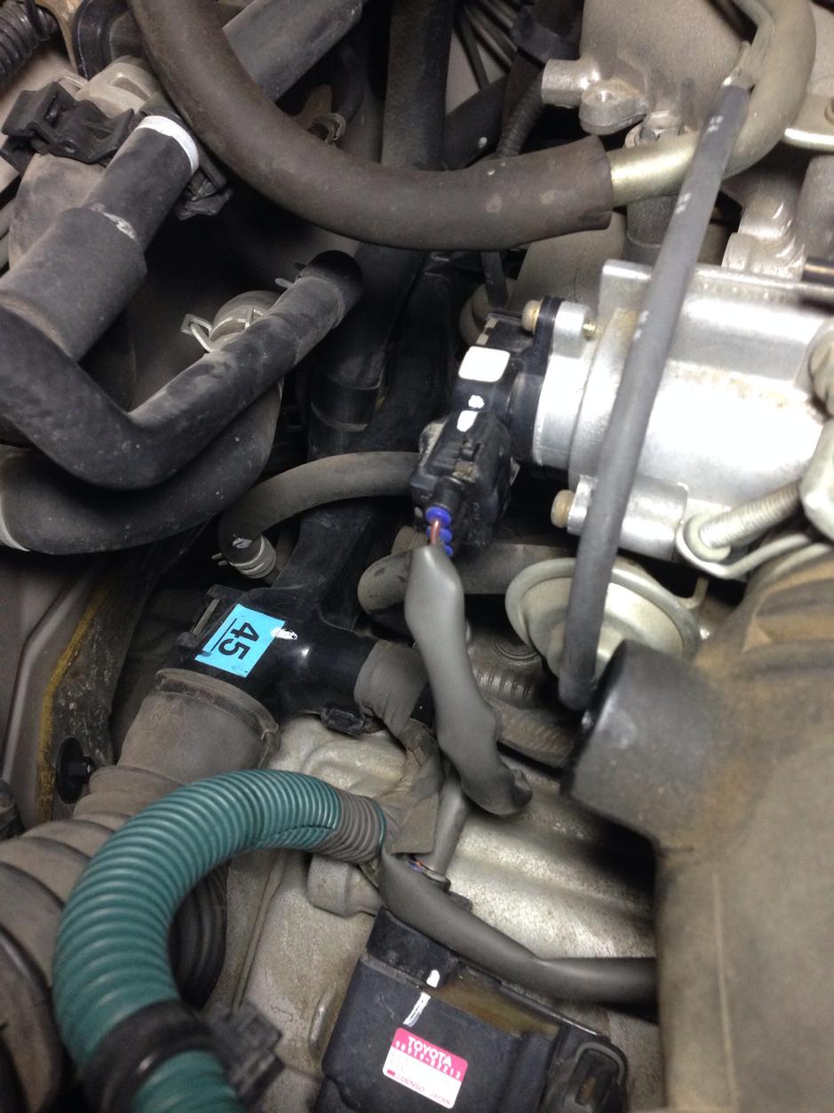

Recently picked up a 97 5spd. Runs great good power Cel was on when I got it. Checked the codes and it was rear o2 and tps sensor. Went to swap out the tps tonight and found that the wires were cut to it...don't even see where they were supposed to run to. Can someone help me out with possibly a picture showing where the other end of the wires is supposed to come put of.
Thanks

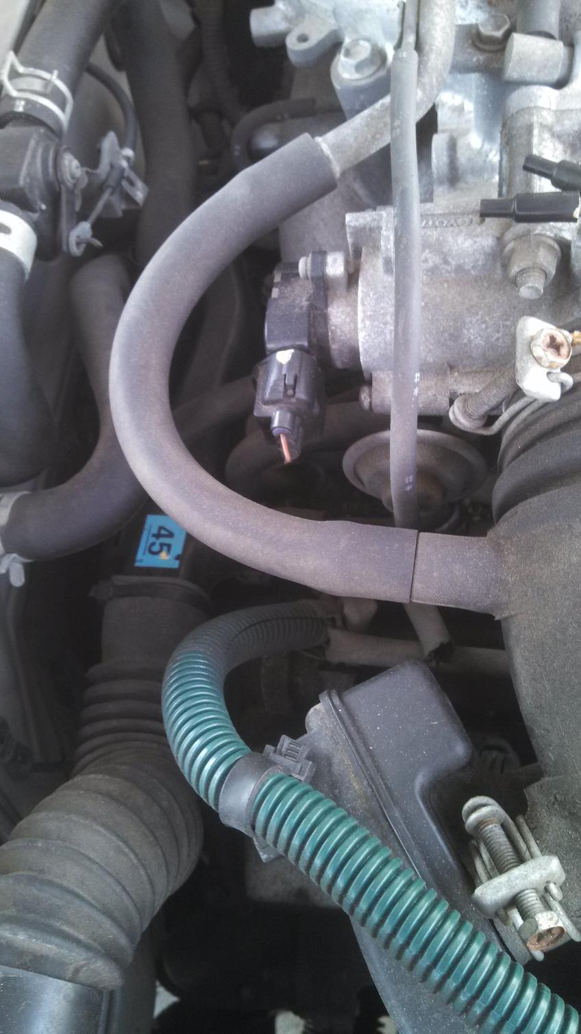

This is where my tps connects to...into that bundle with the blue 45 label on top. Would really have to dig to see any more...

Thanks. I found where they clipped it and was able to get a pigtail harness to splice on so I can connect my new sensor. Irritating that anyone did that rather than just unplug
