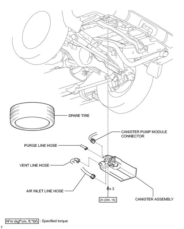

Not only that,the sound he's hearing is most likely the pump on the carbon canister for emissions as it's in the back in Toyotas, not the fuel pump, that is supposed to be sucking fumes and he's flooding it with raw fuel and will destroy the canister over time at the tune of around $400 plus labor for the canister assembly.
