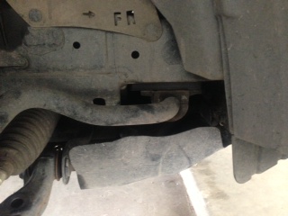

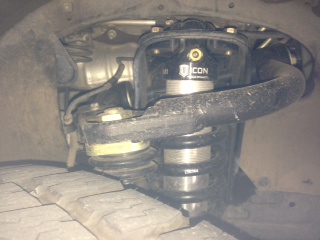

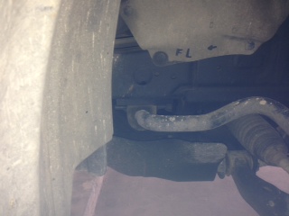

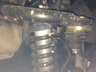

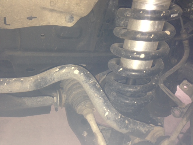

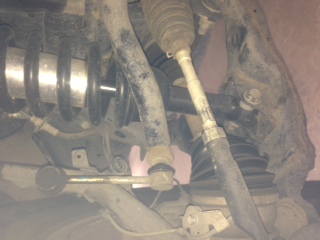

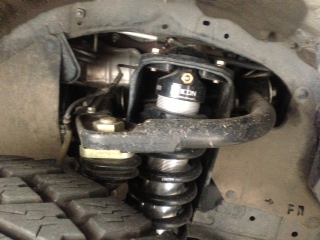

Post some pics of your install. Include both upper and lower strut mounts, upper control arm, upper ball joints, the sway bar mounts and relocating bracket for the sway bar. On the lower strut mount be sure we can see the spacers on either side of the strut.
This seems to be more that just the squeak/creak you asked me about.
Pics
Pictures Icon

I am not sure if the Icon's have heim joints like Overland Warehouse/Radflo. My OW 2.0's creaked really bad, and it ended up being dirt particles in the heim joints. Once I realized what it was, I kept the joints lubed up with some Amsoil Heavy Duty Metal Protector, and the creaking didn't come back.
It all looks good to me. Anyone else seeing anything that would make you think creaky clunk? Only thing I can't make out is the spacers in the lower strut mount, the longer one should be toward the front. If not then the spring will contact the swaybar. You have regreased the uppers again you say? I've done mine twice also and they are creaking again too.
The Light Racing uca's are nice but the bushing/sleeve/washer design leaves a little to be desired! As I said in another post I felt the design had squeak written all over it.
Which side do you have the bigger bushing where the CO attaches to the lower control arm?

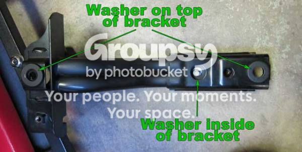

Do you have these spacers under the frame supports so the sway bar doesn't rub ?

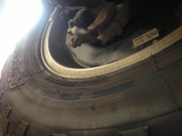

Just found out the something is rubbing front tires inside also
So that should make diagnosing a little easier; you now know the precise area where contact is made. I would check everything in that circumference for rub marks. It looks like it's making pretty good contact so that should be fairly easy to spot. If anything, color in suspect areas with crayon and see where it's getting rubbed off. The color should make it easier to spot.
