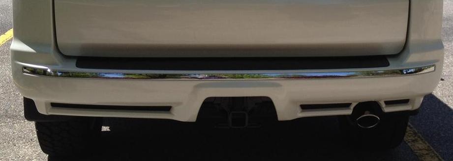

I believe that Limited and SR5 have have the pre-cut hole in the bumper, and Trails don't. Pic isn't mine, but this is what it looks like.

I don't understand why you care so much what that really obscure spot looks like. So there's a cutout there - so what? If the exhaust smell bothers you so much - fix it, move on.
Or, weld a false chrome tip in there, AND move it - who'll know?
I had the muffler cutout and a Mangaflow installed. At the same time I had a 90 deg bend done on the tailpipe. I looks better, but only slightly helps with pushing the smell far enough away when the back window is down.
