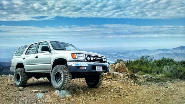

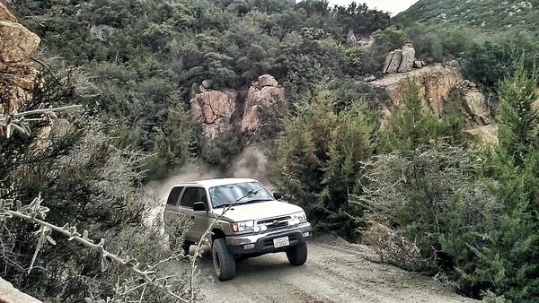

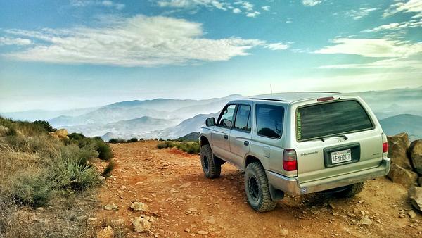

I couldn't be happier with the ride quality on mine. Daily they feel great and I have finally taken them off road a little bit where they also felt awesome for the things that I use the vehicle for. I mostly was doing higher speeds on fire type roads with ruts and bumps. My build is more a "prerunner" style build so higher speeds is more my focus, which I am thinking your build is the same absalom. I know you have mentioned lower CG and everything. I also did a few mild climbs and crawls and it all felt great! Vehicle always felt comfortable and in control. I was able to get it to rotate really well too for sliding and transitioning into corners, seriously had a blast.
If you find me on instagram "JohnBurrowsRacing" you can see a little clip of me driving a part of the road.
Got a few photos out of that day too
