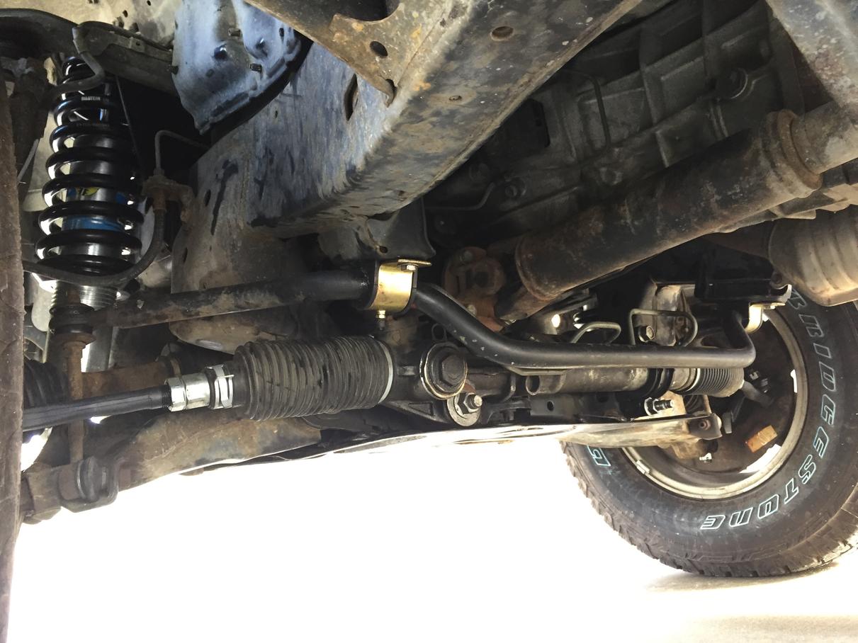

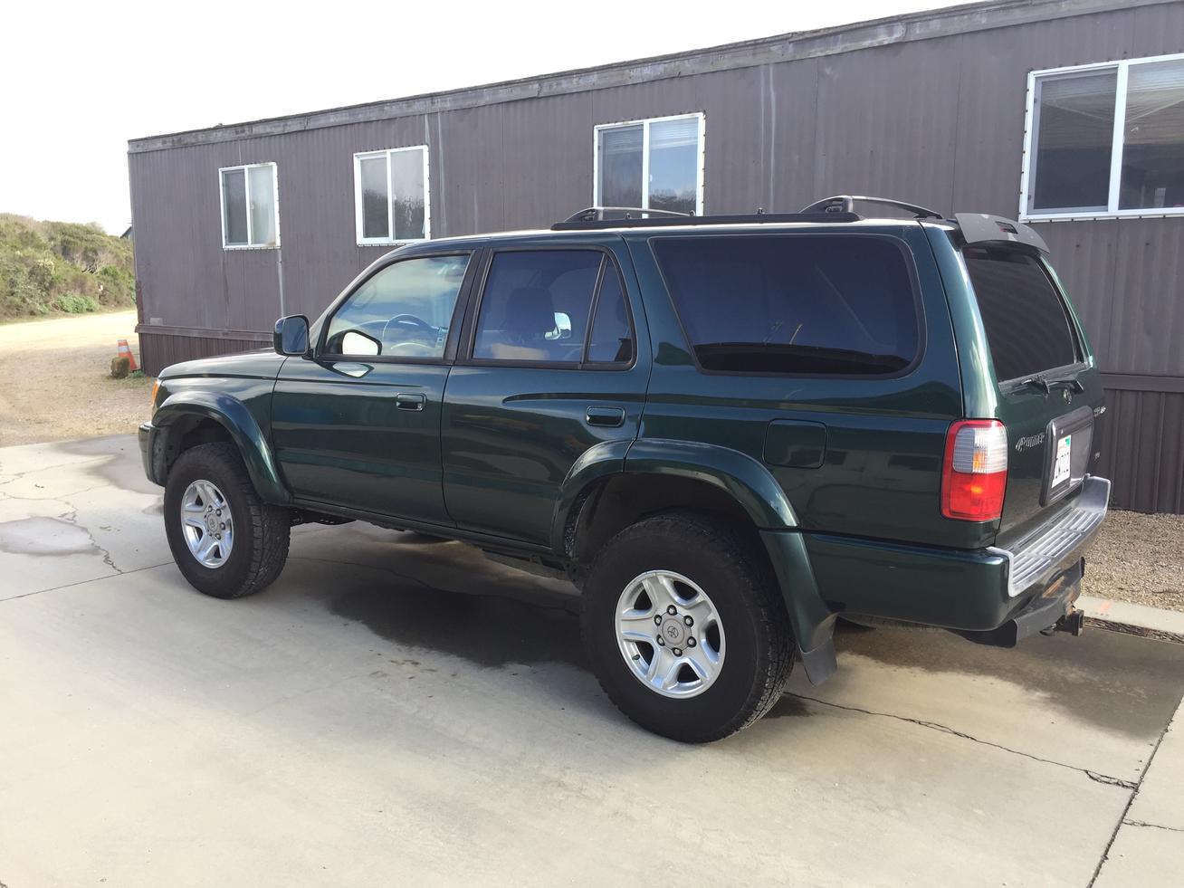

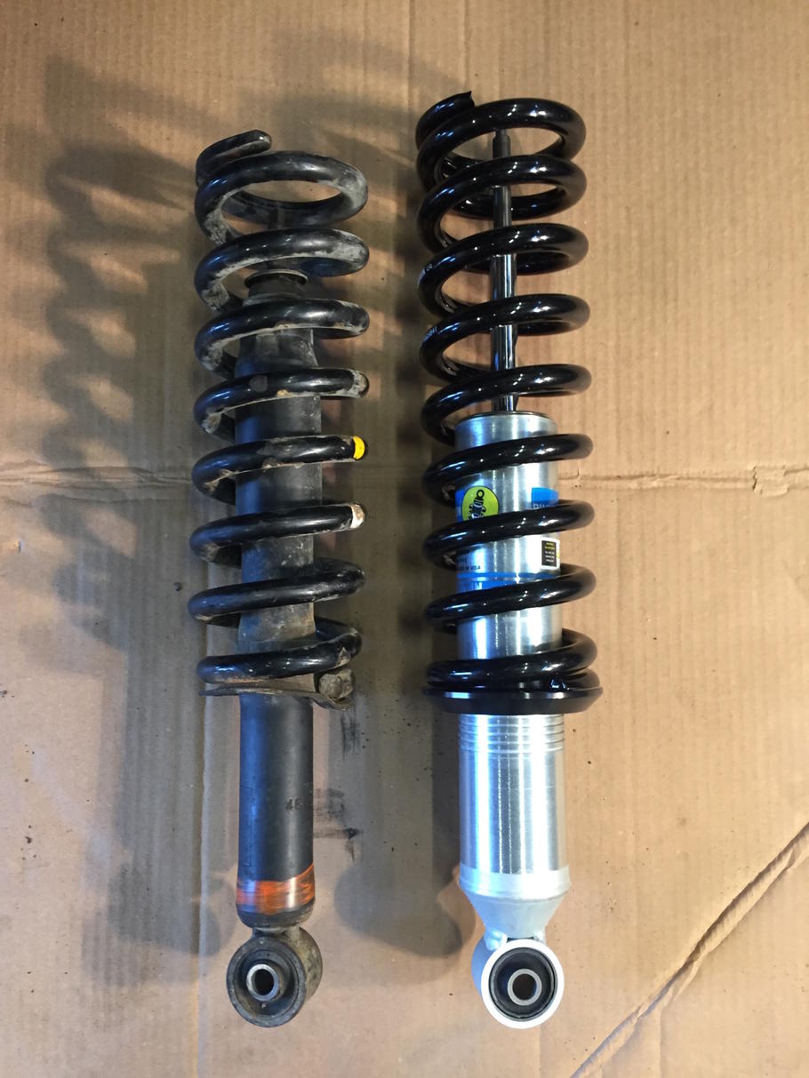

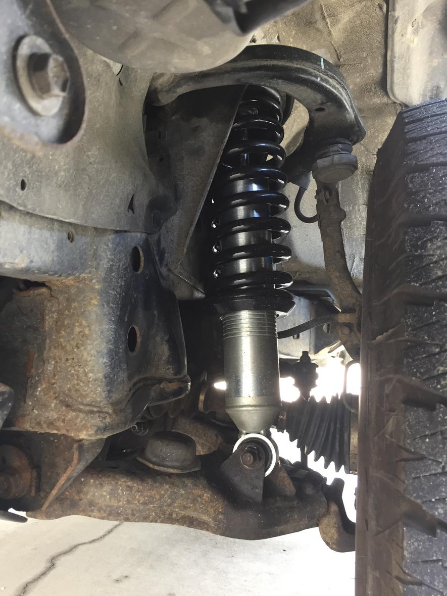

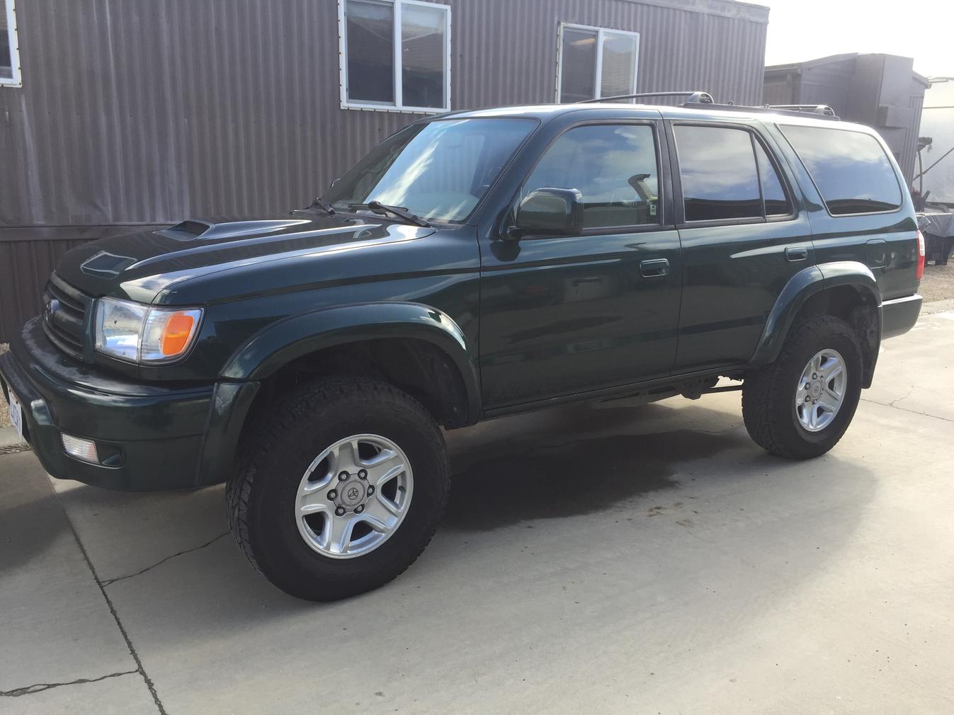

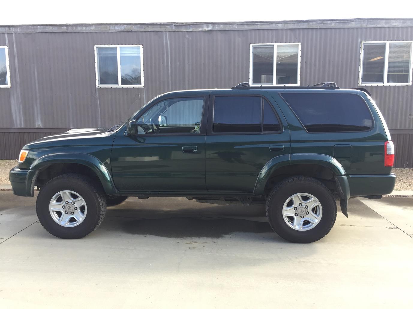

Finally got some time to install new 6112 coilovers on my 2000 4WD 5-speed. I had been riding around on the original stock everything (180K miles) so I installed new OEM ITR, OTR, LBJ, Energy Suspension poly steering rack and end link bushings. I matched this in the rear with new 5100 shocks, OME 906 coils, and new Energy Suspension poly end link bushings. I set the 6112's at the #7/#6 height for 1.64" of lift and actually got closer to 1.75" in the front and a full 2" with the 906's in the rear. We'll see if it settles at all. I also removed the running boards so the truck has a whole new stance/look. I just got back from the alignment shop and already I'm very impressed with the ride, feeling firm and planted but soaking up bumps at speed. I'm looking forward to getting onto some trails very soon before the big Baja trip in January. Thanks a bunch to [MENTION=118252]Chas of MRT[/MENTION] for getting these out to me as soon as they hit the shelves.

Looks solid! I'm loving my 5100s all around with OME springs. Hit some wash board roads the other day and it glided right over them. Before with my OME shocks it was uncontrollable.
Looks great! Looking at the 6112's for my truck also but waiting on the 5160's to pull the trigger. Funny - I have a mica green 01 with around 180k miles too.

Sorry [MENTION=82822]tors10[/MENTION] just saw this. Here's my center hub to fender measurements:
Before: Front- 20/20.125" Rear - 20/20.25"
After: Front- 21.875/ 22.125" Rear - 22.125/22.375"
