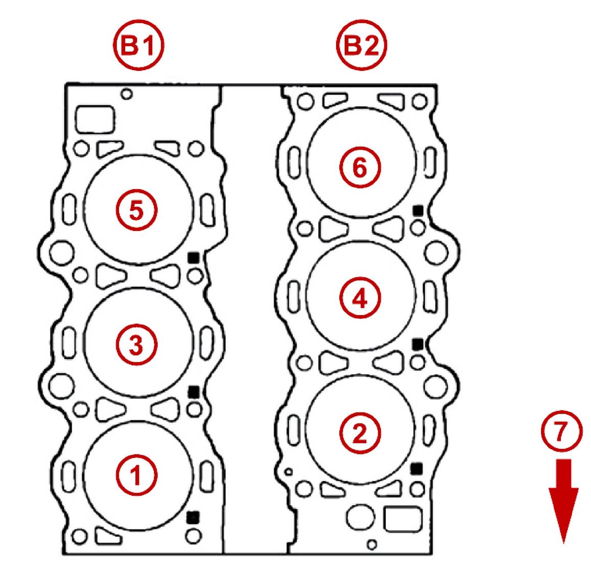

Sorry about the delayed response, was on a Toyota120 camping trip.
Ermmm i think there is a mix up somewhere, i think bank 1 is passenger, bank 2 drivers.
blackworks, pls chime in, i am trying to resolve a p0174 on my trunk, and have been focusing on the drivers side all along without success
I do believe you're correct....for the V6, bank 1 is on the passenger's side....but for the V8 bank 1 is on the driver's side, sorta confusing for Toyota to make it different for the 2 engines, BUT someone correct me if I'm mistaken!
[MENTION=66389]BlackWorksInc[/MENTION] or anyone else that knows for sure??
