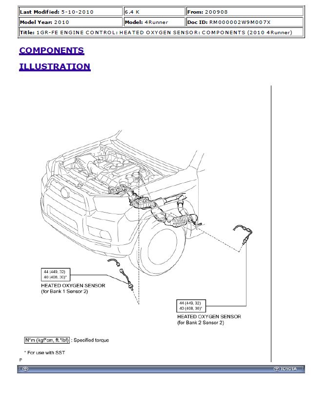

If it is a pain for the dealer to replace, it will be a double pain for you unless you know how to do it. Besides getting to it, they can be frozen and almost impossible to take out. They often need a special tool due to the pigtail wires that come out of them. Then you must use high temp anti-seize on the new one, otherwise it will be impossible to remove in the future.
I haven't changed one on my 4Runner yet, but I have done 3 on my Tundra. They should be easy to locate. Yes, they may be rather hard to get loose - but my Tundra O2 sensors were in there for close to 20 years. You do need a socket with a U cut out of the side to accommodate the wire. Just look for an O2 sensor socket. It's best to get a replacement that already has the connector on the end. You can buy universal ones that you have to splice in. Bosh made the ones I have used with good results.
So, bank 1 is passenger side. Bank 2 is drivers side.
Makes sense.. cylinder 1 is passenger side front, cylinder 2 is driver side front.
