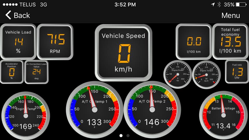

Hey guys. I have a Wifi OBD2 dongle on my truck with the OBD Fusion app. I downloaded the Toyota PIDs for it and I have found a thing called Knock correction learn value.
Is this the information you guys need to settle this debate? I am almost certain it is the actual timing the computer decides to use depending on the knock sensor data.
I have seen it as low as 13 degrees and as high as 25 varying with the temperature and load on the truck. And I can definately tell the difference in power.
