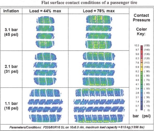

These E rated tires are max pressure rated at 80 max psi cold and it is not uncommon for folks to run them in the 40-50 psi range. I run my 265/70 R16 C rated tires at 35 psi. It's all about rating, load capacity and contact patch.
I can experiment with 35 psi this week in the 32s and see how it feels.
With my luck I would be the one in a million person to have a deflated tire fail on me in the middle of nowhere; getting home is still my highest priority
It's really just the contact patch we care about for performance and longevity of tire wear.
We care about the tires rating, which is it's load capacity, wheeling only in relation to it's ply count. We want more ply both in the tread and in the sidewalls. I wouldn't even consider wheeling on a tire with a 2 ply side wall. There fine for fire roads but get into any rocks and you have a really good chance of cutting a sidewall.
Did some chalk testing last night and 37 PSI looks to be the winner for highway driving
That sounds more reasonable. A 3rd gen just isn't that heavy compared to the load capacity of E-rated tires. Now, if you were towing a 10k lb trailer with a diesel 1-ton, that's a different story.
