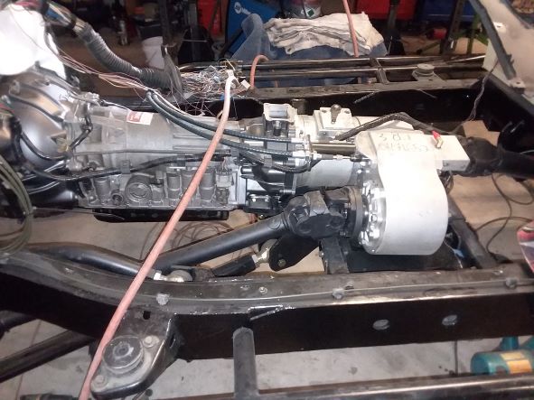

[MENTION=95183]octanejunkie[/MENTION] just a heads up you can setup a Marlin dual tcase to have 2.26 gears instead of 4.7’s. That’s what I did originally in the video Sean and I made. But in the end I did switch over to 4.7’s. Not a huge noticeable difference but it is a tad bit slower. I actually have the input gear to switch the 2.26 gears to 23 spline if you end up going that route (adapts the gear drive tcase to 3rd gen transmission) lmk. I think the gear drives are 2.26 ratio, don’t quote me on that lol.
Edit: maybe they are 2.28’s like you stated above.
So this is interesting, if I could adapt a gear-driven case I would put 4.7 gears in it and run a single case... got more details?
I sent Advanced Adapters an email about mating an Atlas case to an R150F
All gear driven cases from Toyota pickups/early 4runners are 2.28:1, some call them 2.3:1
If you just wanted to run a single 4.7 case you would have to use the entire gear driven tcase (3rd gen tcases are 1 piece vs gear driven tcases are 2 piece). Which in turn would mean your driveshaft would switch to passenger side and you’d have to SAS. I think inchworm and trail gear used to make a fully machined driver drop tcase that you could run 4.7’s in but those are long gone from what I understand. From what I remember the problem that I’ve seen with atlas’s are they are a bit larger than oem cases and you’ll most likely either need substantial body lift or floor board chopping. But yea with marlins setup you’re not forced to run 4.7’s you have the option to stick with the 2.28’s instead so you’d be 2.28/2.57. Similar to NWF but they are 2.57/2.57.
They have adapter kit for this already, no different then mating up to A340, the tcase mating surface (rear housings) are the same.
Finally get to see more of your project!
Did you go with 4.3 or 5.0?
pretty sure i've shown a similar pic before...
3.8:1 to have the 10:34:1 low only because of the geography around here, would go with the 3.0:1 and have the 8.16:1 if i was around more go fast terrain like u.
if u go with an atlas i have some of the adapter and shift parts i never used to get the 3f310(a340E) to work. Advance didn't have the parts because of the "unusually" engine/trans i am using. In addition, I just did not like how the shifter kit cables needed to b run so i just made a system that fits r 3rd gens in a cleaner fashion.
