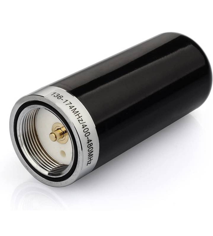

Ordered electrical supplies I thought I had for my dash projects, delayed, and started messing around with antenna mount locations. Might go with a roof rack mount and install my 20" antenna when I go wheeling. Maybe leave a shorty on the NMO instead of just a dust cap to clear indoor garages.

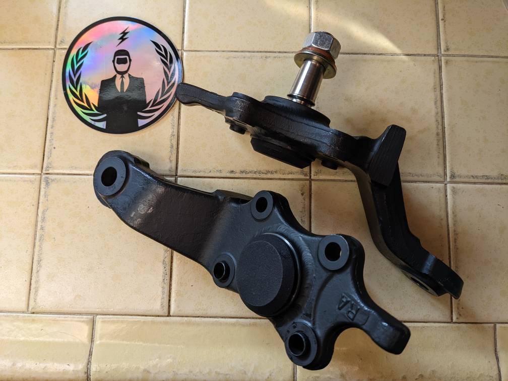

This makes me nervous to look at. How have they performed so far? Are they greasable through like a zerk?
Hahahaha
They are PTFE lined and impregnated and should be "lubed" with TriFlow after submersion or every other oil change.
They've been solid so far
