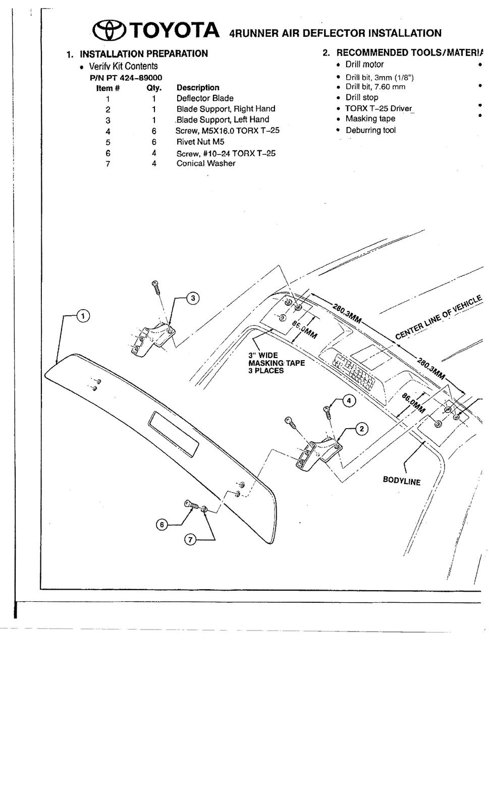

They are not a rare size but the factory (or 3rd party) screw has a bit of a self tapping end. This end would be difficult to find but it's not necessary. I believe the size is an M6 or M8 as I just purchased some for my deflector install.
The harder part to find would be the concave plastic washer. The closest thing I could find were screw washers and they wouldn't work. I ended up rehabbing 3 of the washers and using a rubber washer for the forth screw. When they are installed you can't make out the difference.
Here you go. All the information you need on the screw size.

I didn't even realize that they came with a washer, but a plastic layer between the two metals seems logical. I'll see if I can fab someting up.
Awesome. I'm a bit of a stiff for always wanting things exacting, so this is gold. Thank you!
