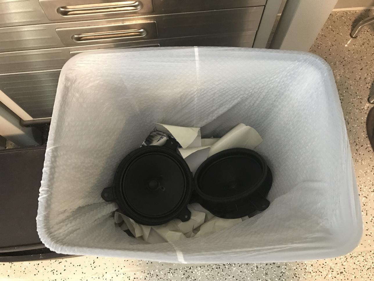

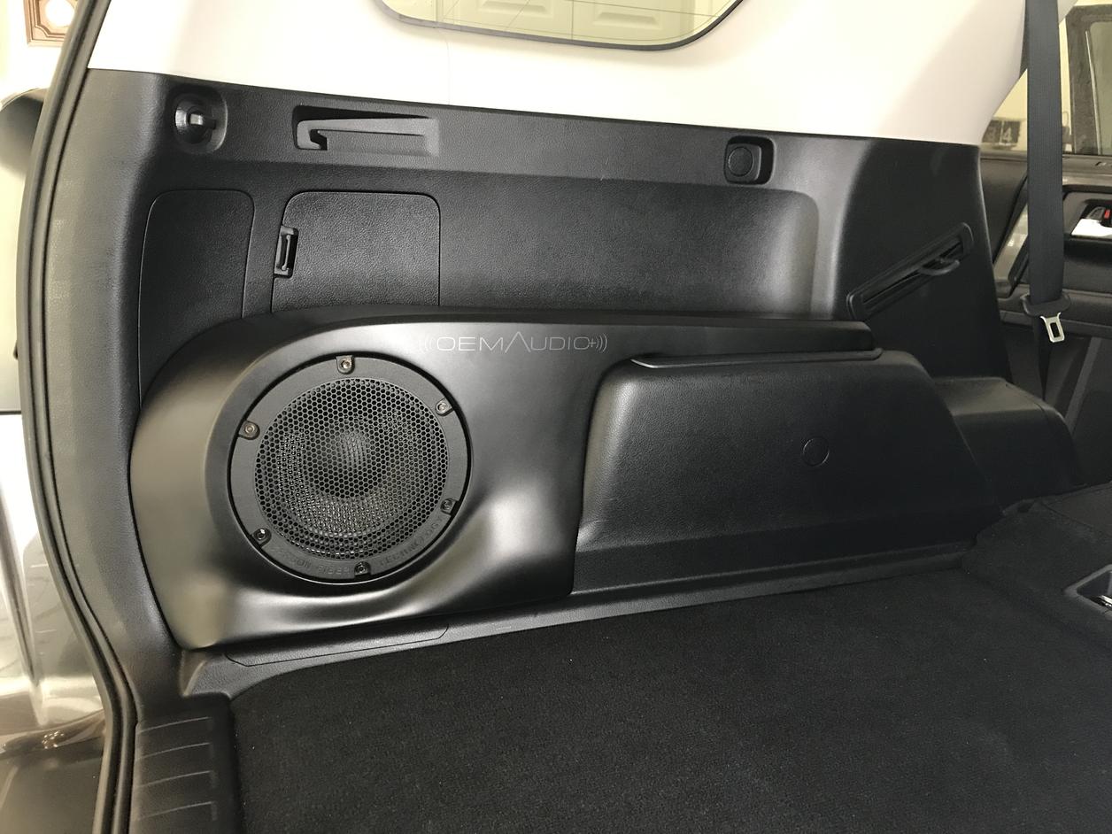

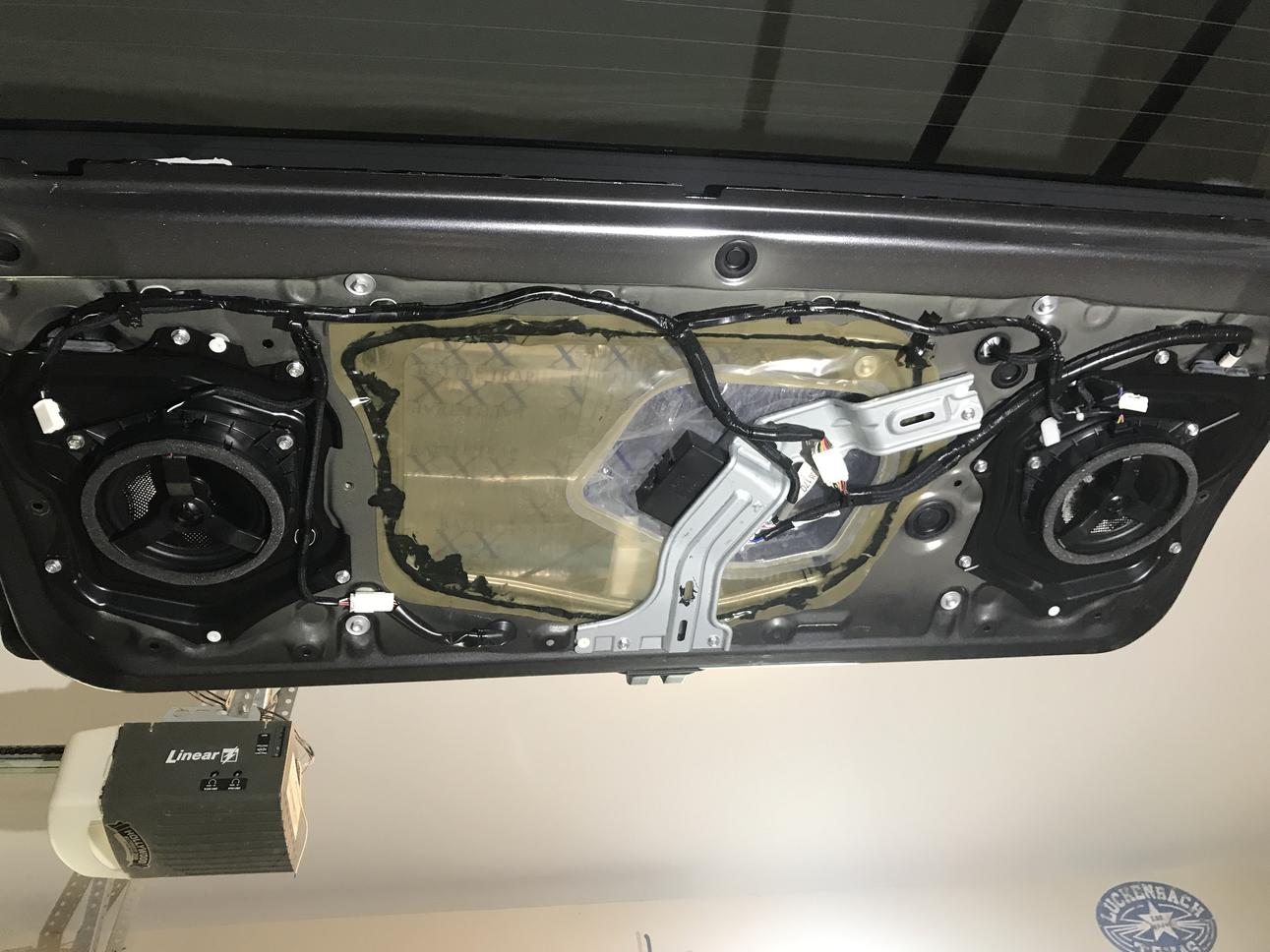

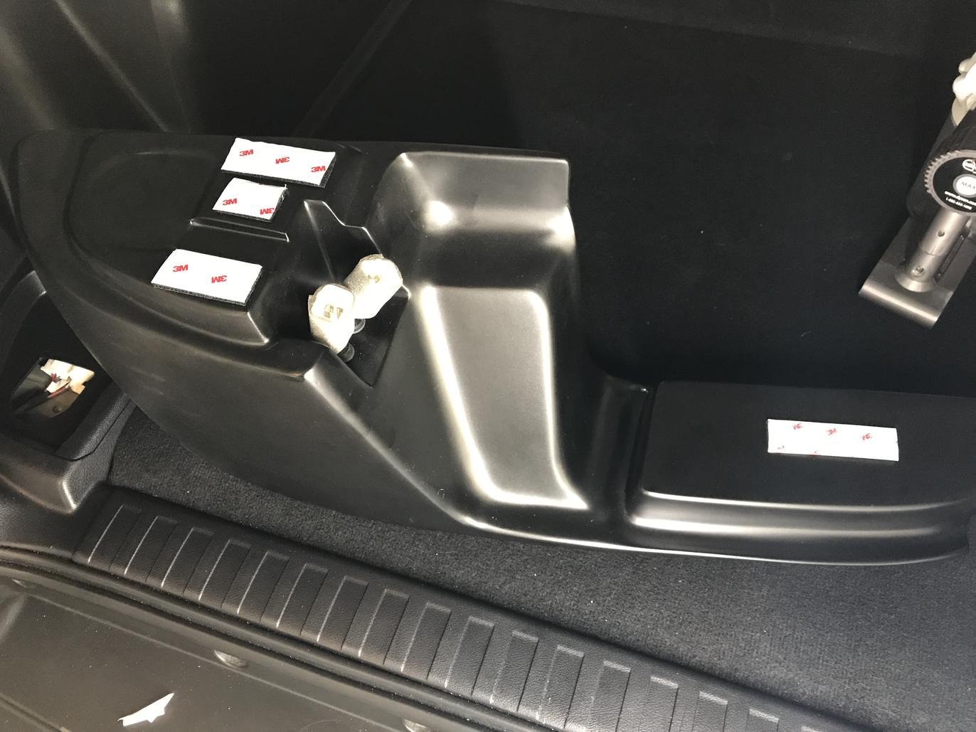

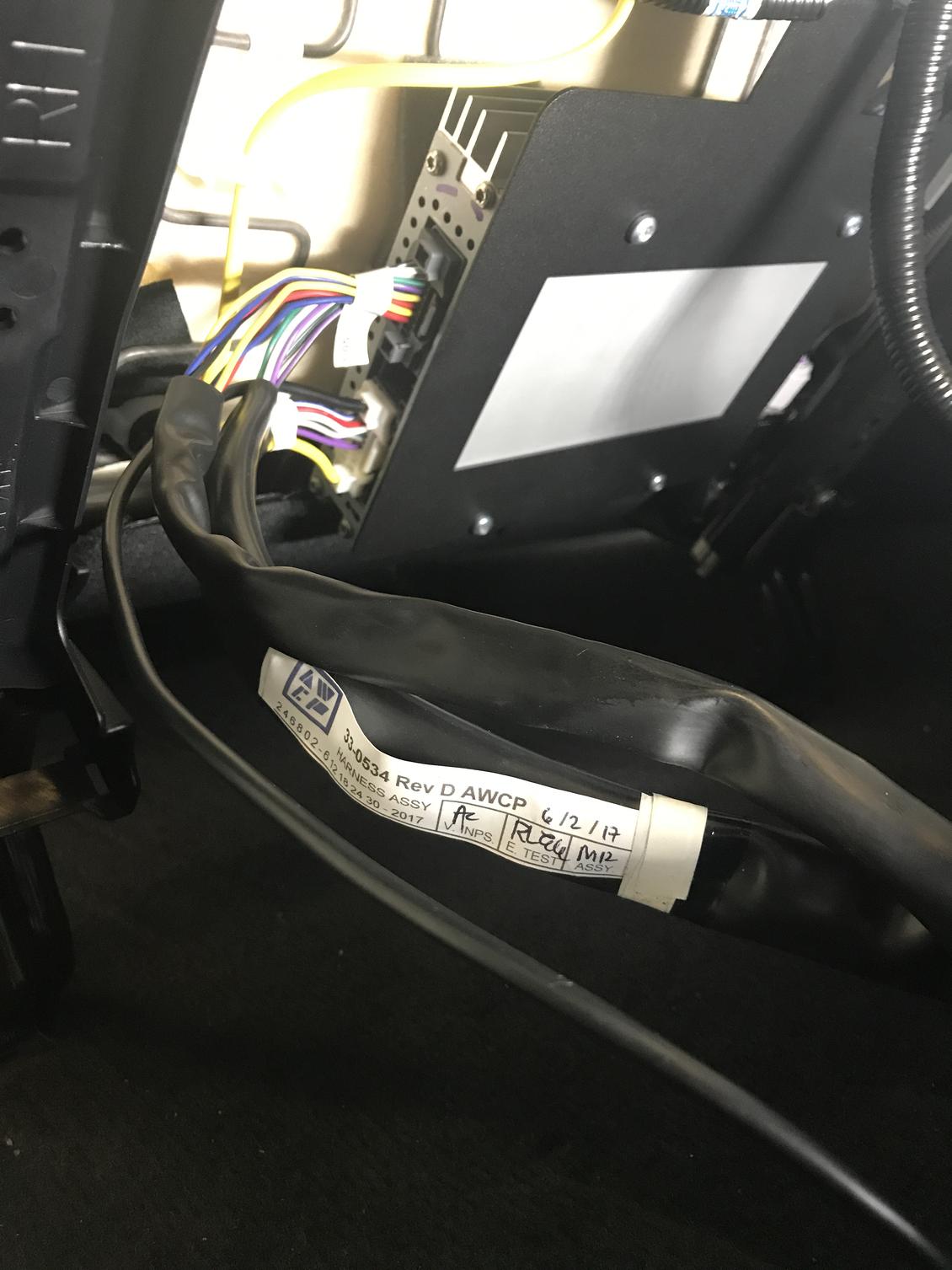

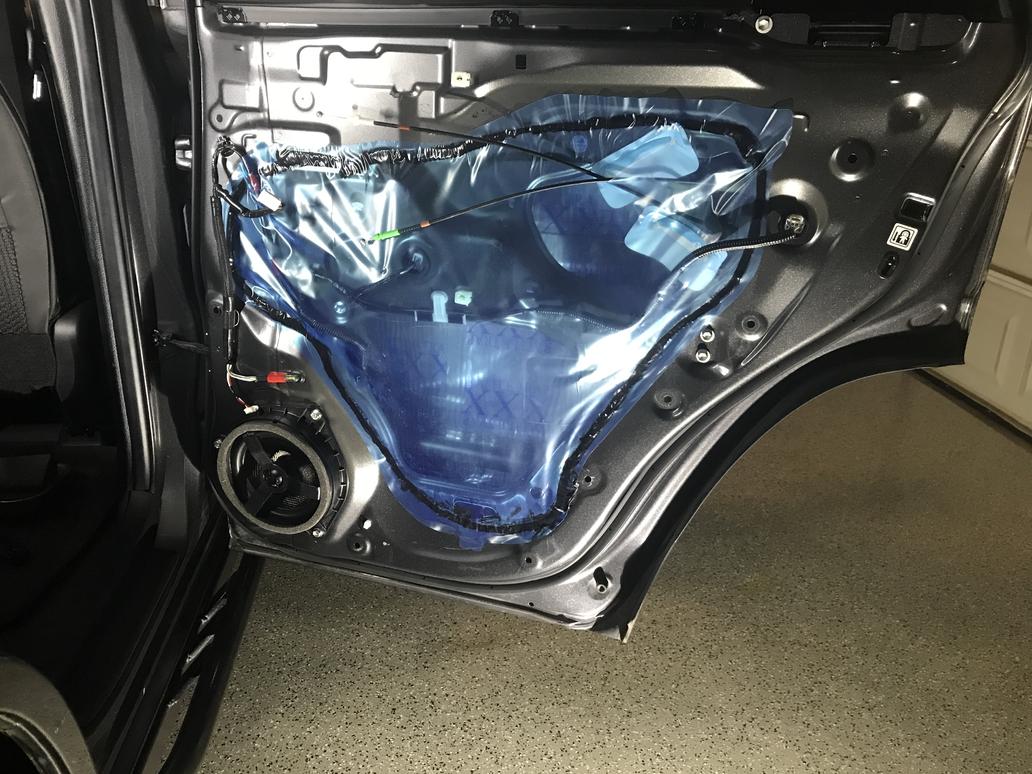

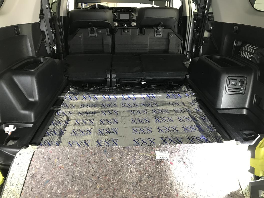

I finished up my installation this weekend. All in all I did it over about 8 hours, spread out over two Saturdays. It can definitely be done much faster, but the kiddos and wife tend to slow things down a bit. I also put down some sound proofing on the outer skins of the door, lift gate, and cargo area. I plan to do the floor panels of the front and back passenger areas at some point, but time did not permit. I debated on doing the entire vehicle, but lost motivation quickly when I read the time involved in doing so by other users on this forum.
Anyhow, as others have stated, a definite improvement in overall sound quality. I can't wait to see how things will sound once the 6X9s ship. I took some pictures along the way, but nothing that you will not find in the install video, which is great by the way.
Hope everyone has a happy 4th!
And bye bye old crappy stock speakers :-)

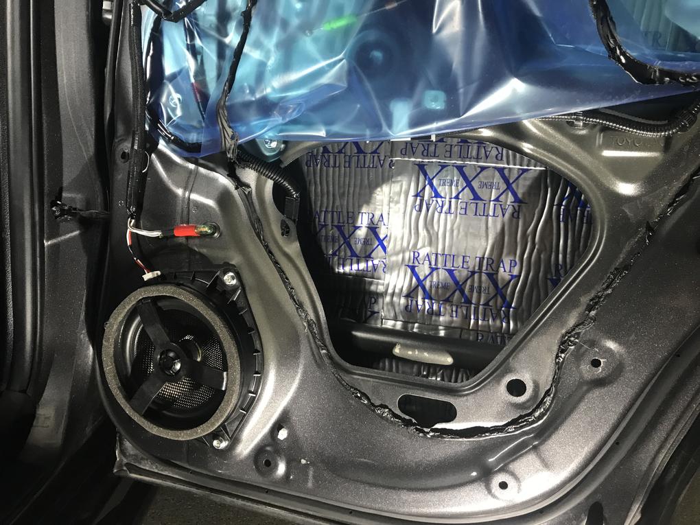

Looks good! Couple questions:
Is the sound what you expected? Is it clearer, louder?
In terms of sound padding, did u cut a basic shape and put it in or did u do sections w overlap? How much of it did you buy?
Thx
Thx
Sound is really good, better than I initially thought it would be. Much clearer - vocals are very crisp and distinct. Bass is very deep as well. I'm not much into loud bass, but you definitely know there is a sub back there.
For padding I used this....
https://www.amazon.com/gp/product/B003TUNRGM/ref=oh_aui_detailpage_o03_s00?ie=UTF8&th=1
I bought 50 square feet, which is two rolls. The material cut easily and was pretty easy to work with. I cut it into various sizes based upon where it was going. The back was just two larger sheets and the exterior door skins were smaller pieces which overlapped. To do the floors in the front seats and back seats I would probably need another 25 square feet. I did not do any of the wheel wells or ceiling.

Great to hear all the positive words about the system and service. Thanks for posting the photo of the underside of the sub enclosure, harkco. I was curious about the mounting and signal connection.
