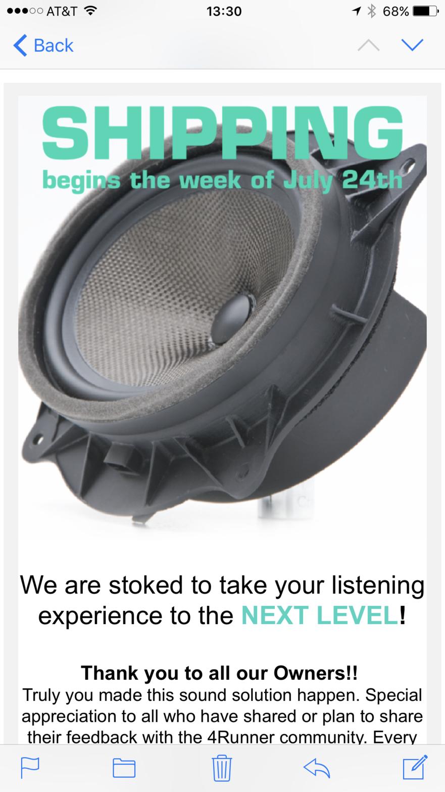

Overall very impressed with my OEM Audio + setup, ordered 6/30/17 received 7/12/17 and also received the email screenshot above with the update on the 6x9 shipping. Took me about 6 hours to install the amp and other speakers as this was my first time disassembling most of these sections of the vehicle. The Youtube installation video is quite comprehensive and easy to follow.
