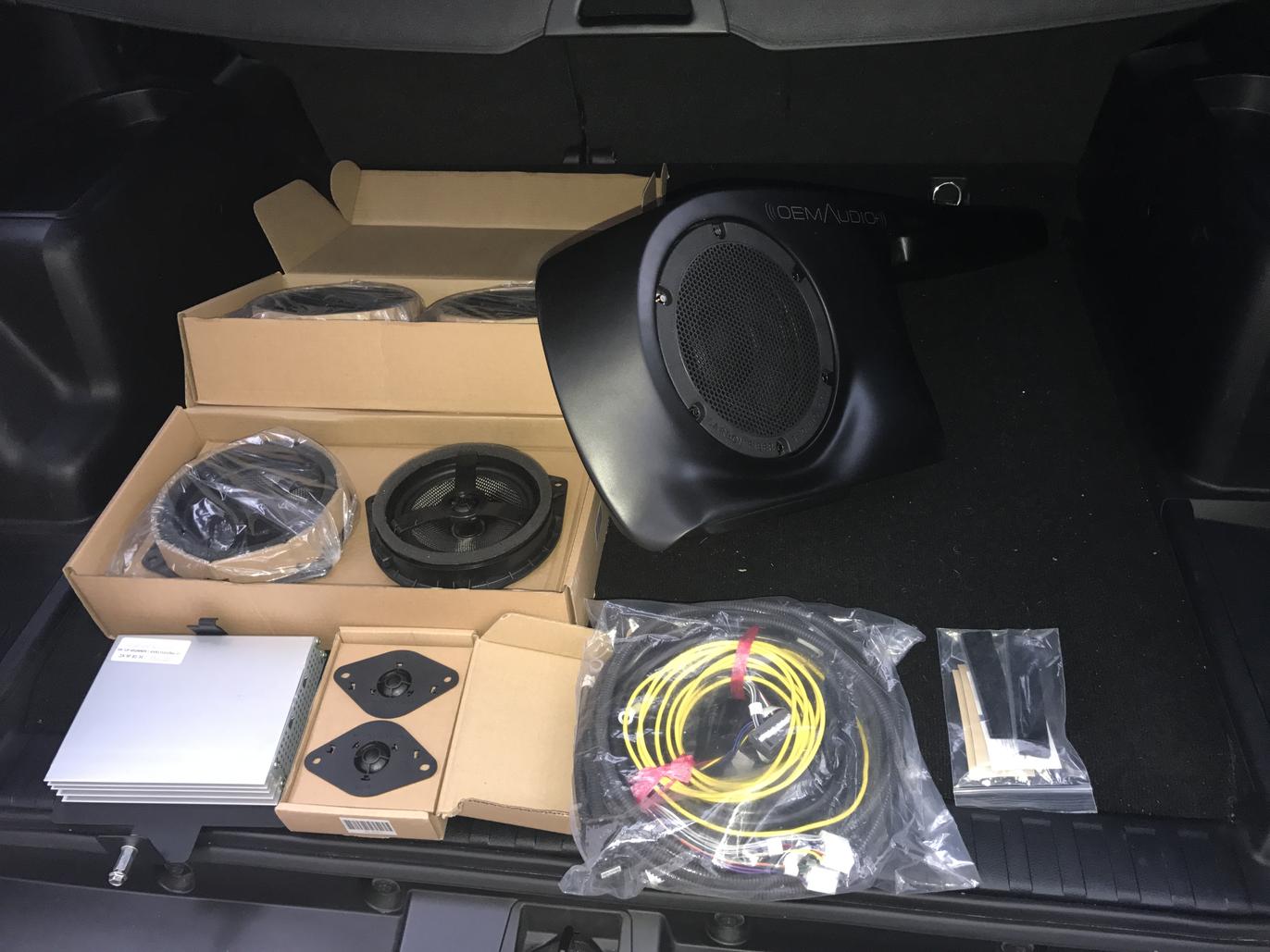

Waiting to install
Delivery came, no 6x9's yet, but everything was packed well and looks like it's in good shape. Probably won't get to starting this evening, but hopefully at least get the door speakers in this week and finish the "big" parts this weekend.
