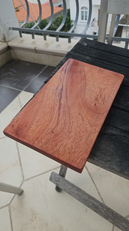

Yes, H7 works well, but the battery size is slightly shorter than original and may require 3/4"-1" tray to elevate properly (roughly equal to 19-25mm).
In my case I used an old piece of mahogany under the H7 and it fits like a glove.
