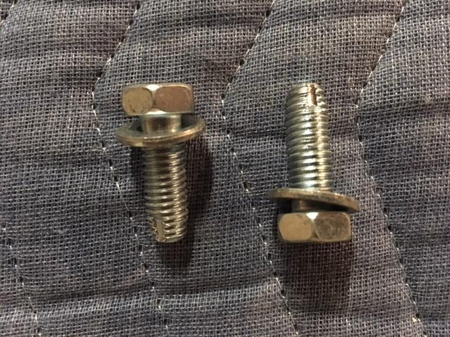

Yes, 6-12mm bolts for mounting, that is 6 for the bracket to the frame, and 6 for the bracket to the running board. I just went out and took this pic. Of a couple of the bolts. These are to the frame.
Ok perfect - and via your signature we have the exact same truck.
So - pull the OEM 12 bolts. Wife holds up the running board. Bolt them on using the OEM hardware. Torque. Drink beer. Thank posters.

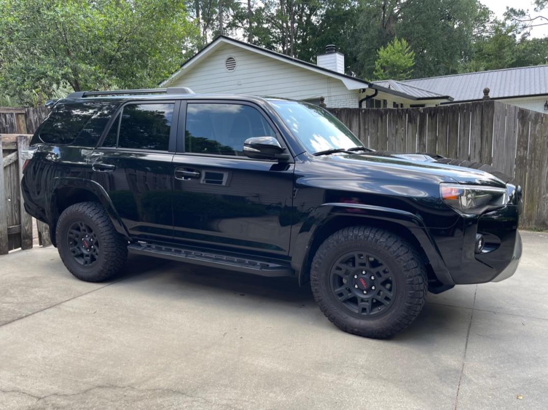

2021 Limited running boards
Just bought this midnight black 4runner a month ago. Quickly found out my 79-year-old mother-in-law can't get in very well. Looking for suggestions on brands to consider. Obviously, a good grip when wet is important, but I don't want to lose too much clearance at the same time. Anyone have any "definitely don't buy" brands?

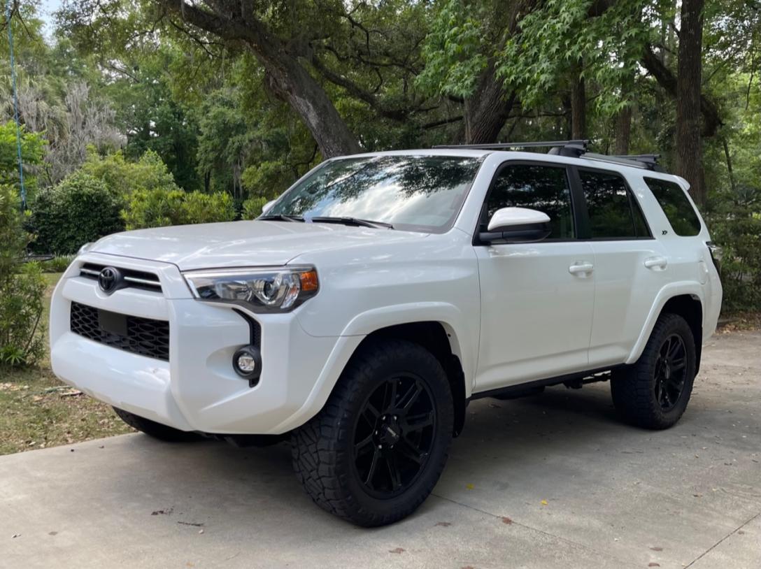

This thread was very helpful! My ‘23 XP series came with running boards, and I hated them. I’m 6’3” and all legs, so the step was purely in the way. However my MIL is tiny, so this morning I dismounted mine and installed them on her ‘21 TRD. We are both happy with the result! Yeah I’m a little jealous hers is 4WD…
