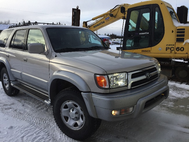

Tacoma Wheels
I found some Tacoma wheels 2 months ago and after a month of cleaning and deciding on tire sizes, i finally had them mounted yesterday and i couldn't be more happier. Thanks to everyone who gave me their opinion on the tire sizes and how they have worked out for them. I ended up going with a Michelin 265/70/17. Next will be the Tundra Brake Upgrade. Once i have a chance to clean her up, i will get some better pics. This was a quick phone pic after cleaning the blue off white letters and before the rain came. Thanks to 4BUMR for the tire info about his size.
Before pic

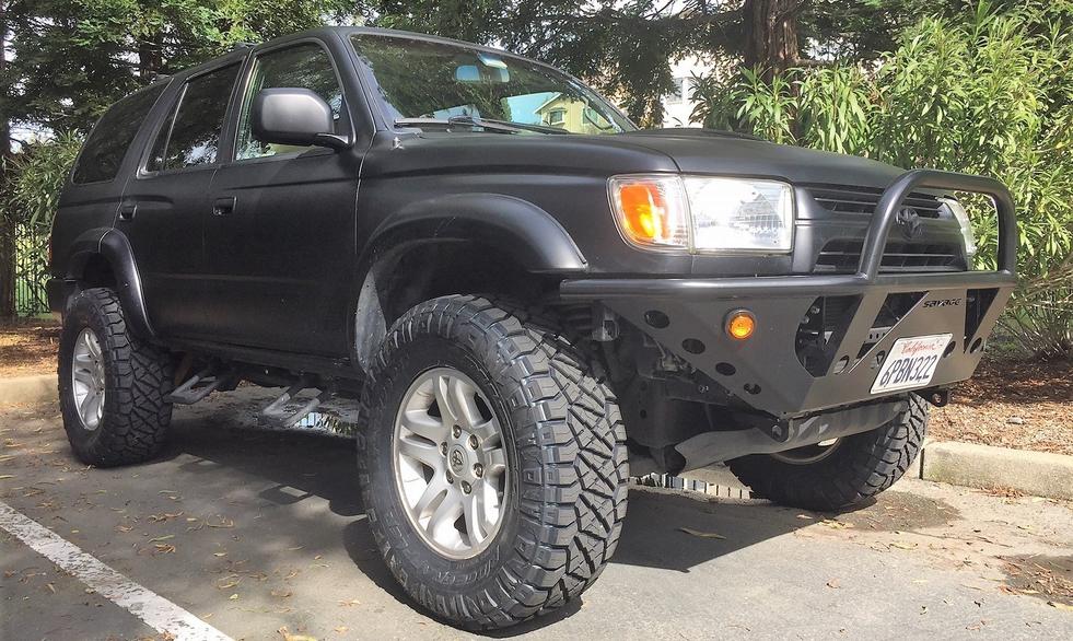

Split 5-spoke
Tundra/Sequoia split 5-spoke with Nitto Ridge Grappler 285/70/17 using OME suspension 1.5"-2.0" lift with 1" Toytec Body lift and 1.25" Wheel Spacers.
