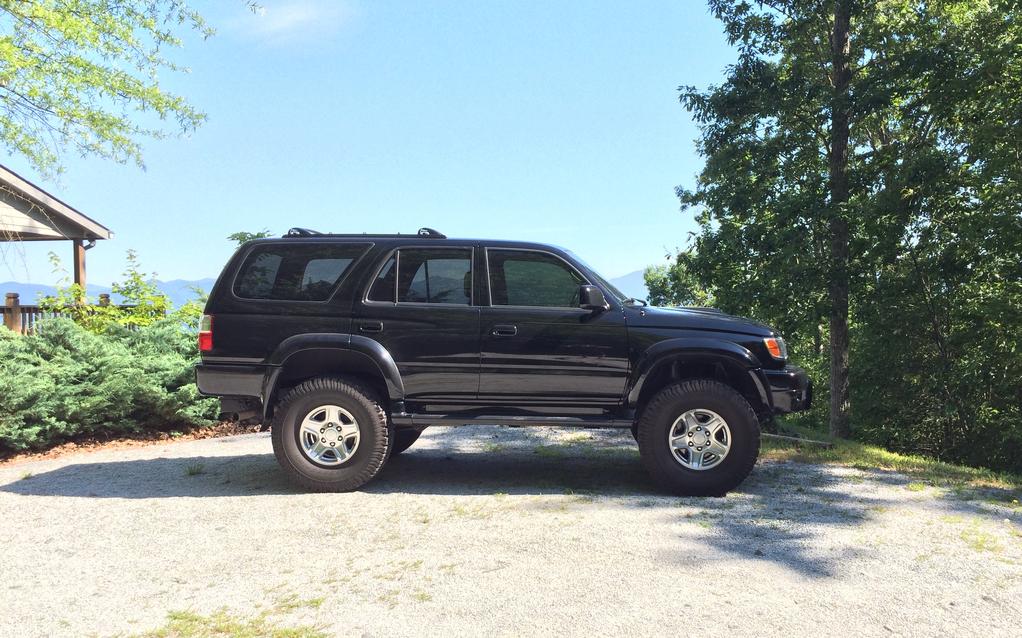

Would regularly browse this thread ever since Bandit Runner started it. I installed my BFG KO 315/75/16 about a year ago. Went from Goodyear 265/70/16 to BFG KO 285/75/16 & now the 315s.
SPC UCA allowed me to fit the 315s without any modifications to the wheel well but I did rotate the fender flare on the front bumper slightly forward for another .5" clearance. I wasn't rubbing the flare but a friend suggested it & offered to do it for me. However, I was occasionally rubbing on the front end caps on the stock running boards at full lock but after trimming the end caps I no longer rub. I realize I am one of the few that like the stock running boards.
- What wheels are you running? stock 5 stars
- Do you rub the frame at full lock? Yes
- Do you rub the wheel well? No, with daily driving & fire roads
- What specific tire size and brand are you running? 315/75/16 BFG KO
- Do you rub the UCA at full drop? No, SPC UCA on G setting
- What's my Caster on the G setting? 1.5 driver side, 1.7 passenger side
- How's it drive with 1.5 & 1.7 Caster? Very similar to when I was on the D setting with the caster within spec DS 2.5 & PS 2.7 & my steering wheel still self centers on turns.
- Why did I choose the G (lowest caster setting)? I would get occasional rubbing on the pinch weld on the SPC recommended D setting with caster in spec. After a lot of experimenting, the G setting eliminated the occasional pinch weld rub and didn't compromise handling.
- Are you running wheel spacers, if so how big are they? Yes, .75 front only
- Are you running a body lift, if so how much? Yes, 4crawler 2"
- Why did I choose a body lift instead of modifying the wheel well? Want to avoid irreversible mods
- What are my center hub to fender measurements without the 2" body lift? Front 22.25" & Rear 23.25"
- Auto or manual, and what gears are you running? auto, 4.1 I think.

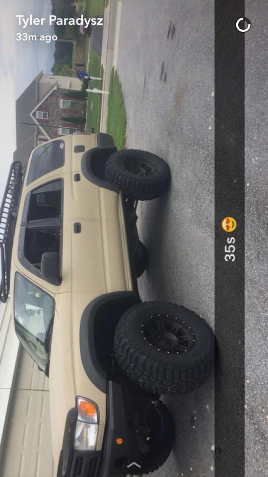

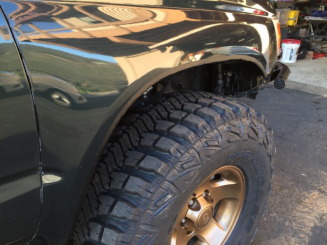

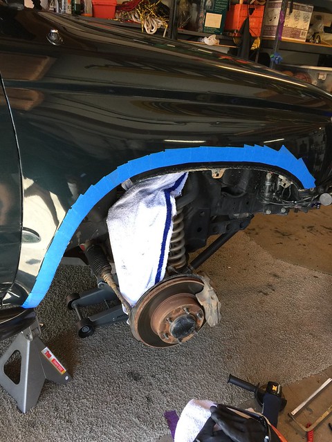

Had to move the washer fluid reservoir and I hit a lot of other things with a hammer. Cut about 2 inches off my fenders. A lot of stuff
Connor, you mind posting a picture of the fender after being trimmed? I know you don't have rust problems in CA or AZ like I do in UT, but did you do anything to protect the paint? My last runner had flares, so I didn't worry about how it looked, but I won't be running fenders on this next one. Feel free to message me on IG if that's easier too.
So I cut upwards and then folded the tabs over. Then I sanded the edge and sprayed it with bedliner. Make sure you cut a lot near the firewall area. There are 2 bolts holding the fender on right there, I cut in between the 2 bolts and now only have one. #clearanceislife

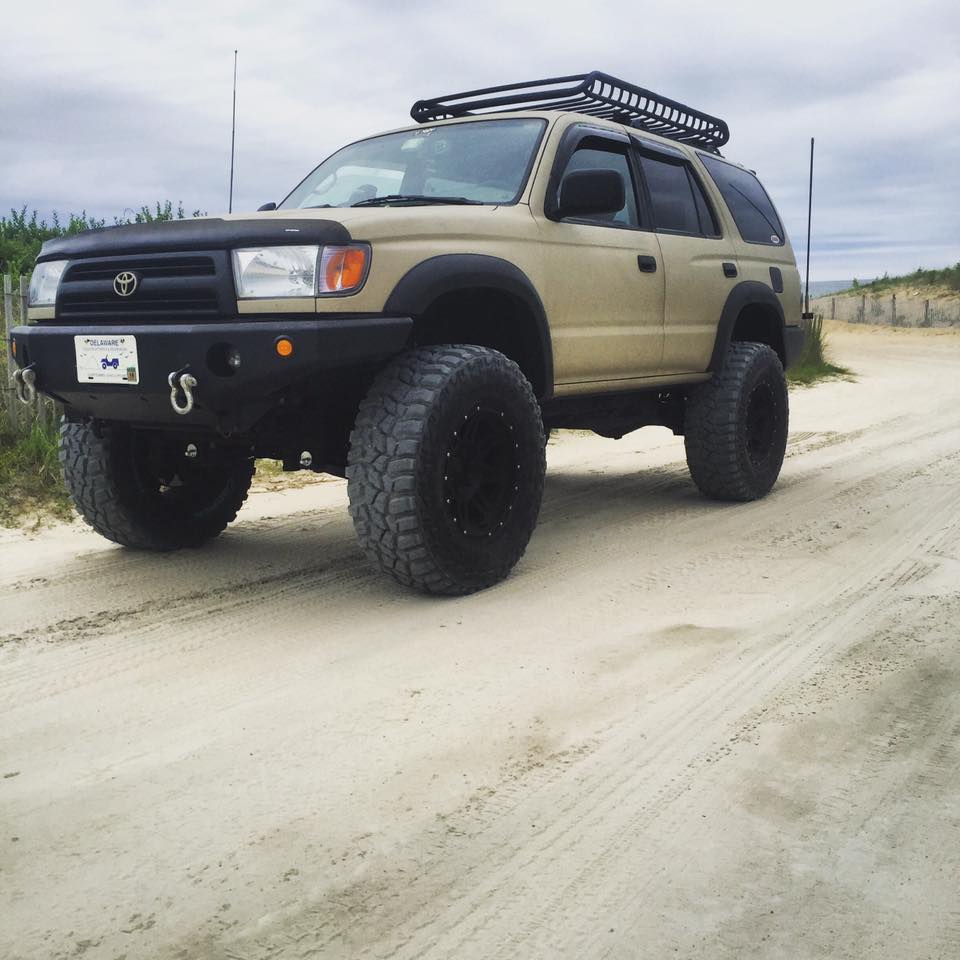

im in the club now 315/70/17
procomp 7005 with 4.75" bs -6mm
cooper discoverer stt pro
spc upc
new lower oem control arms
rub at full lock on the flares got a good bit of trimming to do now

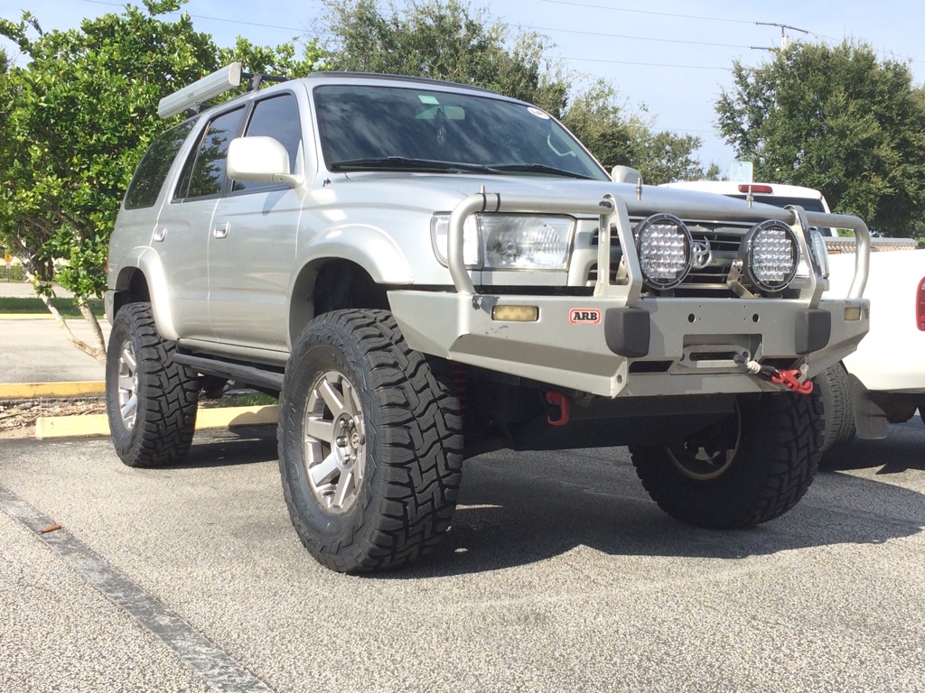

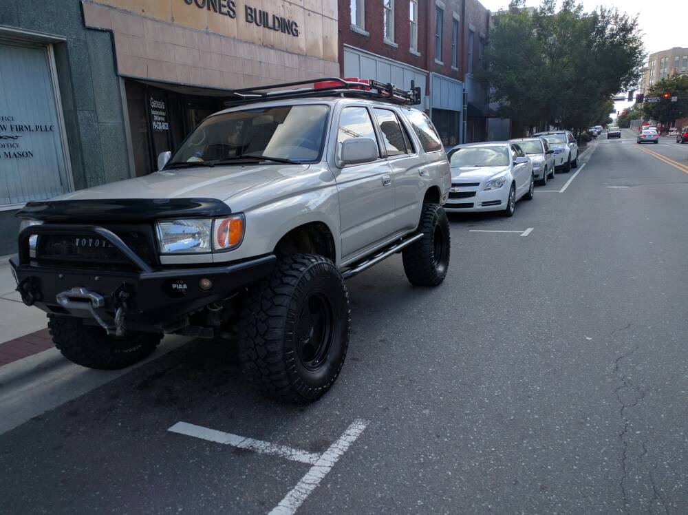

Joined the club, wondered why the hell I had not done this sooner.
2002 4R Auto 4.88's
Wheel spacers: Yes Spidertrax 1.5"
Body lift: Yes 1"
Front Lift: Swayaway co's + 1/2" top out spacer.
Rear Lift: Toytec could + OME trim spacer
Wheels: 4R Trails wheels
Tires: Toyo R/T 35 12.5 r17

Do you have a pic or 2 from the side? I have been wanting to see these wheels wrapped in 35s on a 3rd gen
How much do u have to lift them to b able to run a 35 under a 3rd gen. Just got one and wanting to lift and run 35s

Research. There are threads for this. Be ready for some work. IMO for 35s you need 3"+ suspension lift, 1.5" body lift, SPC UCA's in the G position, 3.5" BS wheels. This will get you riding pretty nice. But you will rub off-road. Next step would be cutting, welding and hammering the firewall to clear the tires.
