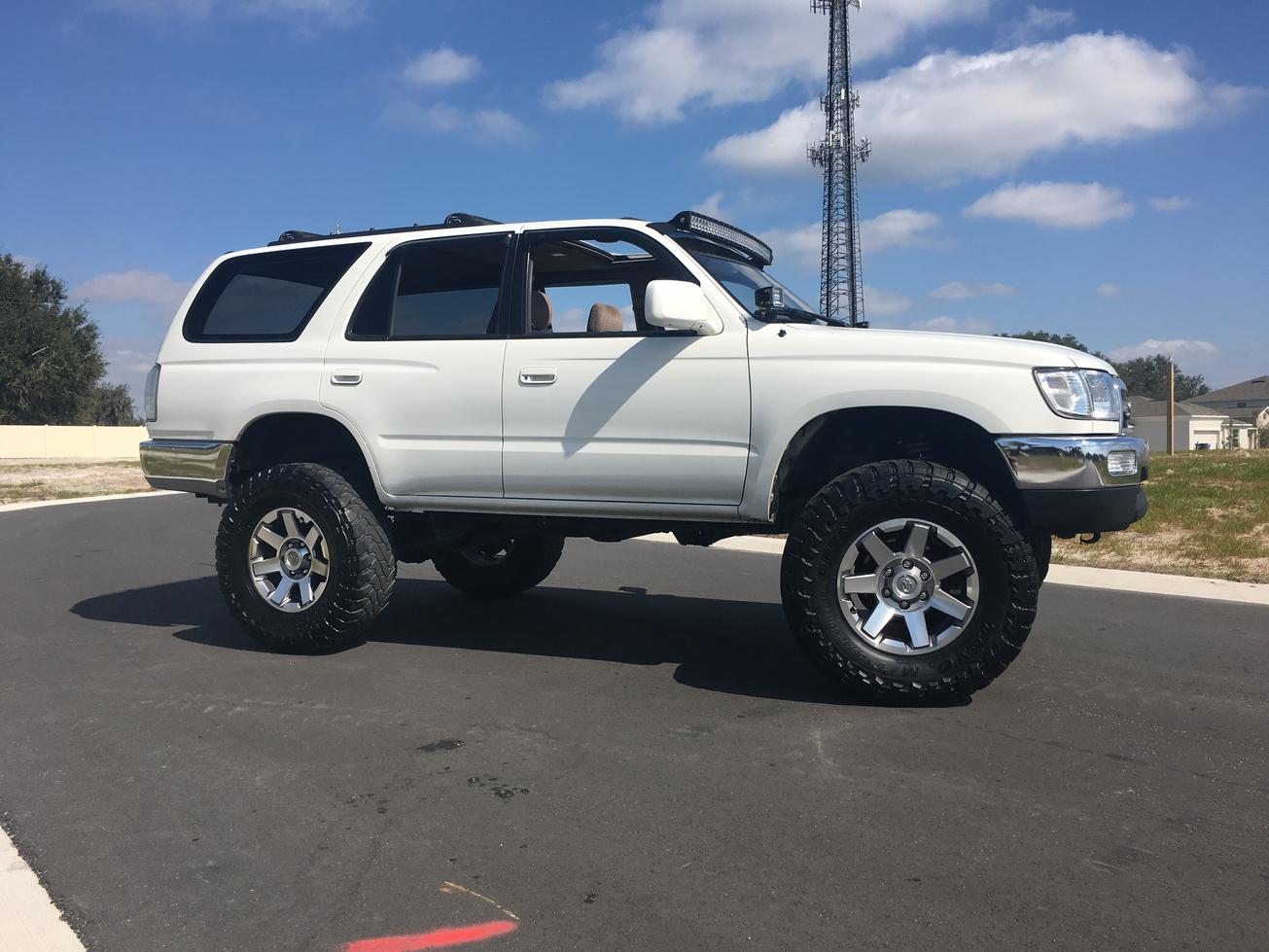

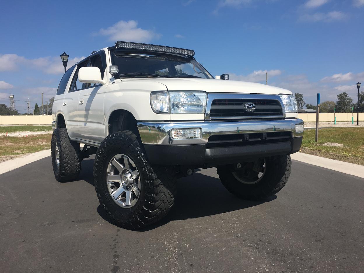

Can finally join the club :guitar3:
35x12.5 Toyo MT on 5th Gen Trail Wheels with Spidertrax 1.25" spacers
Now to fold the pinch welds, trim the valence and a small body lift.
Just need to regear next

what lift are you running, Man? Truck looks amazing.
Thanks Man!
Here's my setup. It rides great and is not rough at all with these E Load or the P-rated street tires I had. Would highly recommend.
Front:
Tundra Bilstein 5100s
Eibach 3 inch lift coils
Set on the second perch
Rear:
4th Gen 2 Inch Lift Bilstein 5100s
LC 8 Wraps
Hub to Fender:
F: 23 3/4"
R: 25"
