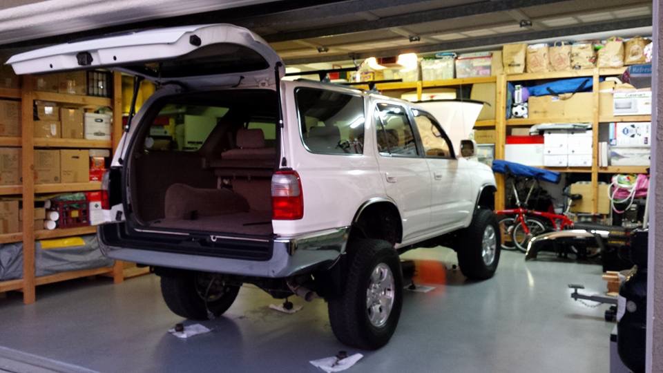

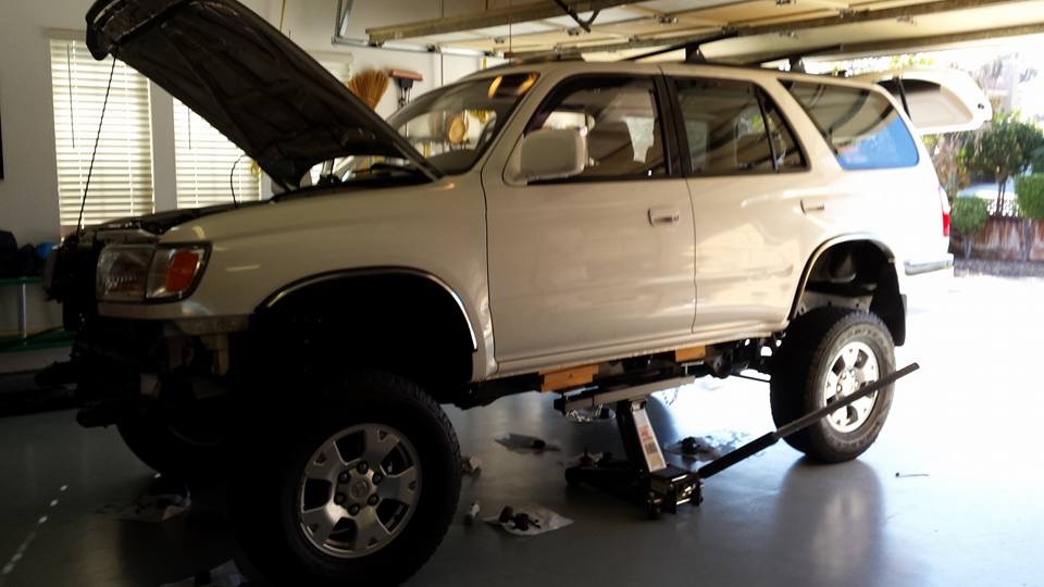

Timmy's Dec 4 mods schedule
Admittedly I am not the fastest worker at this stuff but when I did my BL that alone took me 5 hours. For a rig to also undergo a suspension lift and a TBU that's pretty aggressive to get done in a day IMHO.
