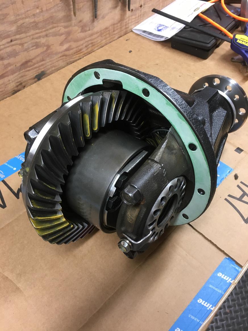

[MENTION=120071]mtbtim[/MENTION] and I helped out a fellow member with a 3rd member install with a limited slip diff and replaced his AXLE seals. we got to use some new tools and of course a video will be out soon detailing how to remove and replace a 3rd member and press in bearings/sleeves for non-ABS rear ends

[MENTION=120071]mtbtim[/MENTION] and I helped out a fellow member with a 3rd member install with a limited slip diff and replaced his AXLE seals. we got to use some new tools and of course a video will be out soon detailing how to remove and replace a 3rd member and press in bearings/sleeves for non-ABS rear ends.
That fellow member was yours truly! Thanks a bunch to Sean and Tim for their time and energy and the impetus to get this job done. I had a great time wrenching with you guys and am very pleased with how the project turned out.
Couldn't remember your screen name for the life of me!
How's everything been feeling over the last couple days? No leaks?
