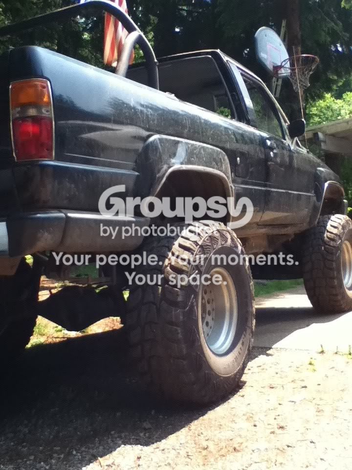

Here is the SS Minnow on 33" BFG Mud Terrain KM's lifted by the OME 2" kit with ball joint spacers from Toytec up front.

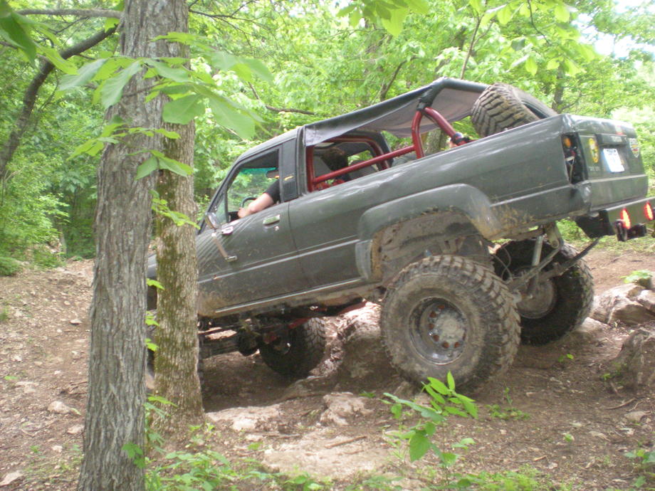

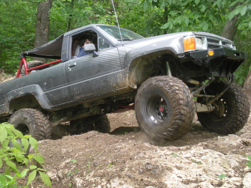

1987 SR5 Bissonsaurus. 22RE. Auto. Double top shift transfercasess. CroMo Low gear set. Homemade CV driveshafts: Front is square tube; the rear is stock Frankenstein with long travel slip joint. Home made or Bud built cross member and skid plate ( I don't remember which truck has which). Home built Solid axle swap. 52 inch leaf springs. Yukon Gear lockers. CroMo axle shafts. Lower gears (don't remember ratio). Home made front and rear bumpers. Homemade roll cage (EVERYONE RUN). 4 point racecar seatbelts. 35/12.50 R 15 Bajaclaws on 15 /10 rims. Spidertrax spacers on front. some long shock absorbers and a steering stabilizer.... About a hundred pounds of welding wire....

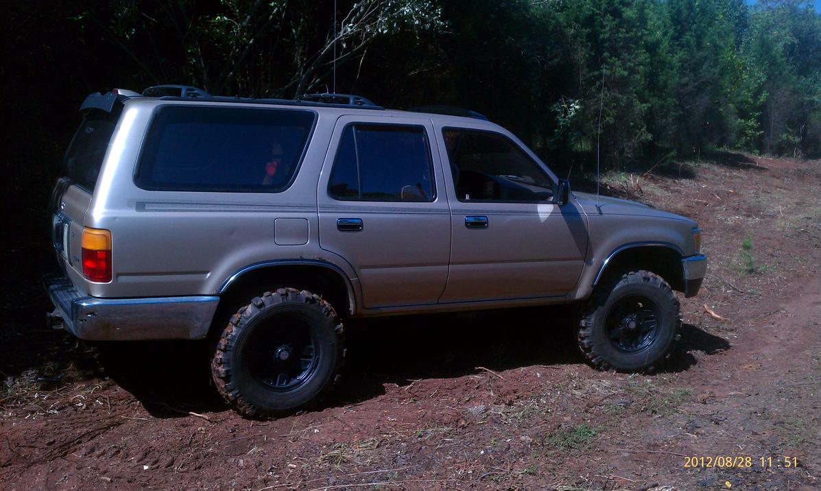

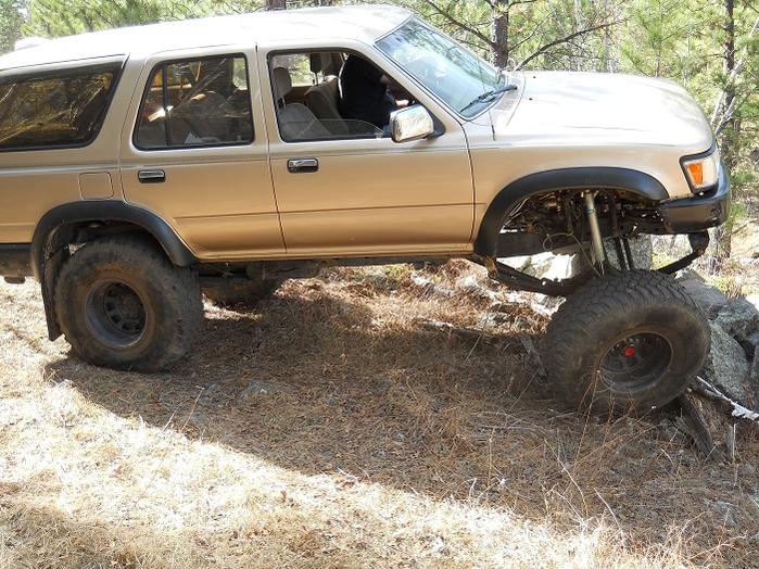

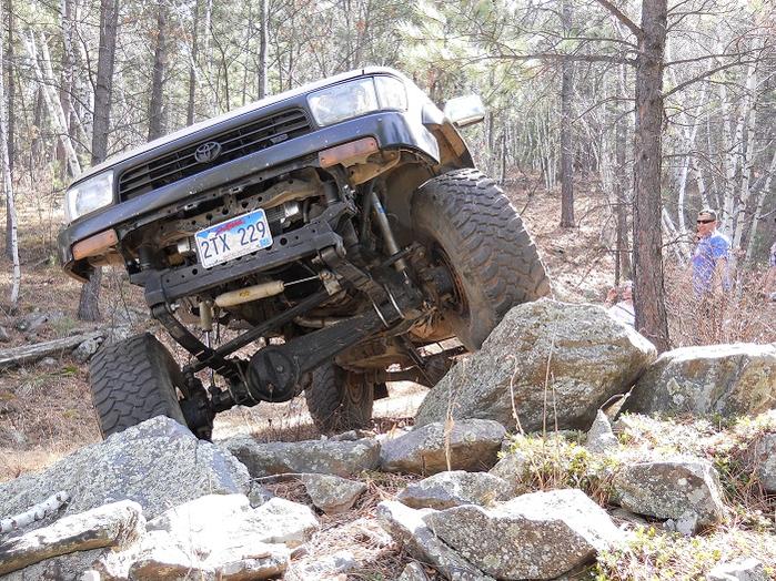

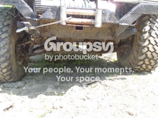

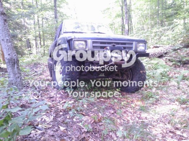

87 4runner. No lift, upper bumpstops trimmed, swaybar removed on 31s

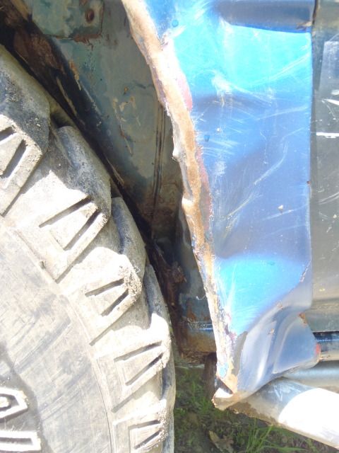

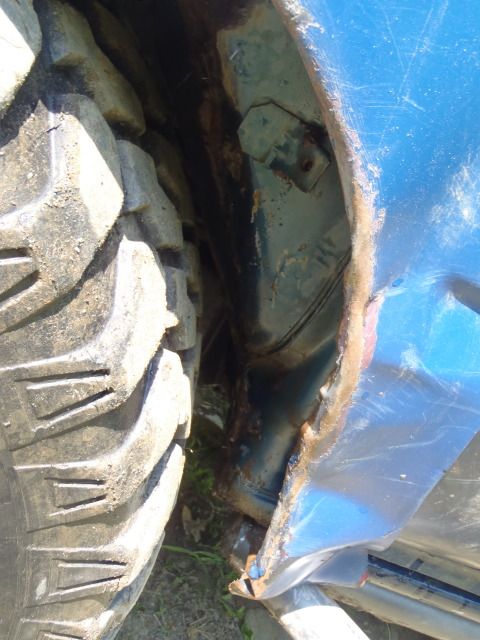

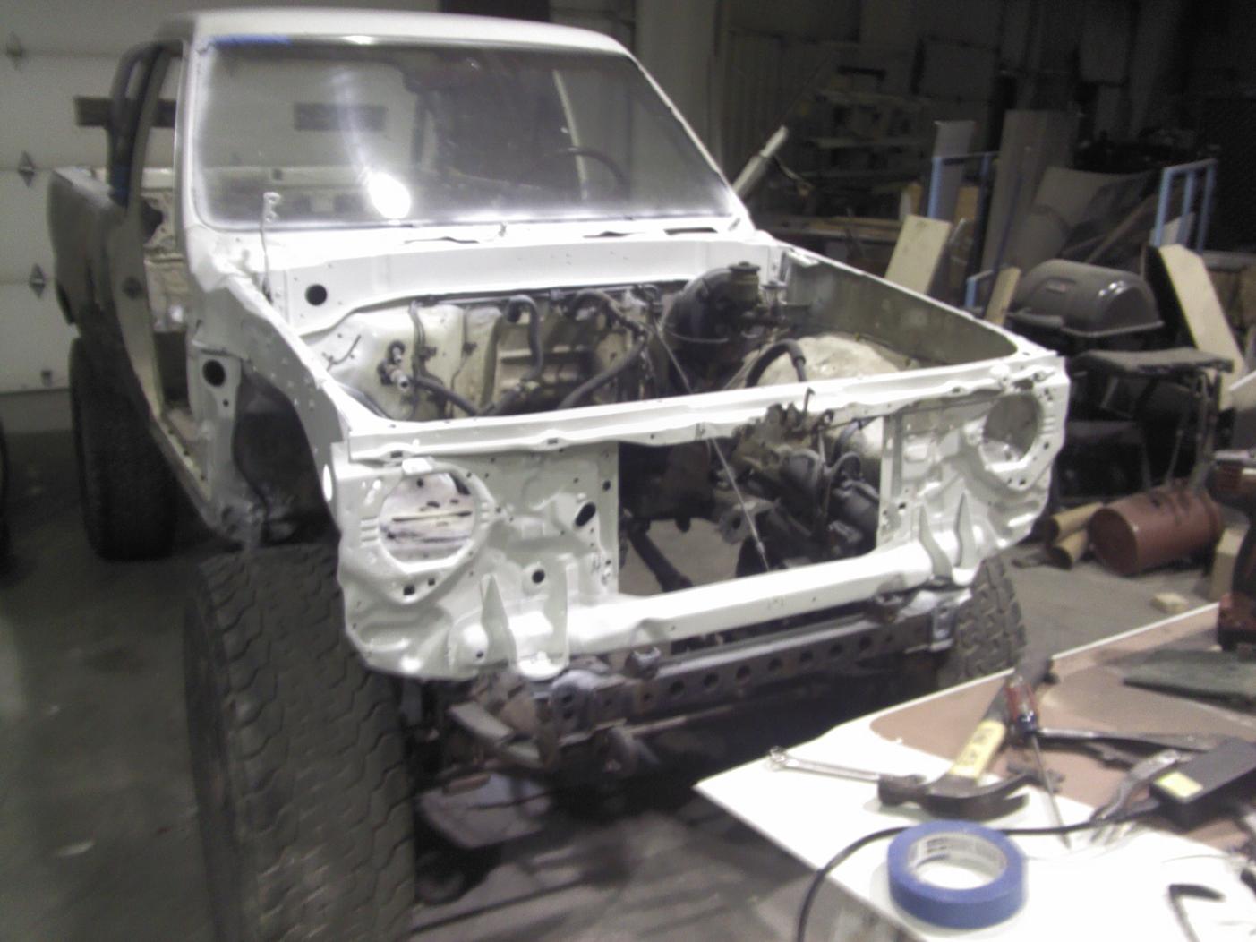

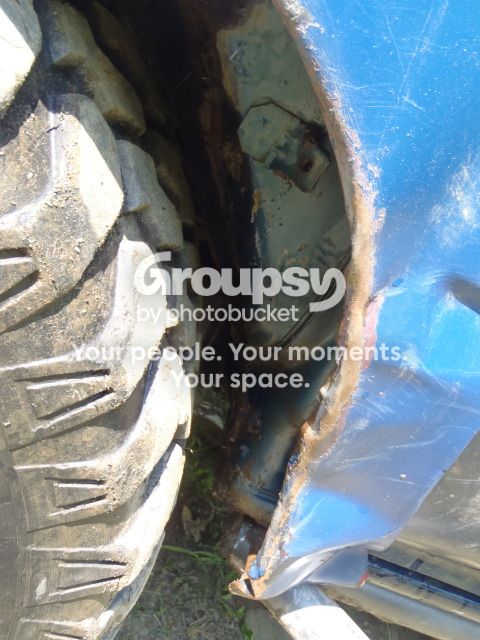

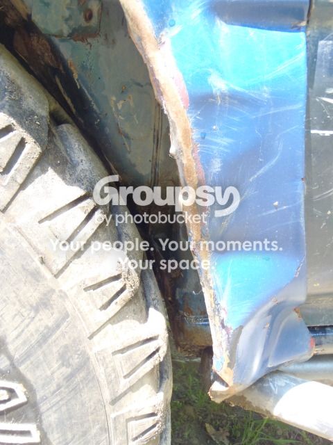

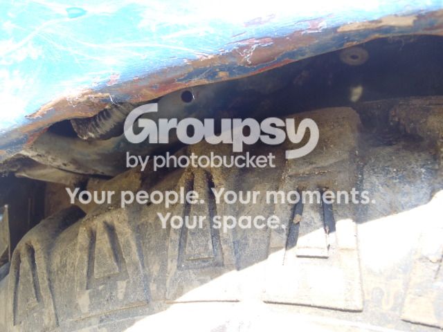

92 "2nd gen" No lift, upper bumpstops and swaybar removed, 2-3" fender trim, semi-tubed firewall, on Pro-comp M/Ts 35s
temporary-54.jpg~original
temporary-60.jpg~original
P5261102.jpg~original
P5261103.jpg~original
Stuffed with the wheel straight, no rubbing
P5261108.jpg~original
Stuffed with the wheel turned, just barely rubs

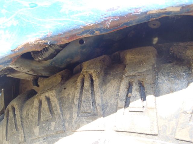

P5261107.jpg~original
Stuffed turning in, also just barley touches, but its smooth so its not hurting anything.

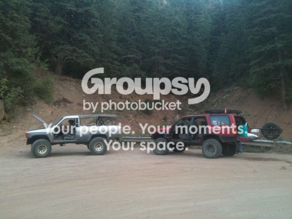

Most guys here know what runner is mine but for those that don't, it's the superior gray one in front of the red hooptie :D
Lift is a front end of a Rough Country bracket lift which is about 4", the torsion bars have been relaxed a bit to lower it a little so it's probably about 3". The rear is a trail-gear 4" lift with the spring packs bas****ized to lower the rear and soften the ride so it's probably about a 3" lift. Tires are 35x12.5 KM2's.

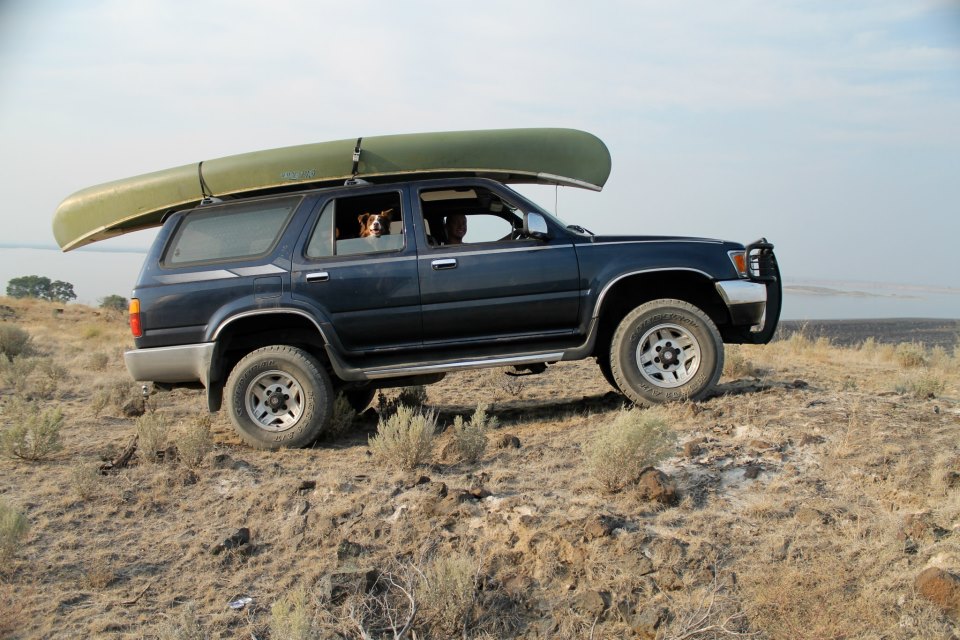

1994 4Runner 3.0L 5-spd on a 2in OME lift on 30's at the moment

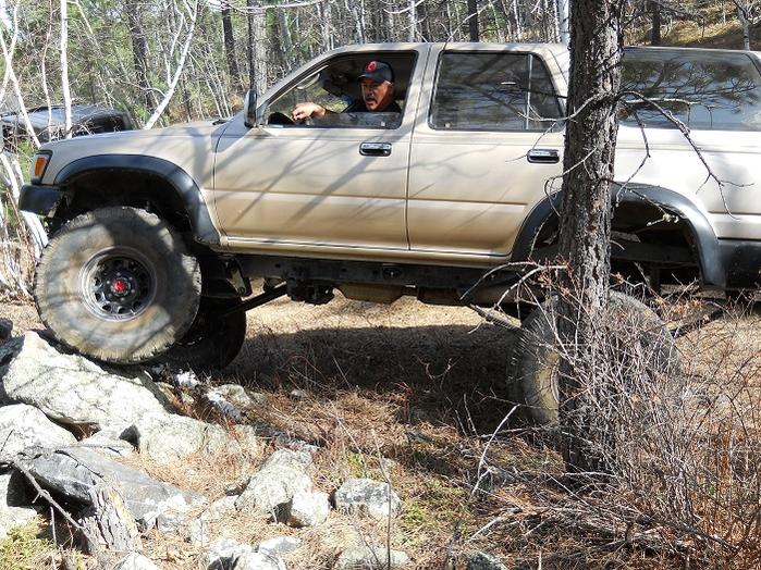

Mine has a 4" rough country + add-a-leaf and tbar crank (2-3")+ 1" bl for around 7" or 8" of lift. I run 36x15.5 Baja ATZ on 15x10 Rims with a nice amount of room for flexibility. You don't need as much lift as I do to clear 36x12.5's... mine are just stupid wide and leave me less room to turn.
