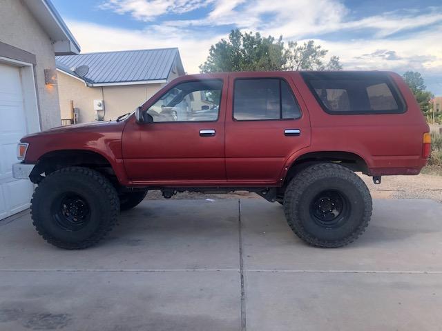

finally
took some time and some digging, but its almost there.
ended up installing :
- 2.5" ball joint spacers
- Bilstein 5100 in front
- Bilstein 5125 in rear
- sway bar drop kit
- ZUK mod coils from a friends 5th gen 4runner
finally settled and sits just how i want her with the nose 1/4" higher than the rear
just have to find time to install the diff drop kit
- sway bar drop kit
Your 4R looks very good!
What Bilstein 5100 length did you install in front?

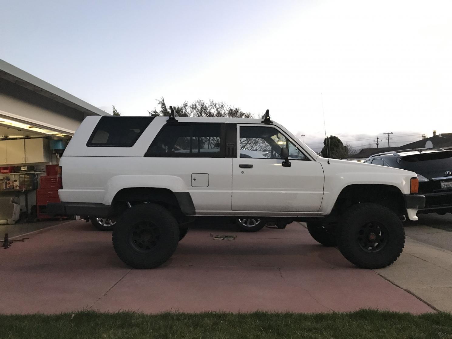

1994
No suspension lift
1" body lift
1" trimmed off the fenders
Beat the schnitzel out of the fender wells
Removed running boards, rear bumper and the plastic crap on the front bumper
Cut and flattened the pinch weld where the rear bumper used to be
35x12.5r15 Cooper mud terrains
15"x10" Cragar wheels -38mm offset
Warn manual locking hubs
Knock sensor bypass
​​​​​​​Electric cooling fan

1994
No suspension lift
1" body lift
Knock sensor bypass
