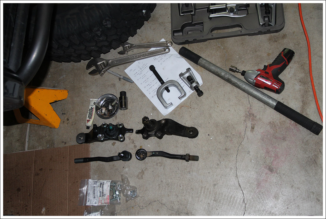

In the past I've put the castle nut on and hit the sides of the tapered joint with two sledge hammers, this knocks it loose and puts no stress on the bolt. This time I used two tools from the OTC front end service set (http://www.amazon.com/OTC-6295-Front-End-Service/dp/B0002SRH7O).

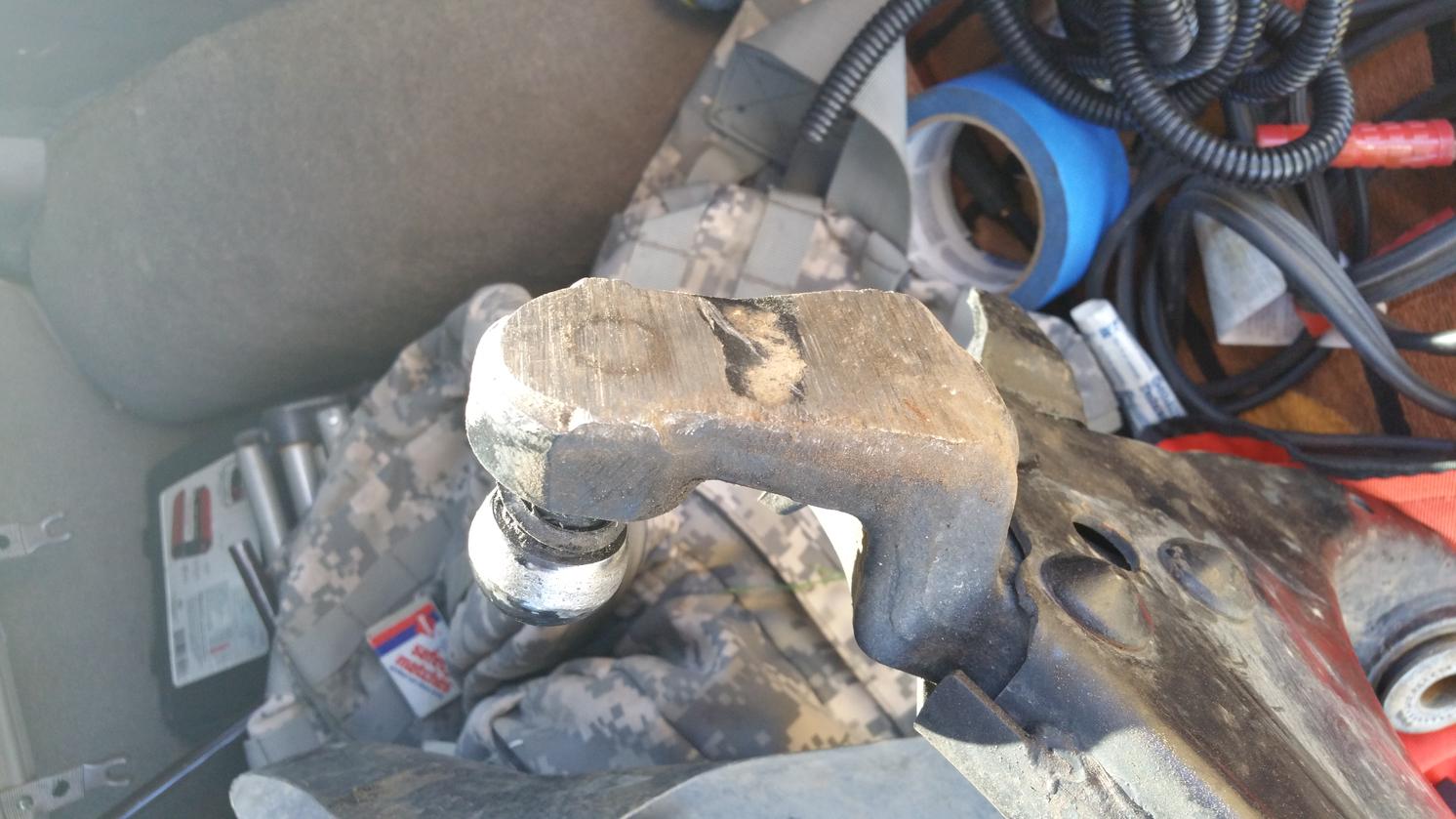

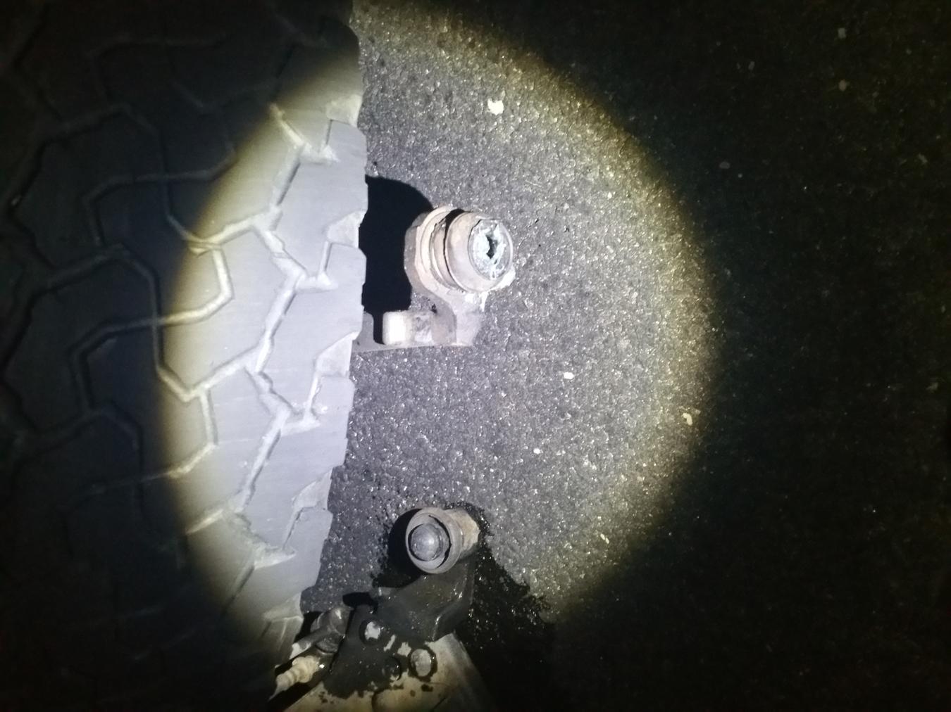

Just wanna add some of my own pics, this thread is great since a lot of people seem to be having ball joint failures lately.
I was also doing 55 when this happened ( bottom Control arm grinded away)
