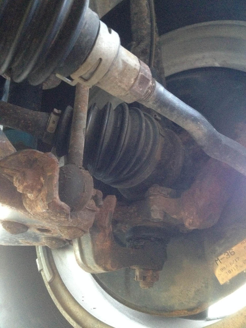

Hi - first, let me thank everyone on this forum for your great insights. You have helped me buy my first Toyota 4Runner -- a 3rd generation 1999 4Runner Limited, with 160,000 miles on the V6 engine. It has the locking rear differential and all the other goodies. I've had it 4 days and just love it.
I have most of the service records from the life of the vehicle and everything is looking good -- except, I don't see any mention of the Lower Ball Joints, and these photos scare me.
So, here is a photo of one of the LBJs (this one is the right side). I think I understand that Toyota came out with a new improved version of the lower ball joint -- I'm not sure which is on here, the old scary version or the new safer version. Can any of you help me identify this?
Thanks in advance.
Joe
Grand Rapids, MI
They're all the same afaik. Yours look to be leaking a little. Keep an eye in them and replace when you get the chance.
jsindorf;2129581 these photos scare me. So said:
Welcome!
So there is no redesign that I am aware of. I have heard (now that's still speculation) but the Tacoma ball joints are stronger.
Yes the boot is leaking a small amount, nothing to be real worried about.
On the first page I have a description of how to check your ball joints. I would advise you do that and see if there is any play.
Good luck and enjoy the truck.
Thank you -- just wondering however, you mention the "leaking" as a symptom of wanting to change the ball joint, but the photos I've seen have been catastrophic failure of the metal casting itself -- the arm, not the joint... or am I mistaken?
Tacoma ball joints are identicle in the area that can fail (the ball joint itself). They are thicker / stronger where the tie-rod attaches which does not fail. Also, if you upgrade to tacoma LBJ's, you have to change to tacoma outer tie rods. And... you loose some turn radius. So overall, not a worthwhile upgrade.
