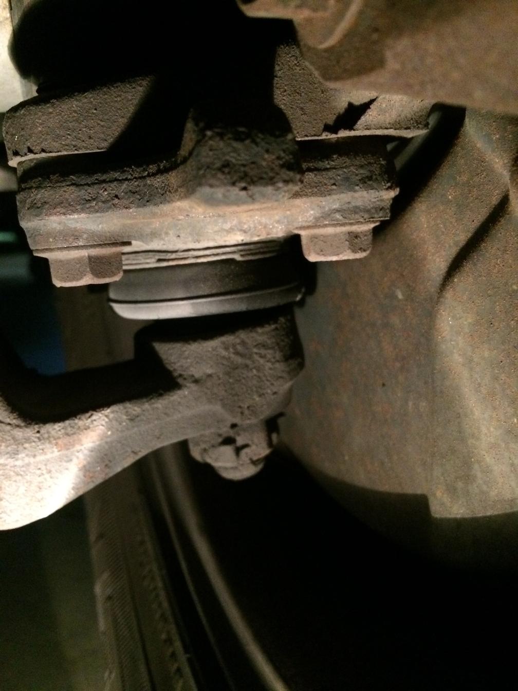

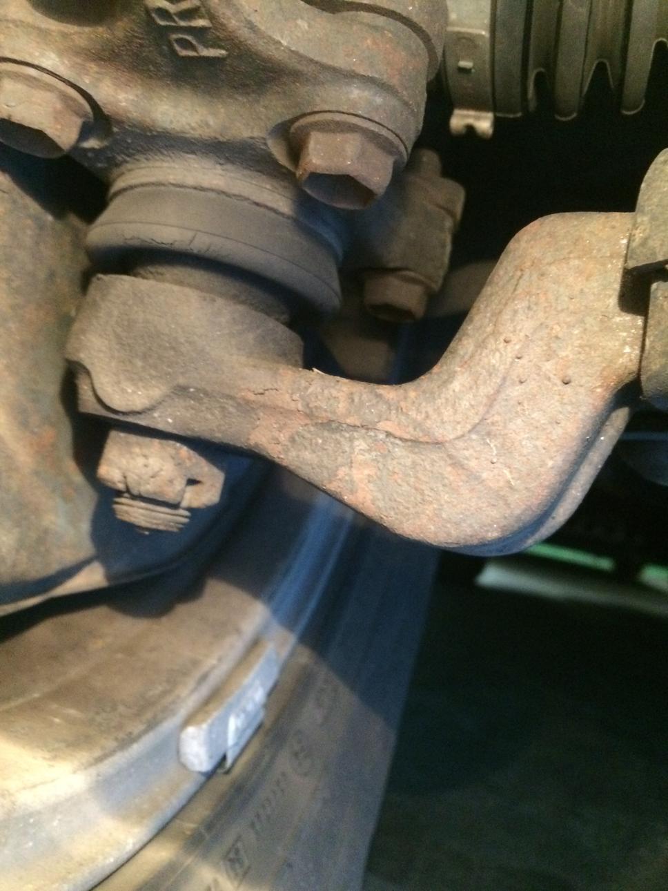

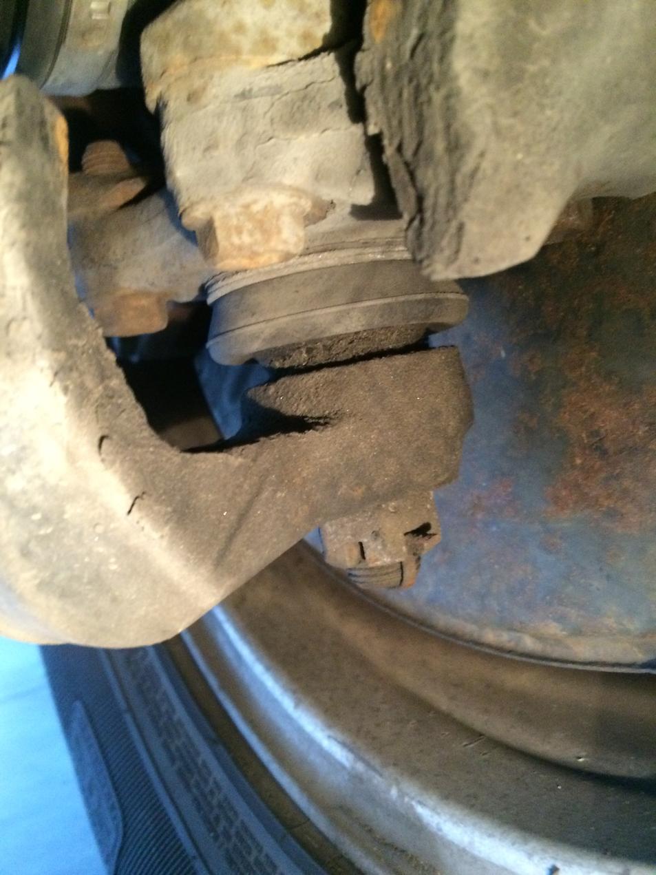

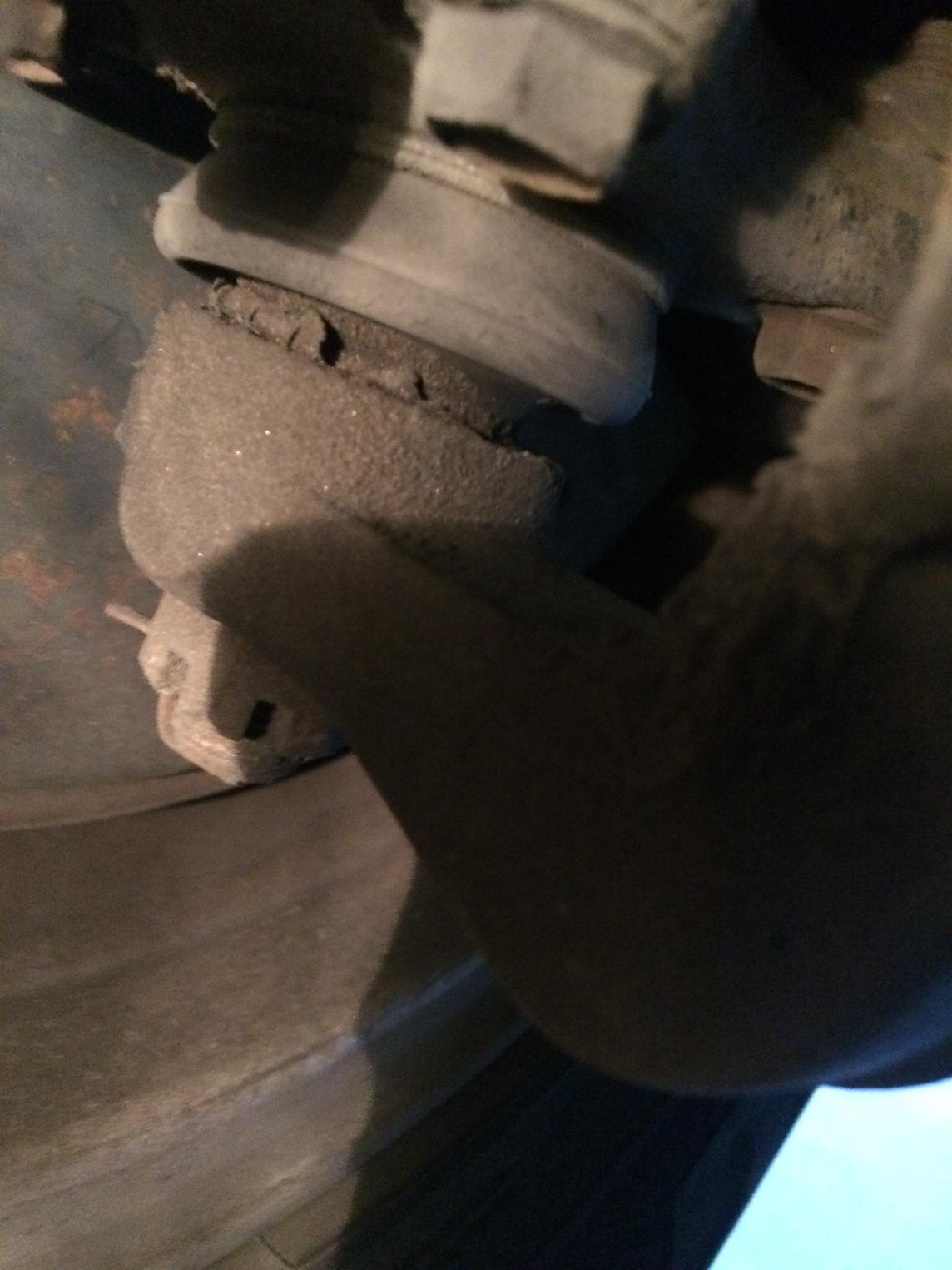

Can you all take a look at these pics and let me know what you think. They are a little crusty on the back sides but seem fairly solid. I did the test of jacking up from the control arm and prying on the LBJ directly as well on under the tire and didn't see any noticeable movement. I was just using my tire iron (all I had) and will try again later with longer pry bar.
I picked up this '97 not lifted with 222K. The previous owner bought it at 208k but didn't know if the owner before him had them replaced the LBJs. Overall everything looks fairly clean and I can post some other suspension pics if that helps with anything.
This is one of those things where most would agree to just replace them with OEM cause then you will have piece of mind in knowing they are new. And for the price do stick with OEM. Order from Camelback. Be happy.
I hear you on that and in the end that's likely what I'll do. I'm always hesitant to replace a part that seems to be in good condition and for all I know they replaced once already. That said, I'm not an expert here so maybe these aren't in as good of shape as I think. Still I had zero movement on them.
I can see the boots are dry rotting, and based on their overall look, I'd bet they are original.
I will say I recently replaced my original LBJ's, that had almost 100k fewer miles on them. I didn't think they were too bad, while they were still on the 'Runner. After I removed them, I was shocked at just how bad they were. I can't say when they would've failed, but it does drive much better, and the peace of mind is priceless.
You really need to test them, and just inspect the rubbers closely. If they are completely tight and the rubbers are good, then maybe you're ok. If there is even a little play, or if the rubber has even pinholes in those cracks (or the crack going most of the way through), then I say just replace them. My pastor's 4runner had no play, but a cut in the rubber, and it ended up failing I think about 6 months later. IMO, this is really a 90k lifetime part, so I'd replace it after about 100k no matter what. That's not a very big cost when spread out over so many years, likely 5yrs at minimum.
You won't regret doing it. Imo it's a safety issue.
Thanks everyone. I'm convinced and will replace them even though there isn't any play. Not worth the risk for sure. Is it as easy to do as it looks in the tutorials? I'm not extremely mechanically inclined but might give it a shot.
It is easy, the only difficult part is disconnecting the tie rod from the LBJ. If you get the proper tool for it (tie rod puller) it makes it very easy
