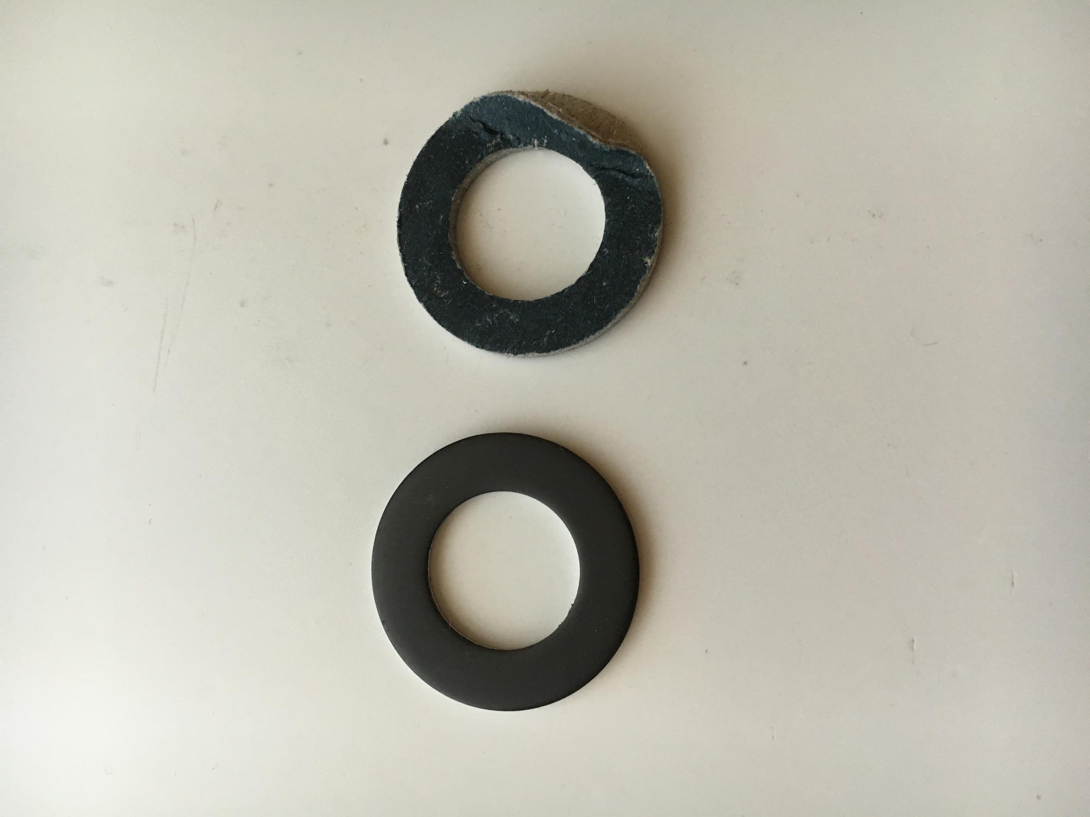

There are fakes being sold on Amazon from some Chinese sellers. These have black paper gaskets glued to poorly made aluminum washers. I re-ordered from an actual Toyota dealer and got the same ones I've been using for years with the rubbery gasket material and correctly sized aluminum washer.

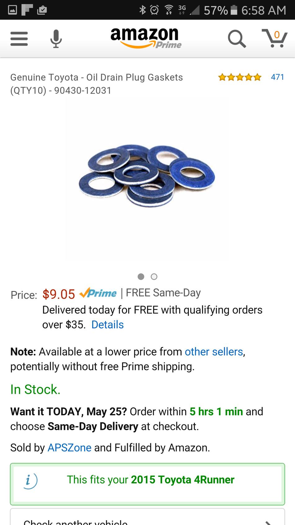

This was the color I was talking about. I used one of these during my last oil change and now the gasket doesn't have a white ring on it.
