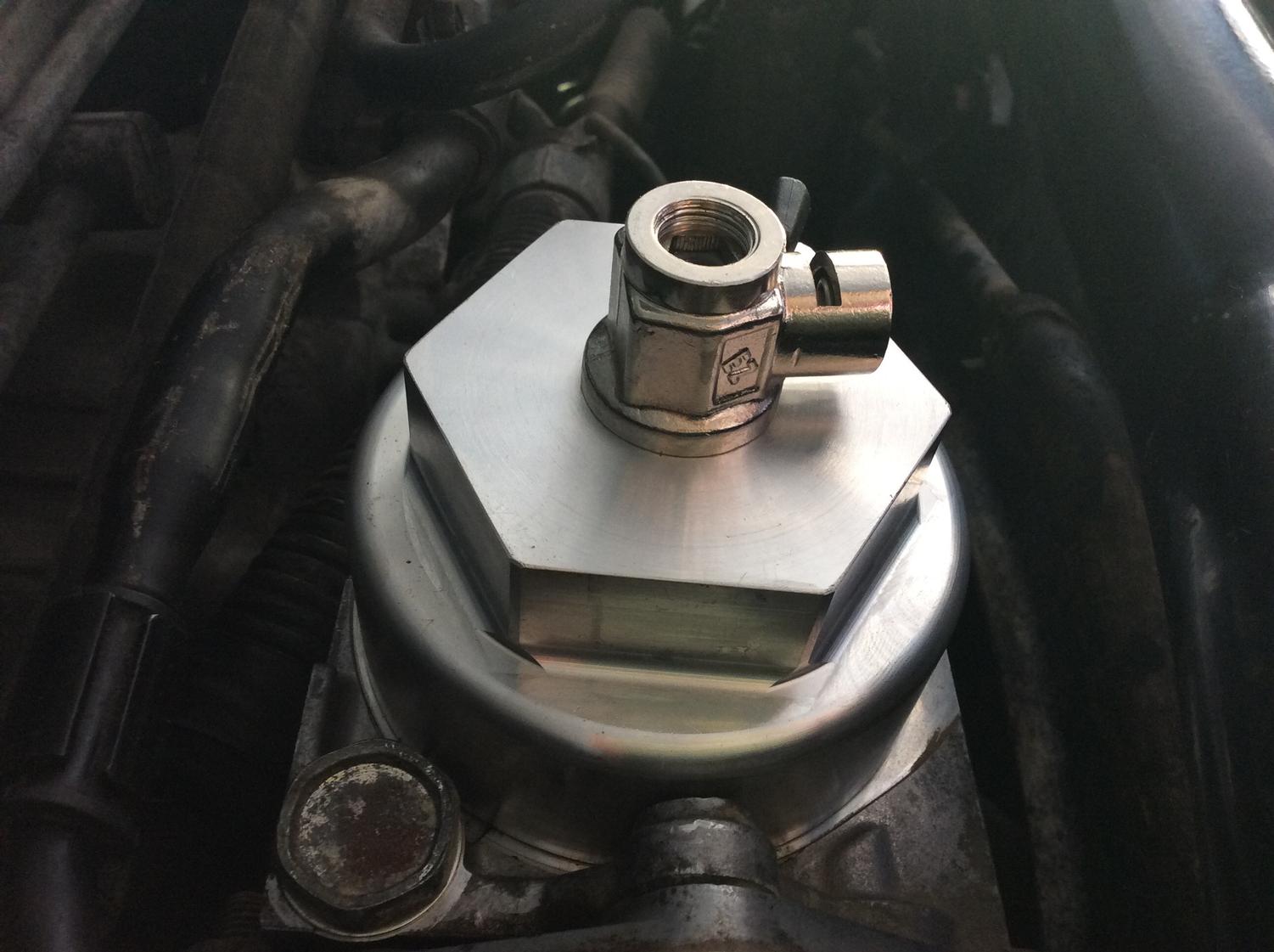

A solution to make things a little easier. The six point socket will never become stuck. Spring valve is eliminated, regular drain plug or Fumoto/EZ Drain valve (rated for 250 psi). There is also a way to run the larger V8 filter.
what is this? who makes it or sells this?
this is in the filter location? so how do you replace the filter?
