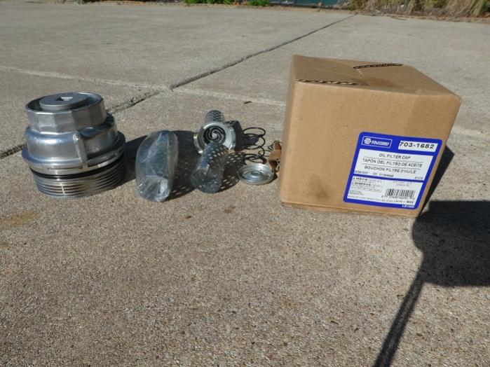

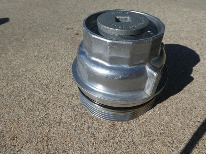

After removing and cleaning up the plastic oil filter housing I removed the longer perforated tube and installed it into a new metal filter housing. New filter, new gaskets, and everything fits well.

Can you post some photos of the Napa part? Curious to see how it compares to the OEM housing.
You can just tell the Toyota one is better quality by the pics. I think the big issue with this one is the threads may be too thin. Who knows, it leaked and was a piss off.

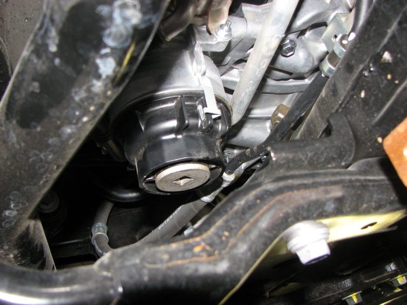

OK oil change people. This was my gift from the dealer this weekend when they gave me a free oil change (1 year at 7k miles) (in addition to getting oil all over my RCI skids):
Note the tab is past the line on the metal casing.
Is that the kind of thing that's going to make it really hard to get off in a year when its time for the next one, or not too bad?

Just did my 1st oil change last night, I went with Amsoil 0w20 also. I was surprised how much tiny metal shavings were in the bottom of the housing. Only has 2300 miles on it but still interesting to see. I lubed up the new gasket Very well but as I tightened it up it seemed to get very dry; anyone else notice this?

Just did my first change last night and that’s Exactly where my metal tab ended up. And from factory it was in about the same location.
My tab was lined up exactly at the indicator from the factory. I don't torque my housing, I simply align the tab to the indicator on the last turn and I'm done. The dealership is the last place I'd have my oil changed....just too many horror stories.
Hmmmm... That’s interesting, I went about a quarter inch past the tab on the housing and I had a slight leak. I had to tighten it up about 3/4 to 1’’ inch to get it to stop seeping oil.
Where is everyone’ tab at?
In 2010 mine looked like this from the factory...and that's as far as it goes when I re-install it to correct torque.
You can try backing it off, it's not going to cause a leak with that type of o-ring seal.

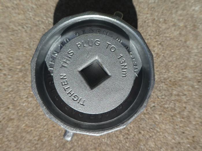

Torque mine to 18lbs every time and never had an issue. My tab goes at least an inch past the pointer, always has. I torque the small cap at the bottom once the oring is aligned correctly to 10lbs. Never had any issues with leaks. Also, I use a cheap (Pennzoil I think) oil filter wrench without issue. It cost me $9.
