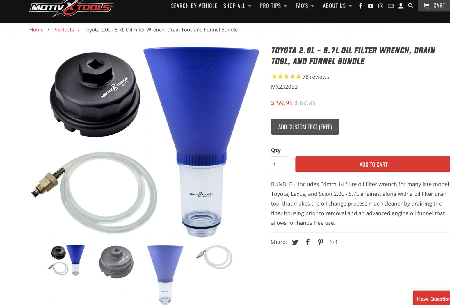

I recently purchased the Motivx oil filter drain tool directly from Motivx. Far less messy than the single-use plastic drain plug that comes in the box with the oil filter.
Oil Filter Drain Tool for Toyota, Lexus, Scion 2.0L - 5.7L Engines - Motivx Tools

This kit made changing oil a breeze, not a drop spilled and the filter drain tube is awesome!
