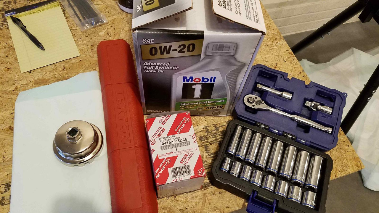

There is a thread in the stickies under mods-write ups - Quick links & FAQ's. Under exterior mods by Antman that tells you everything you need to know: Parts, procedure, etc. Have fun. I'm doing mine today - one of the last warm days for a while.
0W-20 Mobil 1 from Costco (when they do the frequent $10 off deal).
Toyota filter wrench from Autozone (64mm I think).
Tekton torque wrench from Amazon.
04152-YZZA5 filter kit and 90430-12031 drain plug washer from the local dealer parts dept.

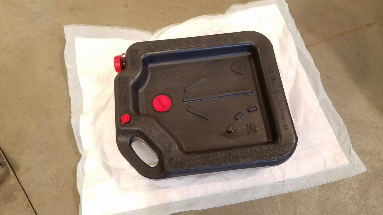

Oil drain tub and some incontinence pads from Walmart. Buy these at the same time so the checkout person knows what the pads are for lol.
Don't forget the Orange Goop!
Autozone sells the filter wrench. And the filter with o rings, and the oil. It's not difficult. Make sure your drain pan is big enough for the used oil.

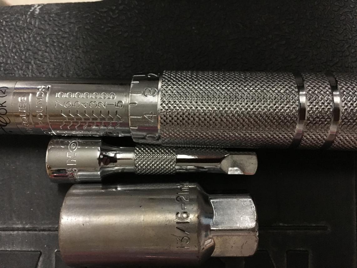

Anyone happen to know if a 21mm Impact Socket would fit to take off the lugs? Impact sockets are thicker than regular so it may not fit in the lug hole?
I have these rims and the stock TRD ones.
Looking to get this: 1/2 in. Drive 21mm Deep Impact Socket and a breaker bar.
Should work fine but it could be a close fit.
On my 2010 Trail wheels I went narrow wall spec, I use this one with my 1/2" breaker bar.
https://www.amazon.com/gp/product/B000NQ4QYC/
Also, a 13/16" 6 pt deep spark plug socket has worked well for me and fits my 3/8" torque wrench. It's actually slightly smaller than 21mm so it's nice and snug (.8125 vs. 0.8268). I've got one that has both measurements inscribed on it.
IIRC I've heard most lug nuts are purposely sized in SAE equivalents: 17, 19, 21, & 23 MM or 11/16, 3/4, 13/16, 7/8.
260010d1500215743-lug-nut-mystery-img_5933-jpg
Also, a 13/16" 6 pt deep spark plug socket has worked well for me and fits my 3/8" torque wrench. It's actually slightly smaller than 21mm so it's nice and snug (.8125 vs. 0.8268)...
That’s good advice. I also use this spark plug socket for torqueing my lug nuts.
I got 1/2" Breaker Bar by ICON 25" long and the 21mm Impact Socket i got fits perfect.
Ill throw a 13/16" 6 pt deep spark plug socket in my tool bag for the truck too.
