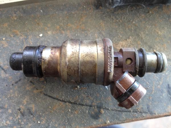

Well wish I had better news (for me anyway...) Looks like the injectors are in pretty bad shape. Dirty as hell and the caps are crumbling when you touch them, so I ordered a rebuild kit, should be here in a few days...

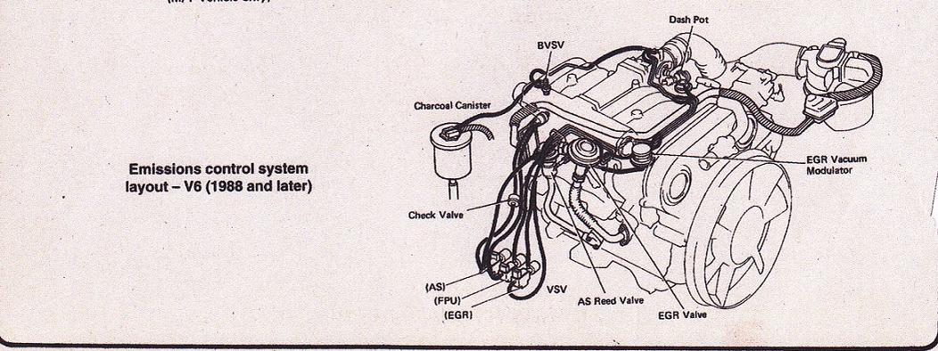

Also noticed that this sensor (The blue one in this picture) does not have any connections to it, know that is NOT right, but I don't know what it is for? Also can't seem to find what should have been connected. Looks like it was vacumme lines, but not sure what was connected to it and where they went??? Any thoughts please let me know...
Hey SkullD, the blue "thingy" is called the BVSV, or bi-metal vacuum switching valve. It is part of your EVAP system (although it's also listed under the spark control system in my book), and connects to the charcoal canister on one side, and to the lines above the throttle body on the other. I've included a diagram. Hope this helps!
p.s. @#$%@#$% computers! Well, I'm TRYING to get you that image, but I can't get the stupid computer to "find" it (even though I'm looking right at it!) so I can downsize it in my "paint" program. Basically, the top of the two fittings leads to the small fitting on the canister, while the bottom one leads to the vac. fitting above the throttle body that aims most towards the firewall. Will send pic if I can ever get the dumb machine to cooperate.
I think I've got it--hope it's not too small to be of use. At least it should help you figure out the routing.

Thank you very much, that helps a bunch... Any idea what it did? Want to know if that was part of the issue I am having. Funny seen that the center hose on the trottle body was missing and pluged with a drill bit and wondered where that went, know I know!!! ;)
I need to find a replacement for it as both of the nozzles are broken. Now I am waiting for the kit to rebuild the fuel injectors. Not sure if it comes with instructions, but I will need to know how to get them apart. Not sure as they don't seem to come apart easy (I think that may be a good thing too).

My pleasure, SD! The BVSV controls the flow of fuel vapors from the charcoal canister (that came from the fuel tank) to the intake. It does this by reading the coolant temp. and the amount of vacuum from the throttle body. As for the injectors, you're a braver man than I--I didn't even know these WERE rebuildable by the home mechanic! Most of the info I've ever seen just says to get new or professionally rebuilt ones, so best of luck on that chore. For the record, I believe one or two of the vacuum fittings above the throttle body WILL be plugged when you're done--I'm pretty sure mine has some unused ones. Will check later for sure.
Just a quick note regarding my last post--there IS an unused fitting after all is hooked up, at least on a 5-spd model. There are four fittings close to the throttle body opening, with two towards the front and two to the rear, and all are in use; but, there's a fifth fitting slightly apart from these, pointing to the rear, and on my fully-functioning unaltered truck it is plugged off. It is a proper factory plug, not something cobbled together, so I'm sure it's correct.
Different 4runners with different options and emmissions had various vacuum diagrams.
SD: Your best bet is to look at your vacuum diagram sticker under your hood.

1. The rebuild kit for the injectors. Kit includes all the rubber parts, the Pintle Cap and the filter. All pretty easy to install. The filter is the toughest and I will only replace them if they are real dirty or clogged.

Injector parts came in and they are now rebuilt and installed. I have some hoses to buy, which I will do tomorrow then re-assymble it and start testing again.
I did clean the injectors and they needed it for sure. Not sure how they will do now that they are rebuilt, but they did spray well when I tested them.
