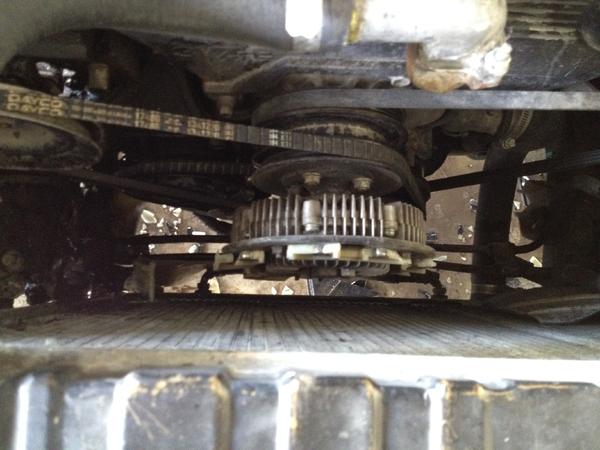

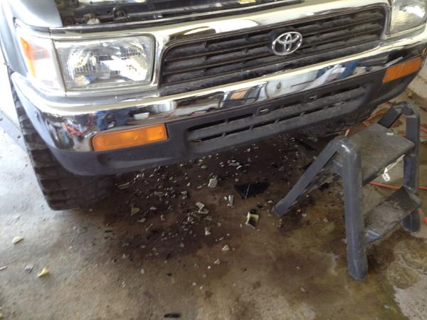

skullduggery-albums-damage++her+%28during+testing..%29-picture9035-hear-you-can-see-fan-shroud-gone-blown-apart.jpg
Here you can see that there is no more fan! It is all over the driveway... See below...
skullduggery-albums-damage++her+%28during+testing..%29-picture9034-plastic-water-everywhere-will-need-more-parts-now-yea-lol.jpg
Plastic Everywhere!
Lucky for you the fan went straight south and away from you! That could have been bad... Guess it's a good time for an electric fan upgrade?
Oh I was lucky alright, but I did get hit and cut in several places...
I got two cuts on top of my head, three on my neck, one on my face and two or three on my arms, and a few sore spots where large chucks hit me...
But I am fine, though a bit sore and some scabs, nothing really to major...
I am very lucky that I was looking down when it went... The radiator and other items were not so lucky...

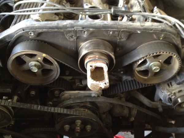

Is one of these gears on backwards? It looks like it is to me...
skullduggery-albums-more+broken+parts...-picture9514-one-these-cam-gears-backwards.jpg

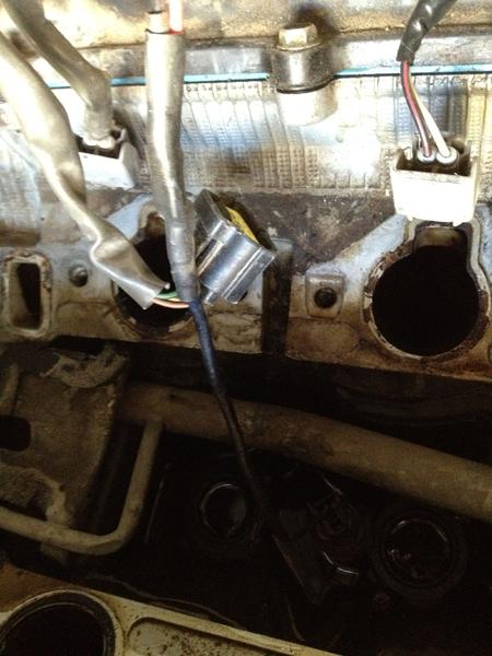

My sensor wire does not have an upper connection. Is this common? I will run to pic a part and see if I can grab one to patch in.
skullduggery-albums-more+broken+parts...-picture9515-my-wire-does-not-have-upper-connector-not-sure-if-patch-but-not-there.jpg

If you have no idea when it was done last, and it's already torn open, you definitely might as well replace the T-belt (and water pump). Tearing it down is what makes the replacement expensive. As for your cam gears, if they both have timing marks showing, then they're on correctly--not even sure if they CAN be reversed, quite frankly (but it's good that you're checking). I believe they look that way to help keep the belt centered, with one lip in and the other facing out--keeps it from walking too much. Best of luck!

I got the connector and have put it on the wires, hope it works. I found that when I was taking it apart that the red wire was not in the connector, it was loose. So we will see how things go now.
